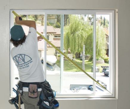

Measurement
Good measurements are the key to a successful window replacement, so I don’t recommend leaving this step to a window salesman. Whoever is measuring the window opening must understand what will remain of the window frame after the old sash or glass is removed, and many salesmen don’t have the necessary experience.
I measure the width of the opening at the top, middle, and bottom, typically from jamb to jamb. I then subtract 1/2 inch from the narrowest of those three measurements to get the required width for the replacement unit.
To find the height, I measure from where the replacement window will rest on the sill to the underside of the head jamb, again at the two sides and in the middle. I take the shortest of those three measurements and subtract another 1/2 inch to determine the height of the replacement unit. If the opening is square (determine this by measuring the diagonals), 1/4 inch of wiggle room on all four sides should be sufficient for the unit to fit into the opening. If the opening is not square, a smaller window — or even reframing — may be required.
If a window opening has been mismeasured and the new window is too big for the opening, don’t be tempted to simply “collapse” the old window to find extra room. Doing that — cutting through the jambs with a reciprocating saw and pulling the frame out of the wall system — will tear the old flashings and dislodge them from the weather-resistive barrier underneath the siding. I’ve seen collapsed-window jobs leak as badly as if the rain were pouring in through an open window, so it’s better to simply order a new window that’s been correctly sized. Most replacement windows are available in increments as small as 1/8 inch.
