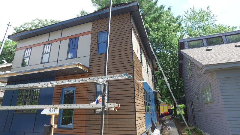

Open-joint cladding systems have been getting a lot of attention from architects, in part because they allow the addition of texture and depth to walls. On a recent project, I had a lot of fun designing the exterior façades, as I was no longer limited to the repetitive pedestrian vernacular of typical cladding materials. Mixing the open-joint system with a panel system, I could play with an almost-Mondrian aesthetic; and the open-joint areas offered a distinct warm and patterned texture. While this may be liberating for designers, it can be intimidating for builders unfamiliar with the system, who often express concern with the performance of open-joint claddings, which stems from a widespread misunderstanding of what claddings are.
Mixing the open-joint system with a panel system, the author created an "almost-Mondrian" aesthetic. In this composition, the open-joint areas offered a distinct warm and patterned texture.

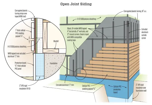

Working from the exterior inward, here are the parts and pieces of my open-joint system:
Cladding. The horizontal cladding boards are TimberTech Azek decking—a four-sided cellular PVC- capped board that is a full 1 inch thick. I used all three available widths—3 1/2-, 5 1/2-, and 7 1/4-inch-wide boards—to create a long, seemingly random pattern on the open-joint areas of the wall. We installed the boards with Cortex screws so the fasteners disappear on the face.
Click to enlarge
I have, in the past, expressed my dislike of vinyl siding from a sustainability perspective (I still don’t like the stuff), but this is different. This cellular PVC cladding is 100% recyclable, requires zero maintenance, and has very low embodied energy. Keep in mind that a deck, which this material was made for, sees substantially more sunlight than any cladding, and has snow and water laying on it for long periods, to say nothing of the impact abuse it is designed to withstand—conditions that these boards simply aren’t going to see on a vertical wall. I have no doubt it will withstand the elements for as long as just about any material available.
Battens. We used Benjamin-Obdyke’s Batten UV corrugated plastic battens. These 3/8-inch-thick by 1 1/2-inch-wide polyethylene battens are black; they are designed to disappear from sight in an open-joint cladding system. I like the corrugated material, which has open cells across the width of the batten that allow for cross ventilation. Polyethylene is impervious to water, so any moisture that might collect on the leading edge of the cladding boards at each batten will simply evaporate; it won’t lead to rot as it will over time with wood. The plastic battens are also very light, so they can be attached to the sheathing with a few staples prior to cladding installation. The fasteners for the cladding, which are driven into the sheathing, hold the battens in place. You don’t need to line up the battens on the studs.
Invisible layer. Along with the battens, we opted for Benjamin-Obdyke’s InvisiWrap UV—a flat-black nonwoven building wrap. We taped off this wrap with Benjamin-Obdyke’s HydroFlash UV+ seam tape and flashed penetrations through the wall with 4- and 6-inch HydroFlash UV+ flexible flashing. These all have an acrylic adhesive, and they are flat black to blend in with the InvisiWrap, essentially disappearing from sight behind the open joints in the cladding.
Backup water-control layer. In this wall system, the primary water-control layer is the fully taped Invisiwrap UV WRB, but we’re designing for the long haul, so we have a backup; the taped WRB facing on Zip R-Sheathing. From a bulk water-control perspective, I have a redundant system —a seat-belt and air-bag approach, as I like to say. This is what gives me confidence in the UV protection. Benjamin-Obdyke provides a 25-year warranty when the whole “UV-stabilized” system (wrap, tape, and battens) is used. While I’m not a fan of warranties, they are helpful to understand what the manufacturer sees as product limits. In this case, the warranty allows for a 2-inch gap and allows one full year of total exposure before cladding is installed. The gap I used on this project is 3/4 inch and the cladding is a full 1 inch thick, and the materials saw less than a month of exposure—all are variables that will affect the longevity in service. I am relatively certain that it will take a very long time for our invisible layer to experience any degree of UV degradation. Even if it were to become brittle after 40 years or so, I know that a tear in that membrane will only expose a pristine Zip System that is itself fully taped and flashed. This wall assembly is not likely to ever see any water infiltration or damage … ever.

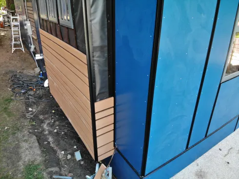

In the open-joint area, the exterior cladding is made of various widths of TimberTech Azek decking installed with Cortex screws and trimmed at the perimeter with XtremeTrim—a powder-coated aluminum extrusion made by Tamlyn. Behind the cladding, the author used Benjamin-Obdyke’s Batten UV and InvisiWrap UV—a flat-black rainscreen system that is designed to disappear behind the open joints.
