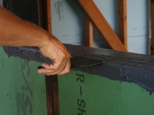

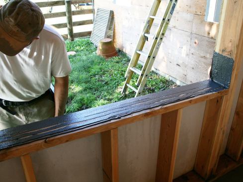

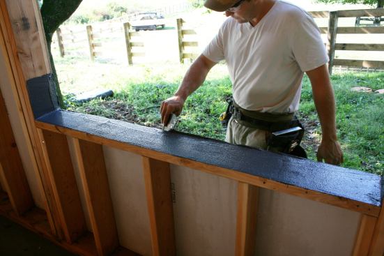

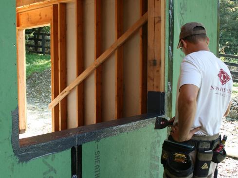

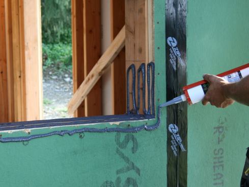

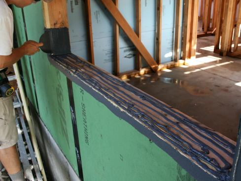

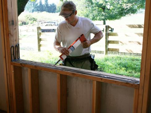

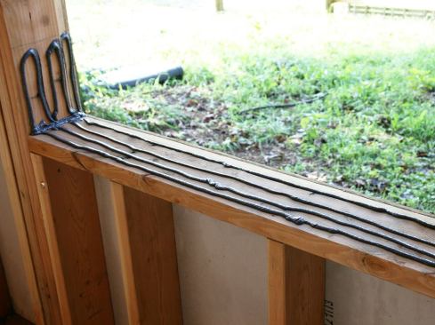

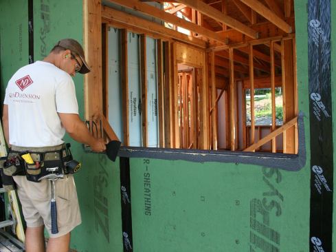

Sill pans. After making sure that the rough sills were free from debris, wood splinters, and other contaminants, we started off by running a thick bead of Liquid Flash at the corner of the rough opening. Next, we applied it in a serpentine pattern a minimum of 6 inches up the jambs, then across the sill in straight, parallel beads, filling in any irregularities by squeezing out a little more product. Last, we ran a bead on the outside face of the sheathing. We then spread the product out evenly using a disposable putty knife, being careful to spread it a minimum of 2 inches onto the face of the sheathing.
Liquid Flash is fairly sticky and has a tendency pull away from itself, so it's important to use enough product for proper coverage, especially at corners. Because it self-levels a little bit, we didn't have to overwork it. You can tell when you've achieved the minimum thickness of 12 to 15 mils: when you can no longer see the substrate underneath.
We used one 29-ounce cartridge to complete the sill pan on this 5-foot–wide window—framed in a 2x6 wall with 1 1/2 inch–thick R-Sheathing panels. Liquid Flash is a moisture-curing product; low temperatures and low relative humidity slow the drying time, while high temperatures and humidity accelerate it. The day we applied Liquid Flash was moderately humid and in the 70s; it took about 45 minutes to skin over and 4 hours to dry.
