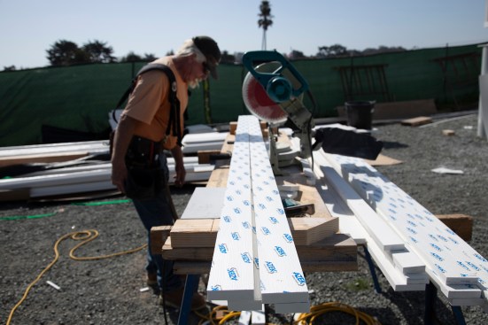

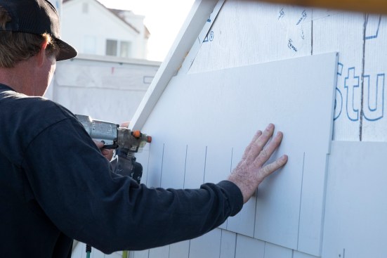

Richenberg and his crew like working with AZEK’s engineered polymer across a variety of products, including soffits, facia, shingle siding, board-and-batten siding, and column wraps. “The guys like AZEK because it’s light and you can work with it just like wood. We’re painting the shingles and siding. Everything else we’re leaving white.”

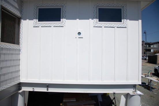

  • Stilt Connections. “There are a lot of connections that are different than a house on a regular foundation. It was a huge advantage ordering AZEK sheets in various thicknesses and widths. We could easily mill it down to create custom pieces.”
  • Porch Columns. “There are pony wall caps – these are 2x10 material and so much more durable with AZEK than wood or any other product. They were not well illustrated on the plans, so had to improvise some column wrap detailing. The AZEK material makes that easy because it’s dimensioned so well. It doesn’t split or crack and seams can be easily glued together.”

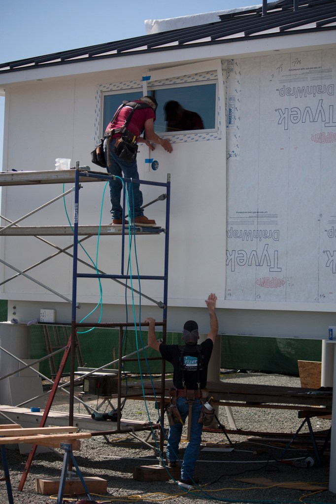

  • Window Frames. “We used a biscuit joiner to give the AZEK window trim really strong corners. We’re using some of the same details for the siding and trim too.”
