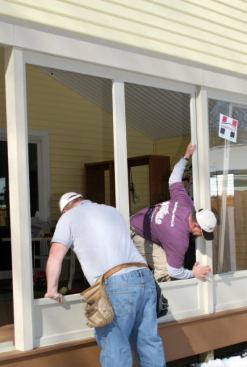

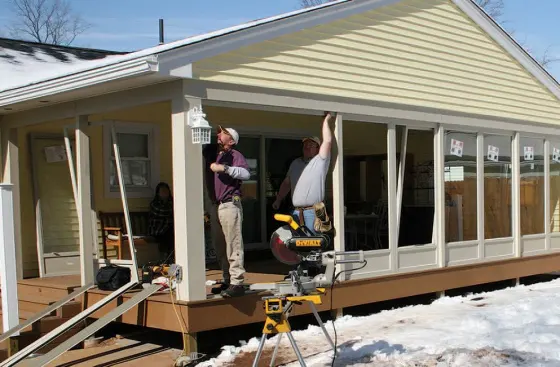

Installing the panels is straightforward. Note that there are typically two panels between each pair of support posts. On the job shown here, my helper and I had already wrapped the wood posts in coil stock.

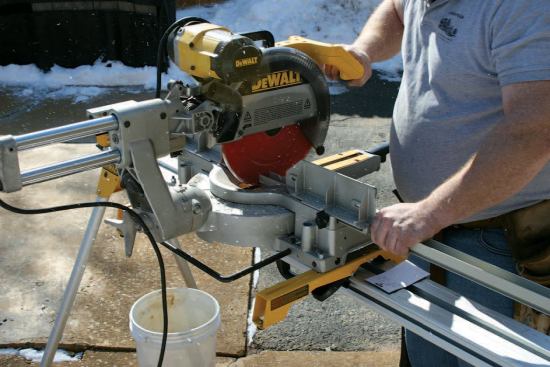

Upper and lower tracks, F-channels for the sides, and H-channels used to join storm-door panels together and to the framing are supplied long. We cut them to length using a chop saw; a standard trim blade works well.

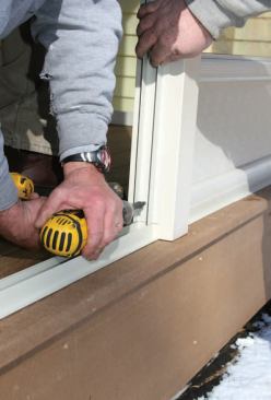

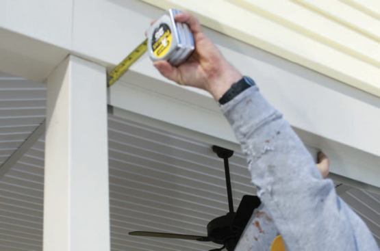

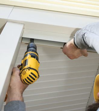

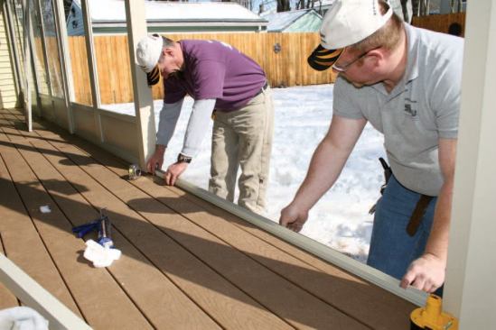

After bedding the base track in caulk, we screw it to the decking, then drill weep holes 3 inches from the ends and 16 inches on-center. After carefully measuring to make sure the panels will be plumb, we attach the top track in the same way. The top track has a deeper profile than the bottom track to allow the door panel to be lifted up and then dropped into place.

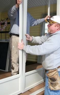

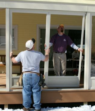

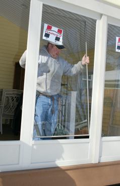

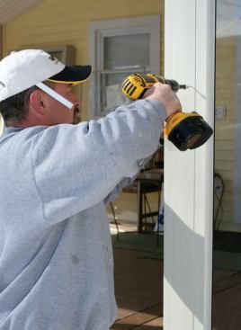

Next I install F-channels along the posts, again checking to make sure that the top and base tracks are perfectly aligned. With the glass or screens removed to lighten the load and reduce the risk of damage, we join each pair of panels with an H-channel that’s cut to fit between the top and bottom tracks. We slide the joined pair of panels up into the deeper top track until they clear the bottom of the opening, then drop the panels into the base track. After adjusting the fit around the perimeter, we screw the panels to the F-channels and the H-channel. Finally, depending on the season, we install the glass or screens in the panels.
