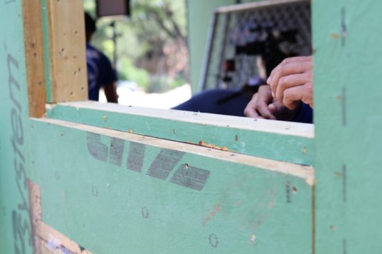

The window sills were framed flat, but I like to bevel the 2x sill by 5% so it has positive slope.

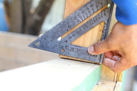

We struck a line on the jamb 2x.
Then we sawzalled out a small chunk so we could add shims below.
Shims make an easy fix to this flat framed sill.
The first step in installing these correctly was to remove the windows and all the flashing that was incorrect. We want to start back at the bare rough opening. This builder was using Huber Zip sheathing that already has a weather-barrier integrated into the sheathing.
You want to assume that any window has the potential for leakage so making a good waterproof sill is a top priority. I also like to slope the 2x sill by about 5% so that drainage is built-in before I apply my flashing. We used a sawzall to cut the jamb then shimmed under the 2×4 sill to give a positive slope.

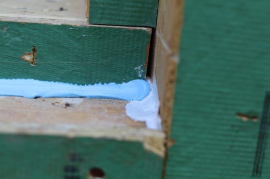

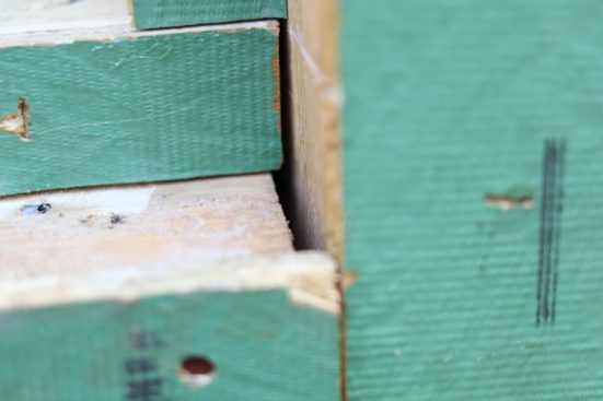

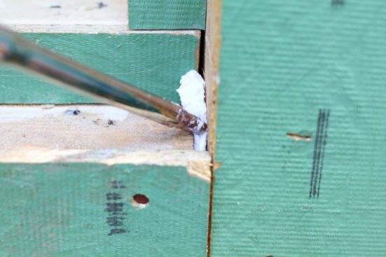

Another option for a fluid applied weather barrier that could be used on the entire house is PolyWall’s Blue Barrier system. This is a two part system and the first step is their PolyWall Blue Barrier Joint Filler 2200. This comes in 20 oz. sausage yubes (you’ll need a special caulking gun for this) and goes on first to fill and gaps/cracks and joints. If you were coating the whole house you would also use this at your sheathing joints as well using it to seal all penetrations in the envelope (hose bibs, ducts, wires, etc). This is a more dense caulking that’s fiber-reinforced and will bridge up to a 1/2-inch gap.
The foam fills the gap and gives the Blue Barrier 2200 a way to span the gap.

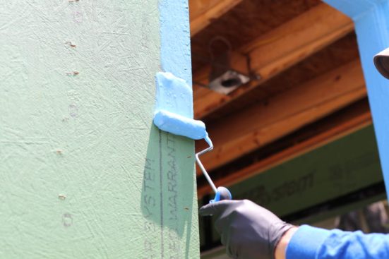

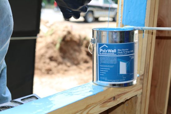

Once you’ve used the Joint Filler you’ll switch to the Blue Barrier 2400 Flash n Wrap. This is a more viscous fluid that can be used as a “housewrap” rolled onto the whole house. In this case we are using it over the Zip wall but again the advantage is that it is foolproof in the install. We coat all the way into the RO, then over the edge of the sheathing by 6” and now we have a waterproof opening.
Blue Barrier Flash N Wrap 2400 is slightly thinner viscosity than the very thick 2400.
Lastly, we will install the window as normal but there is one final step that’s critical. We want to back-caulk the frame of the window to the jamb. This will give us an air-tight window but will also act as a back-stop to keep any water that gets through the frame from not backing up into the window.

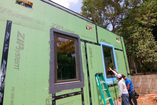

Here is the finished install. The window on the left we used Huber’s Zip Liquid Flash, the blue one on the right uses Poly Wall’s Blue Barrier. As you can see this house has no overhangs and with these recessed windows you need a “Bomber” system to waterpoof. Fluid Applied wins.
You will also use this fluid applied over the window flange on the outside, but only in the upside-down “U” shape. Don’t caulk over the nailing flange at the sill. This will give a spot for any water that leaks into the window to find a path back out.
If you follow this method you’ll have a window that will be leak-free for many decades!
