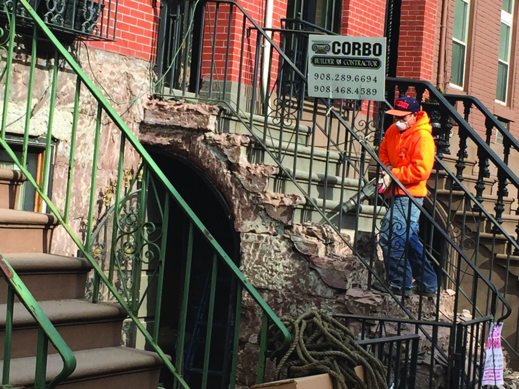

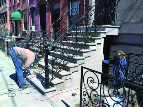

The typical stoop on a brownstone row house was built with an open stringer. Here, a worker begins a repair by chipping off all of its brownstone finish with a rotary hammer.

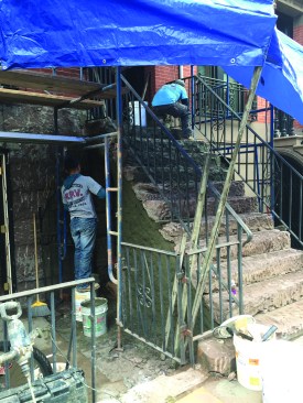

In addition to repairing the stoop, we often rehab a home’s entire façade. We set up scaffolding for any pressure-washing, brick repointing, and painting that needs to be done, and we cover it with netting to protect pedestrians from falling items. The garden-level façade adjacent to the stoop is typically a brownstone veneer with brick above it, and we usually have to tie any entry-stoop repair work into this façade. Along with our project foreman, Danny DoCouto, our masonry sub, Victor Bezama, of FPV Contracting Co., coordinates all this work.

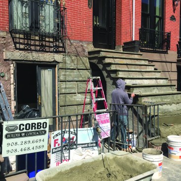

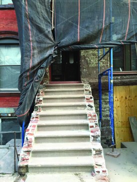

At the start of the job, Bezama’s crew begins by chipping away 1/2 to 3/4 inch of the stoop’s surface down to solid brownstone with rotary hammers (see photo 1). They also chip away the garden-level façade’s veneer; roughing up the surface to promote the bonding of what I call the “restoration” coat.
Modern repair of a brownstone finish relies on three-coat concrete stucco—a more durable material than the traditional sandstone. After the old material is chipped off, reducing the stairs to a rounded but stable substrate, the repair crew builds back the stairs using a “restoration coat” of a fastsetting cement mortar.

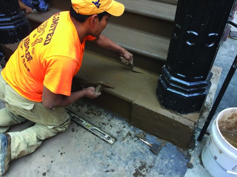

With the chipping complete, the demoed surface gets pressure-washed to remove dust and debris. Bezama’s crew lets the surface dry before using a fast-setting cement-based repair mortar called MasterEmaco N 424 (master-builders-solutions.basf.us) for the restoration coat. They mix this repair mortar with water (it comes as powder in 5-gallon buckets) until it reaches the consistency of damp beach sand—and only as much material as they can install without it prematurely setting up. Working from the top down, they lightly wet the work area to a saturated-surface-dry standard and apply a thin bond coat, consisting of a diluted mix of the repair mortar.
The crew applies the repair mortar in firm, 1/8- to 1-inch lifts to get good compaction, building out the material beyond what’s needed. After a few hours, they “shave” off the semi-dry excess material, a little bit at a time, to the desired profile. The shaved waste falls off like grains of sand and is considered dead material that can’t be re-used.
With little more than trowels and straightedges, the skilled crew sculpts a new set of stairs from a well-compacted build-up of the repair mortar.
I’m always amazed by the skill Bezama’s crew exhibits at this stage—they basically sculpt out the stairs using only trowels and hand levels. They’re able to precisely recreate the stair’s bullnose and scotia molding on each tread, while maintaining riser-height and tread-depth uniformity, and providing a 1/8-inch-per-foot slope on the treads and landing for drainage. On the adjacent façade, they make the linear lines simulating brownstone blockwork with longer, 4-foot levels. The ability to shave the Matrix mortar allows them to create sharp edges on these faux-blockwork lines. When they’ve formed the entry stoop (and adjacent façade), they let it cure, then apply the scratch coat.

For the scratch coat, Bezama’s crew uses a two-part sand, one-part Portland-cement mix, which they apply 3/8 inch thick with notched towels to create a smooth, grooved surface. They let it cure for one to two weeks to harden up, or longer if the schedule allows. It must cure well, as it acts as the only moisture infiltration barrier on the facade.

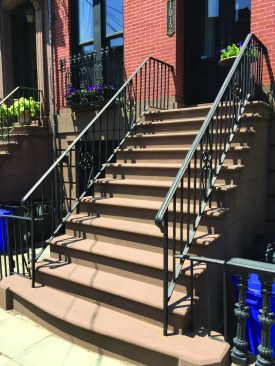

Ironwork
Decorative railings can be a real budget buster; I’ve gotten quotes up to $40,000 for a stoop’s wrought-iron work alone. We try to re-use the existing railings as much as possible, simply removing and storing them during the job, then reinstalling and painting them in place. However, on some jobs, we’ve needed to have them sandblasted, primed, and painted off site.
Ironwork is an important but extremely expensive part of a stoop repair. Usually, the old ironwork is salvaged with wire brushes and new paint, but occasionally the author has a chance to replace it entirely to good effect.
When the budget allows, new railings and guards look awesome. We work with Joe Monga, of Decorative Ironworks, in Paterson, N.J. He has catalogs and pictures of different styles that clients pore over, but we often have to rein them in; newel posts alone can cost $8,000 apiece.
