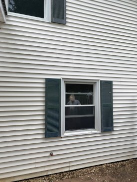

From the exterior, the home appeared to be in good condition…

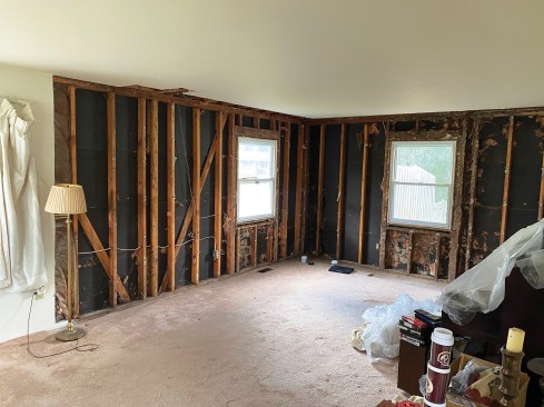

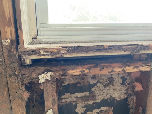

Assessment. When I arrived on site to assess the situation, the room had been cleaned and emptied of most of its furniture. With the framing exposed, I could see that even the vinyl replacement windows were damaged; the destruction of the existing header and wooden window jambs had resulted in increased weight on the frames. All of this had been hidden from view behind the drywall. To the family’s knowledge, damage was confined to framing and structural support members along two exterior living-room walls and near a window in the second-floor bedroom, located directly above the living room.
In a situation like this, we typically will conduct a second, more thorough inspection to determine the extent of damage and to provide a repair cost to the owner. I typically charge a base price for our services that covers our initial time to conduct an investigation and take field measurements. When completed, we provide a detailed line-item cost estimate that includes costs for us to obtain the building permit and other professional fees associated with the repair.
Most of the termite damage to the framing occurred on the ground floor in the living room, and was readily visible after the author removed the drywall and insulation to determine the full extent of the damage.

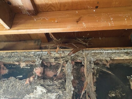

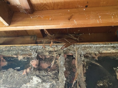

Second field inspection. When we returned to the house to conduct our field inspection, my crew and I removed the remaining drywall from exterior walls both in the living room below and in the bedroom above, exposing a significant amount of damage between the first and second floors. The second-floor rim joist, the double top plates, sill plates, and window headers resembled papier-mâché.
While Steve took field measurements, we spent a couple of hours examining the exposed studs for any additional signs of damage. This included locating mud tunnels that termites use to move from the ground into walls along a slab-on-grade foundation.
In several structurally significant areas, termites had transformed the wood framing into a papier-mâché-like material.

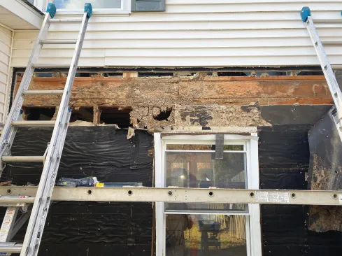

Damage to the double top plates and second-floor rim joist was extensive.

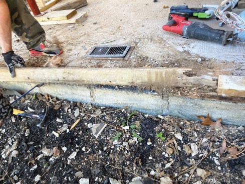

In our area, code requires slab-on-grade foundations to be no less than 6 inches above finish grade. On older homes like this, we often find dirt and—even worse—mulch (we call it termite candy) against the siding, thereby putting the grade above the slab and even with, or slightly above, the wall. This provides a path where termites can construct mud tunnels directly into the wall framing, thereby avoiding sunlight. Here, we found that along the damaged walls, grade measured only between 2 and 4 inches below the top of the slab and even closer to the bottom plate due to an offset in the concrete slab. This condition more than likely contributed to the termite infestation.

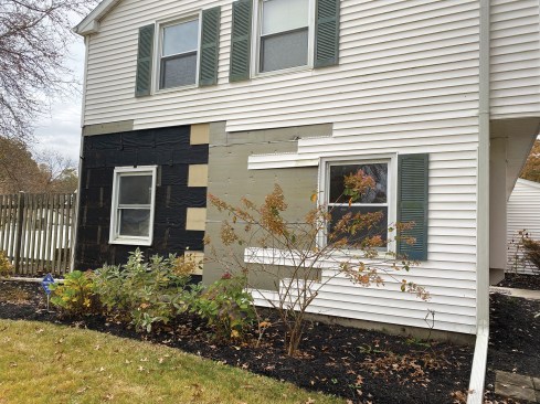

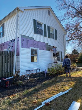

On the exterior, workers carefully removed vinyl siding from the damaged area so it could be reused; the mulched planting bed next to the foundation probably contributed to the termite problem.

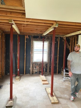

To determine if the damaged sections of the exterior walls caused any deflection in the second-floor structure, we established a laser control line at the top of the double wall plate and extended it from the front of the living room to the farthest corner of the rear wall. This line—which revealed a deflection of the floor joists that ranged between 5/8 inch and 1 inch from the undamaged wall assembly to the damaged sections of wall—would be referenced throughout the remainder of the project for all elevation measurements involving windows, trim, and other fixed objects.

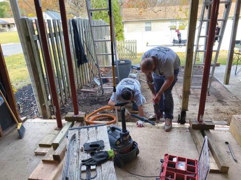

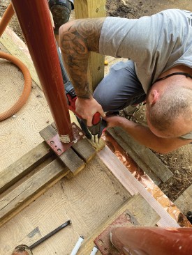

Next, we installed three rows of screw jacks topped horizontally with 4×4 posts long enough to span eight floor joists. The entire area supported was about 140 square feet. Then we applied even pressure to each post, counting the revolutions on each until we removed the deflection over the damaged walls to obtain a positive rise of 1/4 inch. This would give us room to complete the repairs and transfer the weight onto the newly repaired walls. The top of our new wall would be framed to the established laser control line.
Next, we removed the vinyl siding and numbered it for reinstallation, followed by the 1-inch exterior foam insulation board, thereby exposing the original siding panels. That was as far as we could go; we marked only the panels that needed to be removed and called in the asbestos abatement company.

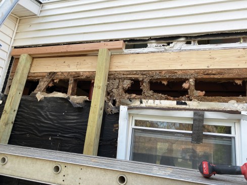

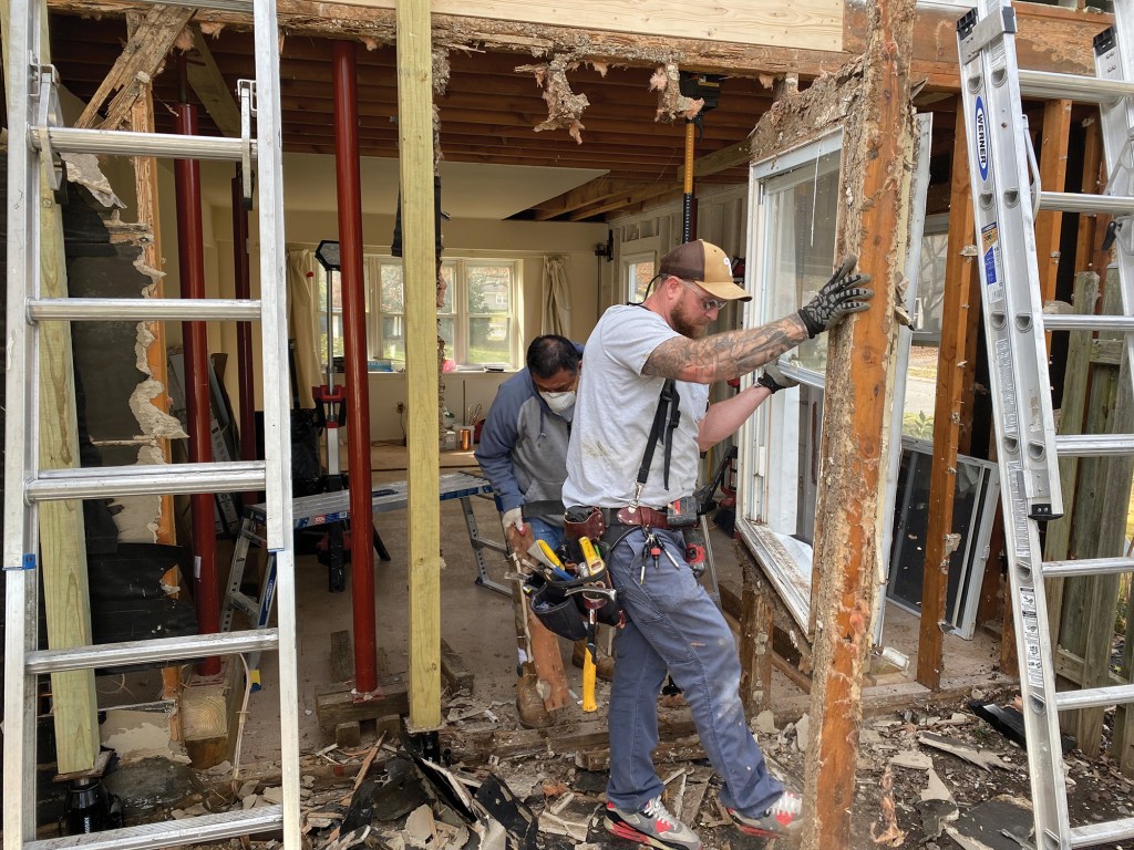

After the abatement crew finished its work and gave us an all clear, we set up hydraulic jacks on the ground with 4×4 posts to take weight off the rim joist located on top of the damaged wall. This was done because that small—yet important—section of wall ran parallel with the floor joists above and was supported only by the damaged rim joist and walls below. To provide a lifting point for the posts, we attached double 2x4s to the exposed studs in the second-floor exterior wall, forming a ledge on the outside of the wall.
Before tackling the damaged wall framing, the crew used screw jacks to raise and then support the second-story floor system, which had sagged almost 3/4 inch.
We needed to take only enough weight off the wall to get the new rim joist in place. However, before the damaged rim joist could be cut and removed in sections, we sistered a new 2×8 with polyurethane glue and #10 Spax structural screws to the inside section of rim joist, making sure to extend the new board at least 4 feet beyond where we planned to make the splice cut, as we did not need to replace the entire length of rim joist on that wall.
After that, we moved outside and cut out the damaged rim joist. This procedure worked well and provided additional support for the second-floor assembly.
With the floor system supported and the framing exposed, the crew focused on repairing the damaged rim joist.
First, workers fastened a doubled 2-by “ledger” to the second-floor studs as a lifting point for 4×4 posts bearing on hydraulic jacks. Then they replaced the rim joist with new 2-by material.

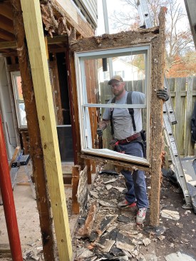

Demo and removal of the studs and wall assembly, as one might imagine, was rather easy; the materials weighed half their normal weight, and the compromised wood severely reduced the holding power of the nails used in the wall construction. The header and window framing along with the sill plate on the back wall sustained the brunt of the damage and could literally be removed by hand.
The rest of the wall framing came apart easily (left), all the way down to the disintegrated plates where the termites had first gained entry (above).

We began our framing work by adding a length of termite barrier to the formed edge of the concrete slab, per Steve’s specifications and local code. We used a product called YorkShield 106 TS, which is a single sheet of 2-ounce copper laminated to a polymer layer with a rubber adhesive, which separates the copper from the preservatives in treated lumber. This was followed by foam sill-plate gasket and a pressure-treated sill plate, which we attached to the slab with concrete wedge anchors every 6 feet. Then we nailed a second plate over the bottom plate.
Before reframing the walls, workers installed a copper termite barrier over the edge of the slab foundation (above). Wedge-type anchor bolts were used to fasten new pressure-treated plates to the slab (right).

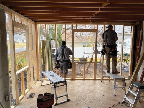

Next, we installed the double 2-by plate at the top of the wall, being sure to line it up with our laser control line. We built the walls in place and cut each stud to fit the opening every 16 inches on-center. Steve called for the installation of Simpson Strong-Tie DTB-TZ tie-back anchors at various locations in the corners and where existing walls met the new wall. These were installed with longer wedge anchor bolts through the sill plate into the concrete slab and secured to the studs with special fasteners. This connection detail was designed to protect against uplift and securely anchored the existing and new walls to the concrete slab.
After the walls were in place, we removed the post jacks, once again slowly transferring the weight onto the walls. A quick check revealed that all the wall plates were now aligned with the laser control line.
Once the walls had been reframed and fitted with the proper hardware to reinforce the connection to the existing framing and foundation, the post jacks were slowly removed.

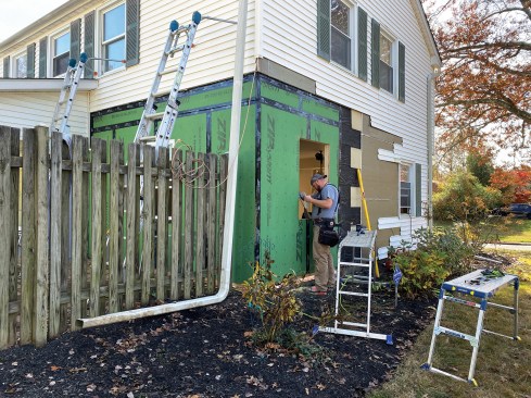

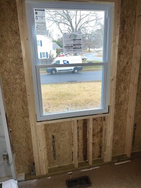

For repairs like this, we like to use Zip System sheathing, because we can quickly install the panels and tape the seams without having to install housewrap. After installing the windows and sealing them to the sheathing with Vycor flashing tape, we ripped some 2-by material to size to picture-frame the windows, then wrapped the trim with white aluminum coil stock, completing the installation with drip caps above the frames. Once installed and trimmed, the new windows were indistinguishable from the others on the house.
The crew installed new Zip System sheathing followed by a layer of 2-inch-thick rigid foam insulation to match the thickness of the existing lap panel siding and existing foam insulation underneath the vinyl siding.
To account for the thickness of the removed 18×24 lap panel asbestos siding (which, as mentioned earlier, could not be reinstalled), we installed 2-inch-thick Owens Corning foam insulation board over the Zip sheathing with aluminum fasteners. This matched up perfectly with the existing foam insulation that was used when the home was sided with vinyl. We cut and installed new J-channel around the new windows and reinstalled the existing siding, using control lines to ensure that the nailing flange on the last row of siding lined up with the bottom of the top row of siding above our repair area.
New windows were installed to replace the damaged units.
The crew picture-framed the new windows with 2-by material wrapped with coil stock to match the existing windows, then reinstalled rigid foam insulation and vinyl siding.

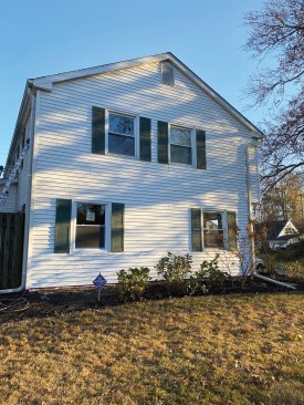

The repaired wall looks like it had never been damaged by termites.
Once we received our close-in approval from the inspector, we hung and finished the drywall, applied a coat of primer, and installed the baseboard and window trim. We then applied finish coats of paint and laid down new carpeting in the living room and bedroom. Six weeks after beginning work, we completed our final inspection.
