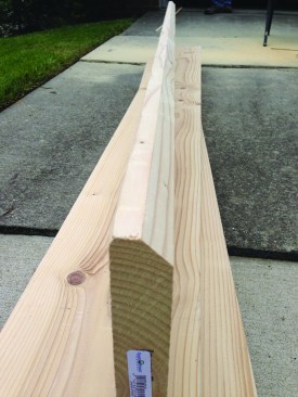

To simplify getting these new joists between the sill plate and the floor, the author first rip-beveled one edge for the length of the joist.

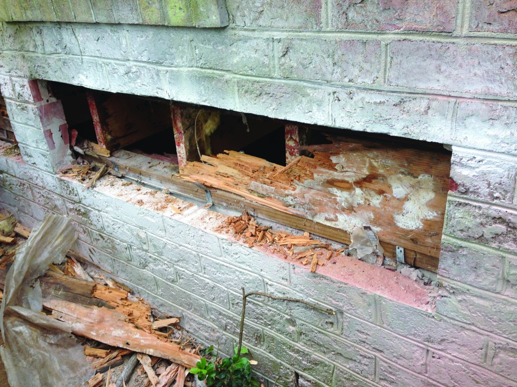

The damage was not readily apparent nor was it easily accessible. The floor above the suspected area was solid and the homeowners never noticed so much as a squeak in the floor or mud tunnels on the exterior wall, a sure sign of subterranean termite activity. I began my inspection by removing obstructions above the sill plate at the top of the poured concrete foundation walls. I checked all along the front exterior wall until I observed the first signs of trouble on the right side of the house. The rim joist in this area was covered with a white powdery substance and evidenced signs of previous moisture damage, but otherwise the wood appeared to be solid—until I pressed on it with my finger.
The rim joist completely crumpled, the surface being paper thin while the rest of the material had been hollowed out by termites. It was bad. I estimated that approximately 10 feet of rim joist and as many as five floor-joist ends had been completely destroyed. To make matters worse, this area was near the home’s 200-amp panel box and all of the wiring to the home ran through the damaged floor joists. I took copious notes and pictures and went back to the office to come up with a game plan.

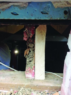

He then applied construction adhesive to the old joists.

After threading the new joists past the temporary support and into position, he rolled the new joists into place against the old ones.

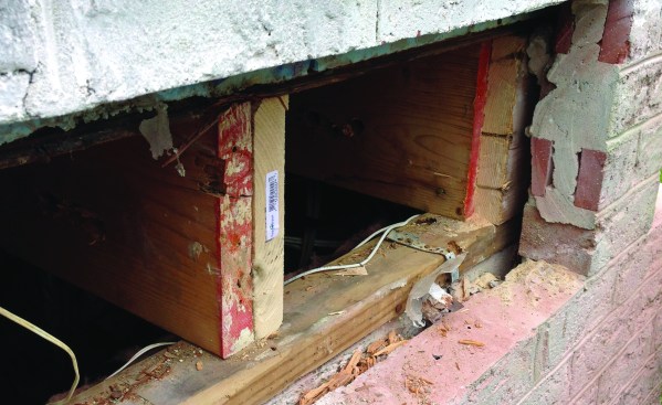

Upon receiving the homeowner’s approval to complete the work, Nicholson and his crew started first. They cut out a section of brick with a gas-powered concrete saw and a small rotary demo hammer with the precision of surgeons. With the brick out of the way, we were able to confirm that the damage to the rim joist was extensive.
The mason had to remove four courses of brick to expose the entire rim joist, which was cut back until only undamaged wood was exposed.

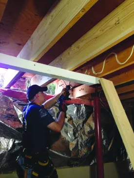

The following day, we arrived along with two electricians from Professional Electric, a local electrical contractor with whom I work. While they labeled and removed all the wiring from the floor joists, we installed a post and Lally columns under the suspect floor joists for support.

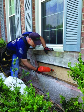

With all the new sister-joists in place, the author nailed on a new rim joist.

After removing the damaged rim joist, we cut our new floor joists so they could be sistered to the existing ones. Given the tight quarters and the fact that the new joists had to rest on top of the sill plate, we cut the inside edge off of each joist. This simple step permitted us to set the new joists on the sill plate and simply roll them into place with minimal prodding from a hammer. Prior to installation, we applied construction adhesive followed by clamps to insure a good marriage between old and new work, and then nailed the two joists together in a staggered nailing pattern.

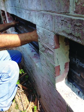

Before the finish brick was replaced, the author applied a flashing membrane to the new rim joist.
After the floor joists were in place, we had a solid surface on which to install the new rim joist. This was accomplished by maneuvering two 6-foot sections of 2×8 into place behind the brick support pier. The rim joist was nailed in place with four nails at each floor joist. The splice in the rim joists was secured with a Simpson plate connector and screws for added strength.
Then he tucked it up behind the existing weather-resistive barrier that covered the sheathing behind the brick.

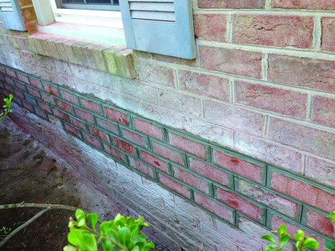

Following that, the electricians returned and began to re-install all of the wiring runs that had been removed. While they worked on that, we covered the entire rim joist with Grace Vycor. Nicholson and his crew returned the following day and completed the brickwork, and after an acid wash a week later, the job was completed. All of the interested parties, including the inspector, were pleased with the final product, and the sale of the home continued without further delay.
