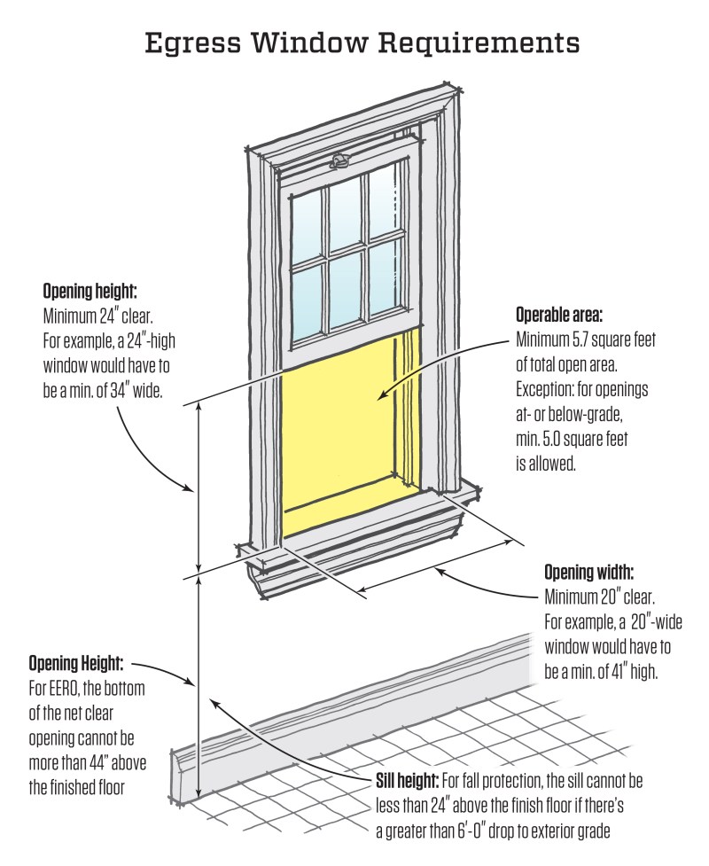

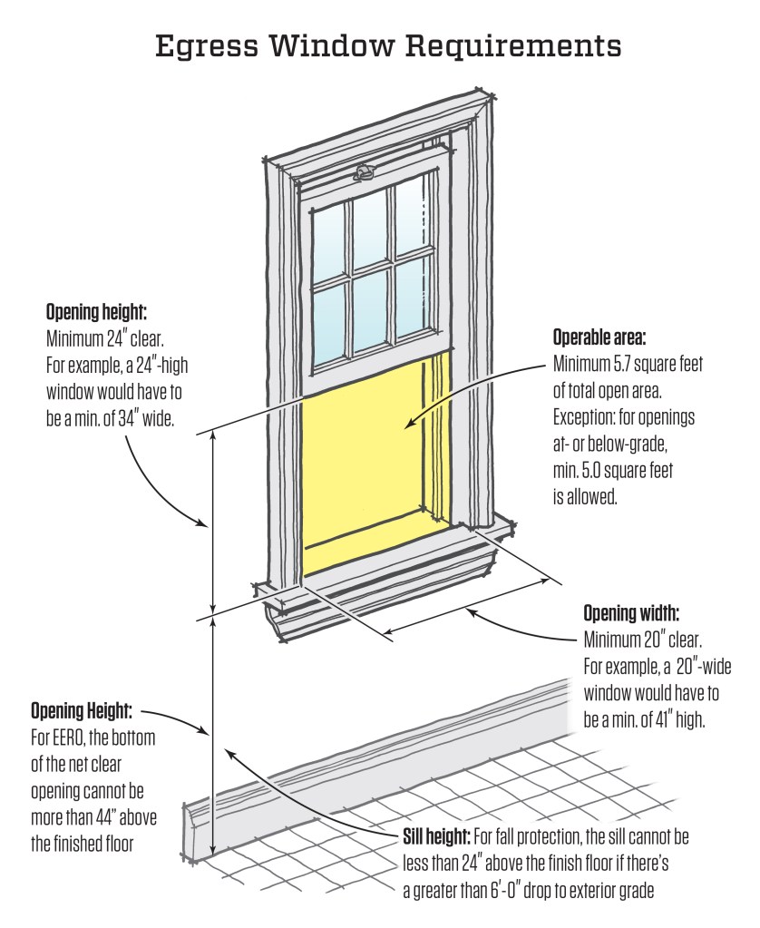

Emergency Escape and Rescue Openings
Provisions for emergency escape and rescue openings (EERO) entered as a minimum code standard in the 1960s and have evolved since then. In the latest version (2021 IRC), the bottom of the clear opening of the EERO cannot be more than 44 inches above the finished floor [Ed. note: Earlier versions of the IRC used the term 'sill height' rather than 'clear opening']. In addition, windows must open no less than 20 inches wide or 24 inches high, with no less than 5.7 square feet of total open area (although an exception is made for at-grade or below-grade openings: Total open area must be at least 5 square feet).
It’s important to note that an opening cannot be both the minimum width and the minimum height—and still meet the minimum area requirement. For a replacement window in homes built prior to enactment of these minimum dimensions, many building officials will not allow installations that don’t meet today’s code for an EERO. The only way to install new windows is to completely remodel (enlarge or lower) the opening in the wall. This could mean structural work such as enlarging the header, drywall finish work on the inside, and modification of the exterior siding or perhaps brick—work that can cost more than the windows themselves.
For owners with limited budgets, this means being stuck with their old, inefficient windows. The unfortunate irony (discussed at a recent code hearing) is that older windows may not be operable at all, because they’re damaged or painted shut. In those cases, even a non-compliant new window would be safer than what’s there.

EERO vs. Fall Protection
In contrast to the need to lower the sill height of a window opening for an EERO, sometimes the need is to raise it for fall protection. In an existing home, operable windows that have finished-sill heights less than 24 inches and have more than a 6-foot drop outside are now in violation of the code. This provision is intended to keep children 5 years old and younger from falling out an open window while they are standing on the floor.
In this case, Appendix J offers relief in the form of fall-prevention devices—such as screens or gates that meet ASTM test standard F 2090—placed in front of an opening. The provision also allows control devices that prevent windows from opening more than 4 inches. Approved devices can block the fall of a child under 5, yet can also be removed easily for egress by someone smarter than a 5 year old. They are the only code-compliant methods—that is, short of building a new deck outside the window to reduce the fall height to less than the 6-foot maximum allowed by the IRC for windows (replacement or new) with open sill heights below 24 inches.
