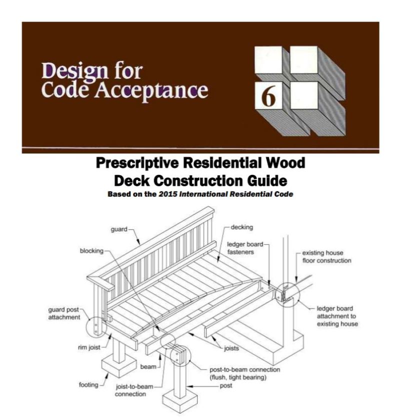

The DCA6
The reference document for safe residential construction is the International Residential Code (IRC), which has been adopted with some modifications by most states and jurisdictions. While the IRC provides comprehensive prescriptive design guidance on the foundation and structural framing of the residence from the walls inward, the available guidance on the design of an attached deck, until the advent of the DCA-6, was very limited. In recognition of this deficit of information, the American Wood Council (AWC), then called the American Forest & Paper Association (AF&PA) adapted a document developed by the Fairfax County, Virginia Dept. of Public Works, which evolved under the AWC into the Design for Code Acceptance 6 (DCA6): Prescriptive Residential Deck Construction Guide. It is available online at awc.org/codes-standards/publications/dca6. The most current edition available, which is based on the 2015 IRC, is 44 pages. The reader’s attention is directed to the bottom of page 1, where the basis of the document is stated—IRC sections are bracketed when they form the basis of a section, while other sections are considered “good practice recommendations.”
While every section of DCA6 is important to deck safety, the purpose of this article is to give background on sections of the DCA6 that may be of special interest to those focused on long-term durability.

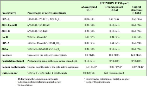

Citing the 2015 IRC R317.1.2, the DCA6 is clear: “All lumber in contact with the ground shall be approved preservative treated wood suitable for ground-contact.” The difference in retention levels between “ground contact” material and “above ground” material is significant, as shown in the table below.
Treatment levels for both the "old" CCA and some of the new preservative chemicals are shown in the table above. Note that required retentions for the "above ground" treatment are substantially less than those required for "ground contact" materials.( From Preservative-Treated Wood and Alternative Products in the Forest Service [PDF] )
To ensure the right treatment level, deck contractors must carefully examine the end tags on the lumber they purchase, making sure that “ground contact” material is being ordered and delivered when required. Once material with the proper retention level is purchased for the job, I recommend that contractors keep a sample of the lumber treatment tags, along with a copy of the PT lumber invoice, as part of the job file. This will help to substantiate the contractor’s due diligence should a construction defect complaint related to the deck ever arise.
Even in “above ground” applications, however, there is a strong argument for using materials suited for ground contact. At this time, the adequacy of the new PT chemicals at above-ground treatment levels is still relatively unknown. CCA lumber was withdrawn from the market in late 2003 but suppliers were allowed to sell off their inventories of CCA-treated lumber. By 2005, the above-ground material came to be readily available for deck construction in the Virginia area and along the eastern seaboard. However, the durability of the new preservatives and lower treatment levels in deck applications is still not fully known, as many of the decks built after this time are still well within their service life. Moreover, there have been some reports of premature failures of above-ground treated lumber reported. Faced with uncertainty on this subject, I would strongly recommend that contractors consider using “ground contact” (minimum UC4A) lumber for all above-ground deck parts.
Solid-sawn deck posts (timbers) embedded in the ground may even require a preservative treatment level that is above UC4A. For additional information on the recommended treatment for timbers in the ground, refer to Table 3 in the Recommended Guideline section of the USDA Forest Service Technical Bulletin on Treated Wood Processes. Also keep in mind that regardless of the PT wood materials selected, decks should be inspected annually for evidence of decay and unsafe conditions.

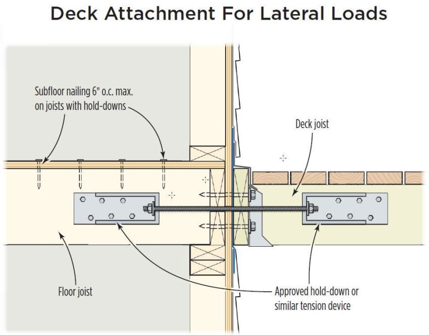

Since the 2012 IRC clarified that decks must resist lateral loads, the DCA6 [page 17] began addressing lateral-load ledger connections, but limits its recommendations to the prescriptive provisions of the IRC R507.2.4, and does not address the greater lateral resistance required in high-wind and seismic zones. The illustration at left shows one example of the type of connection permitted (though not required) to resist lateral loads. At least two hold-down tensions devices of this or an equivalent type are required for all decks. Coastal decks and decks built in seismic zones may require substantially more lateral resistance, as specified by an engineer.

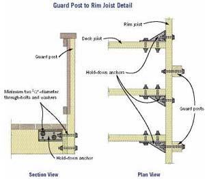

In the vernacular of DCA6 [pages 15-16, 18-19], a deck’s “guard” is the guardrails or handrails surrounding the deck. All deck surfaces greater than 30 inches above grade are required to have a guard. Details for a proper guard can be found in DCA6 Figure 25 and 26. At stake here is the protection of the occupants against severe injuries and fatalities. Falls through decks guards are generally grave, and among problems with decks, only deck ledger failures are reported more frequently in the media.
DCA6 Figure 26 show one rail post construction needed to meet the intent of the IRC code (shown in the illustration “Guard Post to Rim Joist Detail”, below). In all guardrail attachment methods allowed by code, the top of the rail must safely resist a 200-lb. outward force. “Safely” in this case means that a safety factor is applied to a test of a detail to prove that it can work in the field, because tests rely on virgin material and perfect fabrication that doesn’t always exist on site. In an effort to determine what constitutes a safe rail post connection to the end of deck joists, we tested numerous details at Virginia Tech. All lagged and through-bolted connections failed to meet the 500-lb. test load, despite numerous attempts to reinforce the connection with blocking. Only the connection that relied on a metal hold-down anchor, such as the Simpson HD2AHDG (www.strongtie.com/products/connectors/HDA-HD.asp) or DeckLok (www.mtdecklok.com/railpost.htm), passed the test.
As mentioned previously, stainless steel connectors and fasteners are recommended in DCA6 for saltwater shoreline exposure. DeckLok is one source for 304 and 316 stainless steel hold-down anchors that resisted the 500-lb. load used in the Virginia Tech guard post tests.
