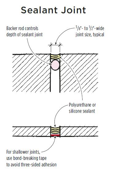

In general, the best joint size for most caulked sealants is between 3/8 inch and 1/2 inch (always refer to the sealant manufacturer’s recommendations for joint designs).
Sealant joints should be designed to avoid three-sided adhesion. A sealant that adheres to three sides of a joint will tear along one of the sides when the two materials move differentially. One common way to avoid three-sided adhesion is to use a bond-breaking tape underneath the joint (see illustration).
Another way is to install a closed-cell foam backer rod before filling the joint with sealant. Available in different diameters, backer rods are useful for controlling the depth of the joint between thicker materials, and therefore the size of the sealant bead.
