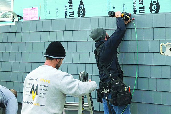

NuCedar Mills was one of the first cellular-PVC sidings to come to market in the mid-2000s. Its specialty (in my opinion) is the replication of shingles. Its shingles come the same way wood shingles do—individually sized in several widths, prefinished, with multiple exposures, and sold with the required accessories to match. The difference is in the upkeep. Because they are cellular PVC with a “heat reflective industrial coating” finish (which is included in their 25-year warranty), they are virtually maintenance-free.

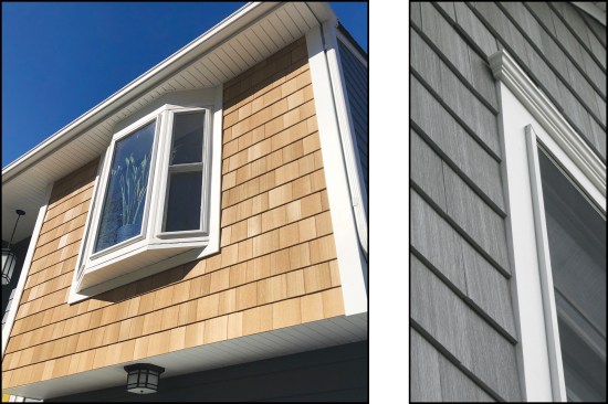

NuCedar shingles (left, right) are so authentic looking, they can fool even the most experienced eye. Note that shingles can be butted against the casing and downboards, eliminating the need for “pocket installation” (J-channel or otherwise).
These shingles are a niche product though, given the cost of manufacturing so many individual pieces and the incredible variegated finish that each one has. But for clients who are looking for more than what a vinyl shake product can provide, without the upkeep required for finished cedar shingles, there is no better alternative.

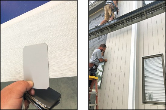

The problem comes in finding color-matched trims—not only coil stock but also utility blocks, attic louver vents, and such (left). NuCedar also offers vertical siding (right). When installing long vertical panels, you need one person up and one down, and they need to communicate constantly to keep the panels aligned.

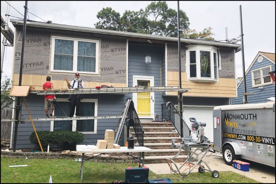

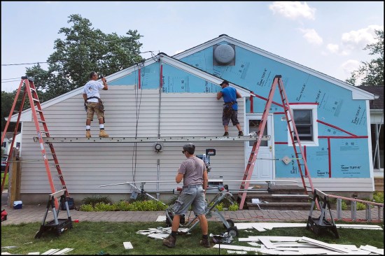

Two things we run up against with all new solid sidings: First, it is imperative to find aluminum trim coil that will match, or nearly match, the finish sidings. Manufacturers that provide color-matched coil stock are one step ahead. NuCedar is not one of these, so we have to work at the beginning of the job to find the best match and set client expectations accordingly.

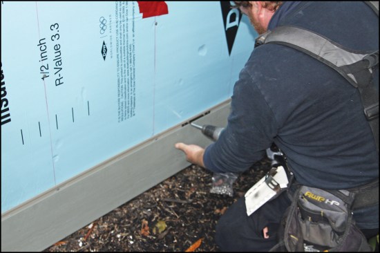

Second, we always focus on water management. Under the siding and foam underlayment, we use aluminum trim coil at all inside and outside corners over the housewrap. We like to use a drainable housewrap with stand-offs or folds to help move the water out and away. This is especially important in our market along the Jersey Shore. (Remember Hurricane Sandy? We remind ourselves of this all the time.)

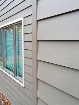

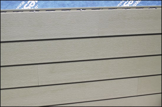

With Royal Building Products Celect siding, seams (butt joints) are shiplapped so each course moves in unison across the length of the wall. Note the double nails in the upper right corner. This is the center of the wall; the double nails “pin” the siding in the middle, so thermal movement happens evenly from the middle out in both directions.
The product is well-thought-out, and the line includes all the required accessories. We did our first job with it in early 2015. From the start, Royal has offered color-matched, heavy-gauge coil stock, as well as a line of color-matched cellular-PVC trim stock, which has been very convenient.
Because of the thermal movement, penetrations such as this vent outlet require a deep-set pocket, which requires a wide trim. From the start, Royal has offered color-matched, heavy-gauge aluminum trim coil for detailed finish work.

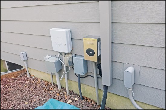

Here, the AC lines are capped with matching coil stock fabricated on site—much better than the usual white leader pipe. Instead of the usual mounting blocks, a plate made from coil stock overlays a narrow block, allowing the siding to move underneath.
We have continued to sell and install Royal Celect to those homeowners who seek the “best.” Installation is slower than with regular vinyl sidings, as all cuts have to be made with power tools. No snips here. And no J-channels to hide the ends. Everything fits in a high-profile trim element or custom-fabricated (out of the matching color aluminum trim coil) receiver piece. At first, all penetrations had to have a “receiver pocket,” which we built following the manufacturer instructions by applying one 1-by-1 1/2-inch furring strip, and then overlaying a 1-by-3 1/2-inch trim piece. This created the 2-inch pocket that Royal calls for. Having spent many years in the seamless-siding world, I became very familiar with the required allowances for expansion and contraction. I also know that those allowances are relative to the size of the panel, or in Celect’s case, joined-together panels. So, we are comfortable with having smaller pieces of siding end in 3/4-inch pockets. Many times this will eliminate an otherwise obtrusive trim.

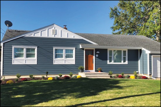

Everlast, combined with cellular-PVC fascia, corner boards, and brickmold casings, creates an authentic, zero-maintenance exterior.

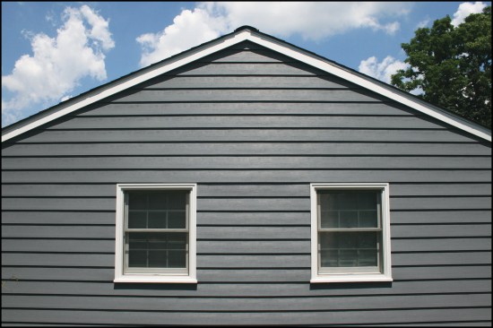

Even with the sun directly overhead, shadow lines appear straight and even; this doesn’t happen with ordinary vinyl.

Seams with Wolf are handled with a splice plate. As with Royal Celect and Chelsea Everlast, which also offer a secure butt finish, this results in stable butt joint. The Wolf system, however, is a little more involved, requiring you to place glue on the plates and apply some pressure to cure. This is only a small nuisance that quickly becomes standard procedure.
The Wolf system requires plates to join panel ends. These require you to apply pressure to help the adhesive cure.

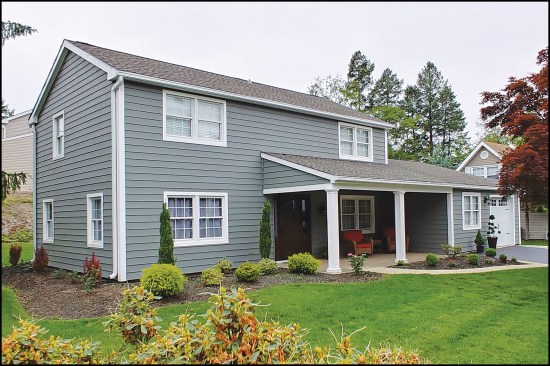

While more expensive, the new composites are making inroads into more and more siding markets because they can all be accented with high-profile trims. This really sets them apart from standard vinyl sidings. No aluminum casings with unsightly J-channels clutter up the look. Solid 4×8-foot PVC sheathing panels can be used for window panels as well as the “board” area of a board-and-batten accent. Flexibility, as well as creativity, is unrestricted by the set sizes of vinyl materials. A specific width and a specific batten size are easily made with solid cellular-PVC material. All you have to remember is to seal any cut edges with acetone, to prevent them from darkening over time. And many types of moldings, even crown molding, are available. Most are available from each of the manufacturers covered here.
The result is an incredibly strong joint. This facade, on which the custom-fabricated gutter leader at right nearly disappears, makes a strong case for matched coil stock.
