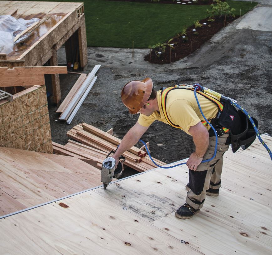

Contractors are required to provide fall protection for any worker six feet or more above a lower level who is not on a ladder or scaffold. This can be accomplished with “conventional” fall protection – guardrails, safety nets and personal fall arrest systems – or with a custom solution engineered for the particular job. If workers are on ladders or scaffolds, other requirements come into effect.
The illustration below highlights items an inspector will look for. The illustration is for reference only and is not meant as legal advice. For official up-to-date requirements check osha.gov or consult with a certified OSHA trainer (see below).
