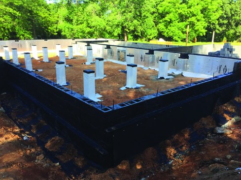

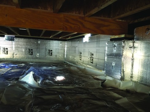

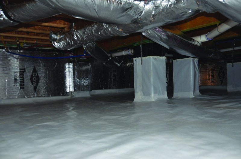

A view of an Addison  Homes “encapsulated”  crawlspace, showing the  company’s current standard  features: a 20-mil poly  ground cover; 1.5-inch foilfaced  insulation on the walls;  and an “inspection strip” at  the top of the block walls to  allow termite inspections.  The masonry-wall top is  coated with waterproofing  to prevent vapor intrusion.

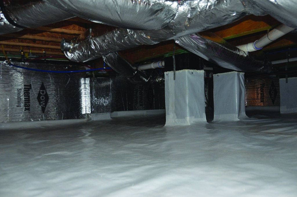

With that opening summary, Yost neatly tied the rest of the lessons together. All of it was interesting. But for builders in the warm, humid Southeast, the most directly relevant portion may have been Todd Usher’s story of the moisture problems his company encountered and overcame after they switched to building sealed (or “encapsulated”) crawlspaces about a decade ago.
Raised floors over crawlspace foundations are typical in Usher’s market, as they are in much of the Southeast and mid-Atlantic and also in parts of the Midwest. Traditionally, those foundations have been vented to the outdoors, with insulation installed as needed in the floor joist systems between the crawlspace and the occupied space above.
It’s a time-honored practice. But common as they are, those traditional crawlspaces are a well-known source of moisture problems. They also waste energy. So starting with the 2003 and 2006 versions of the International Building Code (IBC) and the International Residential Code (IRC), local building officials have allowed unvented, conditioned crawlspaces, which bring the underfloor space, and any equipment or ductwork located there, within the climate-controlled envelope of the home (see “Building a Sealed Crawlspace,” Oct/03, and “Fixing a Wet Crawlspace,” Aug/04).
Seeing the opportunity to save energy while also managing moisture more effectively, Todd Usher, like many other builders, went ahead and made the switch. “The last vented crawlspace that Addison Homes built was nine years ago,” Usher told the audience of builders at IBS. “Everything since then has been encapsulated and conditioned. Essentially, we’re building a mini-basement. We install insulation on the interior of the crawlspace walls, and a 20-mil vapor barrier along the floor of the crawlspace and up the walls behind the insulation.”
The change did save energy. But when it comes to moisture, as Usher learned, sealing up the crawlspace is no simple solution.

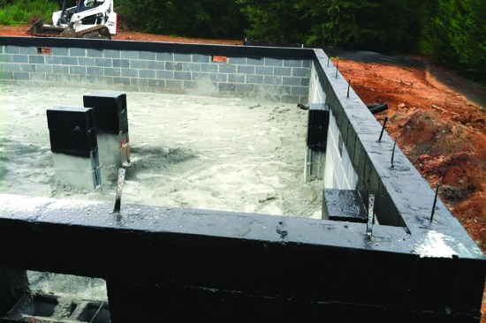

During construction, the waterproofing crew applies a temporary ground cover and applies waterproofing to the wall top and the tops of the interior masonry piers.
The waterproofing provides a capillary break that keeps moisture from escaping out of the foundation into the underfloor air.
Damp surprises. “We aren’t allowed to have power in the house until drywall is hung,” Usher noted, “so we can’t turn on the HVAC and start pulling moisture out of the house until it’s almost finished.” That’s long after the crawlspace is capped by the floor system, trapping any ground moisture into the air beneath the house. “With one of our first sealed crawls, after we framed in the floor, we noticed there was a shower happening underneath the house,” said Usher. “We had to go in and remediate some mildew.”
Lesson learned: After that mishap, the company’s routine has been to install a temporary sacrificial ground cover to keep moisture out before decking over the crawlspace, and to leave temporary vents to the outside open (see photo 4, facing page) to air out the space until the power is on, the HVAC is working, and the space can be conditioned. Once the air conditioner is operating, they seal up the vents and install a clean, permanent ground cover in the space.
“For this temporary purpose, we don’t have to worry about the code-required number of vents,” said Usher. “We just put in as many as we want. And ever since we started doing that, we haven’t had that problem with moisture during construction.”

The walls of the crawlspace shown above have been insulated and waterproofed, and a temporary ground cover is in place.  Temporary foundation wall vents are left open until the house is drywalled, power is turned on, and the HVAC system is  operational so that the space can be conditioned.

Bingo. At the time this house was built, said Usher, Addison Homes was building to the specifications of the EarthCraft green building certification program (earthcraft.org), promulgated by the Southface Energy Institute in Atlanta, Ga. (southface.org). That program called for a capillary break in the foundation. “It wasn’t mandatory, but it was a way to score points,” said Usher. “So we had put a capillary break on top of the foundation wall. We just had our crawlspace-sealing folks leave some of that extra membrane after they installed the wall membrane, and we would drape it over the block wall before we framed the house.”
“Our termite inspection company wants us to leave a 4-inch termite inspection gap at the top of the wall,” said Usher. So the piece of poly installed as a capillary break under the framed sill was left hanging loose, so that it could be lifted up for inspection. Moisture wicking up from the red clay soil, through the footings, and up to the top of the masonry wall was collecting on the under­side of the poly and dripping back down into the crawlspace. “None of it was getting into the framing material,” said Usher. “None of it was making the wood wet. But the foundation was drawing that moisture up from the footer into the crawlspace, and making the humidity in the crawlspace high.”
“So what do we do now?” said Usher. “We looked at putting a capillary break on top of the footing, but there were logistical challenges: How do you put it down? What happens if it rains and there’s mud on the footing? For a while, we had the masons put a capillary break between the courses of block, at about the height of the backfill. But they didn’t like that—they complained that the block wasn’t going to stay together. So then we came up with a simple approach: When the waterproofers spray the outside of the wall, we have them spray the top of the wall too, and one course down on the inside. Our crawlspace-sealing crew brings their poly up to that waterproofing line. We do the same thing on the piers. And we have had no more problems since.”

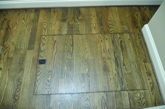

To safeguard the crawlspace’s character as conditioned indoor space, Addison Homes provides access from inside the house with a floor hatch ...

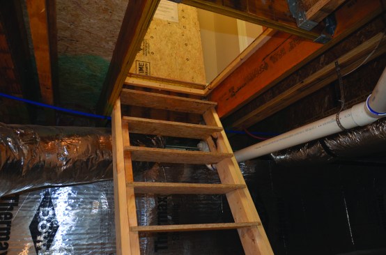

... and a small set of stairs.
Access hatch. Usher doesn’t provide any door from the crawlspace to the outdoors. “If you put the access door on the outside,” Usher explained, “people tend to do dumb things, like stick the lawnmower under there, or the gas cans, or the paint cans. And it’s tough to seal a door for the exterior foundation wall.”
So instead, Addison Homes installs a hatch with a small set of stairs to allow access to the crawlspace from the occupied first floor (see photos, above). “Now folks can really value the space,” said Usher. “It’s clean and dry, and they can store things down there.”
“Our trade contractors love our sealed crawlspaces,” Usher noted. “But we had to train people to take off their shoes before they go into the crawl. If you don’t take your shoes off, you are going to be cleaning the mud off the ground cover.”

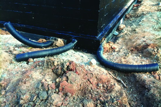

Exterior waterproofing and drainage help defend the space against ground moisture.
