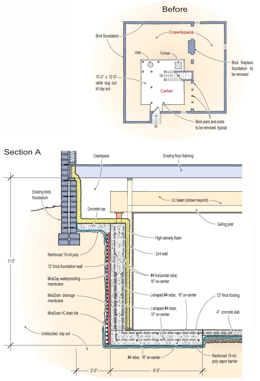

Full-height concrete retaining walls formed within the perimeter of the existing crawlspace stabilize the original brick foundation and help support the floor framing. A bentonite waterproofing membrane, installed before the retaining wall was poured, keeps ground moisture out of the concrete. Drainage is provided by a composite dimpled membrane that channels water into a perimeter drain connected to sump pits in the new egress window wells.

The house was built in the 1930s. Its brick foundation was supported by a double-brick footing set on the clay substrate about a foot below grade. Only a 10-foot-by-12-foot portion of the crawlspace had ever been dug out, to a depth of around 8 feet. The plan was to dig down 11 feet below the bottom of the floor joists to provide plenty of room overhead for upgraded mechanicals. Since excavating the space by machine wasn’t feasible, we would dig by hand.

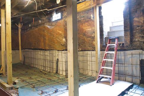

The clay-shale soil was firm enough to allow for nearly vertical dirt walls within 2 feet of the existing brick footing.
For access, we created an opening in the front foundation wall, where the plans called for an egress window and window well. The opening was close to the street, making it a convenient place to back up a dump truck for dirt removal. To ensure that we didn’t undermine the house, our structural engineer, Tom Skywark, advised us to stop the digging 2 feet from the foundation and to approach the excavation and new concrete work in 4-foot-long sections. It turned out, however, that the soil — a clay-shale mix — was much firmer than predicted; in fact, we had to use jackhammers to loosen it. As we chipped away, we had a hunch we could excavate larger sections at a time. A soils engineer confirmed this and gave us the go-ahead to dig out the entire space. Amazingly, we were able to dig vertical walls down to the planned depth without disturbing the soil beneath the footings at all.

Steel reinforcement. The massive footing works in conjunction with the new foundation walls to create a retaining wall that resists overturning and lateral soil pressure. The finish slab locks the footing in place and prevents sliding. The rebar schedule called for a double L-shaped cage made from #4 rebar, with rods extending horizontally from the footing to tie into the slab.
Shown here is the first of two layers of rebar designed to tie the 6-foot-wide footing to the new concrete walls, creating an 8-foot retaining wall inside the basement.

Waterproofing. Although the 80-year-old house had no perimeter footing drain, the basement had stayed dry; as we removed soil, we found no evidence of moisture. Still, we wanted to make absolutely sure that any dampness in the soil couldn’t come in contact with the new concrete foundation walls or the bottom of the slab. Since the sides of the excavation would serve as the outside form for the foundation walls, we lined the dirt with MiraDrain 6200 (Carlisle Coatings & Waterproofing, 888/229-0199, www.carlisle-ccw.com), a dimpled drainage membrane that allows water to move freely through it. At the base of the excavation, we installed MiraDrain HC, a 1-inch-thick by 6-inch-high perimeter drain that collects any water at the base of the foundation wall and directs it to sump baskets located in the egress window wells, where it’s pumped out to grade.
On top of this drainage layer we installed Carlisle’s MiraClay, a waterproofing membrane made with a layer of bentonite clay sandwiched between layers of woven and nonwoven polypropylene fabric. When exposed to water, the clay expands and creates a self-sealing waterproofing barrier for the concrete walls.
Before the walls could be poured, the waterproofing subcontractor installed MiraDrain and MiraClay membranes all the way to the top of the excavation.

Both MiraClay and MiraDrain come in 4-foot-wide rolls, so we needed two courses to extend up the full height of the walls. We pinned the membranes to the dirt walls with nails driven through washers, and capped the walls with 15-mil reinforced poly. We also spread poly on the ground underneath the new footing, cutting in around the temporary shoring posts as necessary.

Foundation walls. The following day we stripped the footings and set the forms for the 1-foot-thick by 8-foot-high walls. Besides restraining the soil under the existing foundation, these walls support the new LVL beams used to carry the floor loads above.

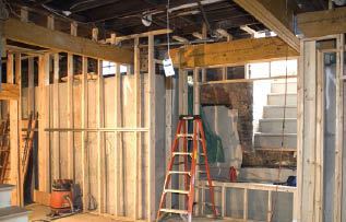

Finished slab. Before pouring the slab, we framed the load-bearing stud walls and finished installing the LVL beams and posts to support the existing floor system. When all the temporary supports were out of the way, we brought in the concrete pumper once again. We took extra care in floating and troweling the slab because it’s also the finished floor. Sealed with a couple of coats of polyurethane, it would be covered with rugs in each of the three main basement living areas.

Once the perimeter 2x4 wall framing was installed and rough-ins completed, we had our insulation sub spray a couple of inches of high-density foam into the cavities. The low-permeance foam completely covers the concrete, laps over the top cap, and extends up the brick foundation wall to the band joist. This effectively seals the narrow space between the old and new foundations.

New stud walls around the perimeter were insulated with high-density polyurethane sprayed directly against the new concrete and existing brick.
