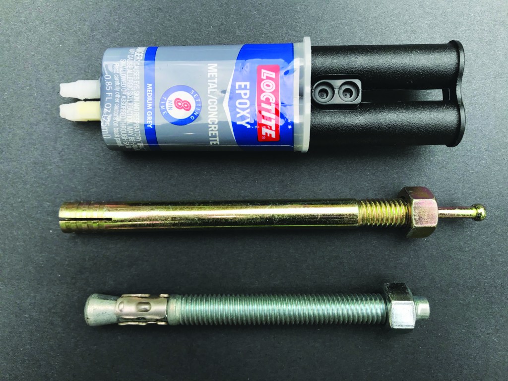

Three anchoring options: Epoxy, hammer-drive anchor, and wedge anchor.

The first anchors I tried were hefty 1/2-inch-by-6-inch wedge anchors—two for each post. Wedge anchors fit into drilled holes, and tightening a nut on one end of the anchor forces a sleeve on the other end to expand against the sides of the hole, securing the bolt—and the post—in place.

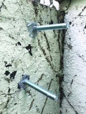

Bolts epoxied into concrete

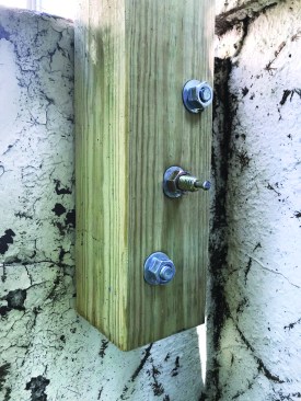

Post attached with epoxied bolts and a hammer-drive anchor
In this case, I discovered that the concrete was not solid enough for the anchors to tighten in the holes. My next option was anchoring the bolts in epoxy made specifically for concrete. I pushed the epoxy into the holes, bedded the bolts in the mix, and left it to set overnight. Epoxy forms a tenacious anchor for the bolts, and it worked for the most part. But I was still not totally satisfied with one of the posts, so I installed an additional hammer-drive anchor. Pounding on the center pin of the anchor causes the other end of the anchor to expand and wedge itself against the sides of the hole. For this project, the hammer-drive anchor solved the problem.
