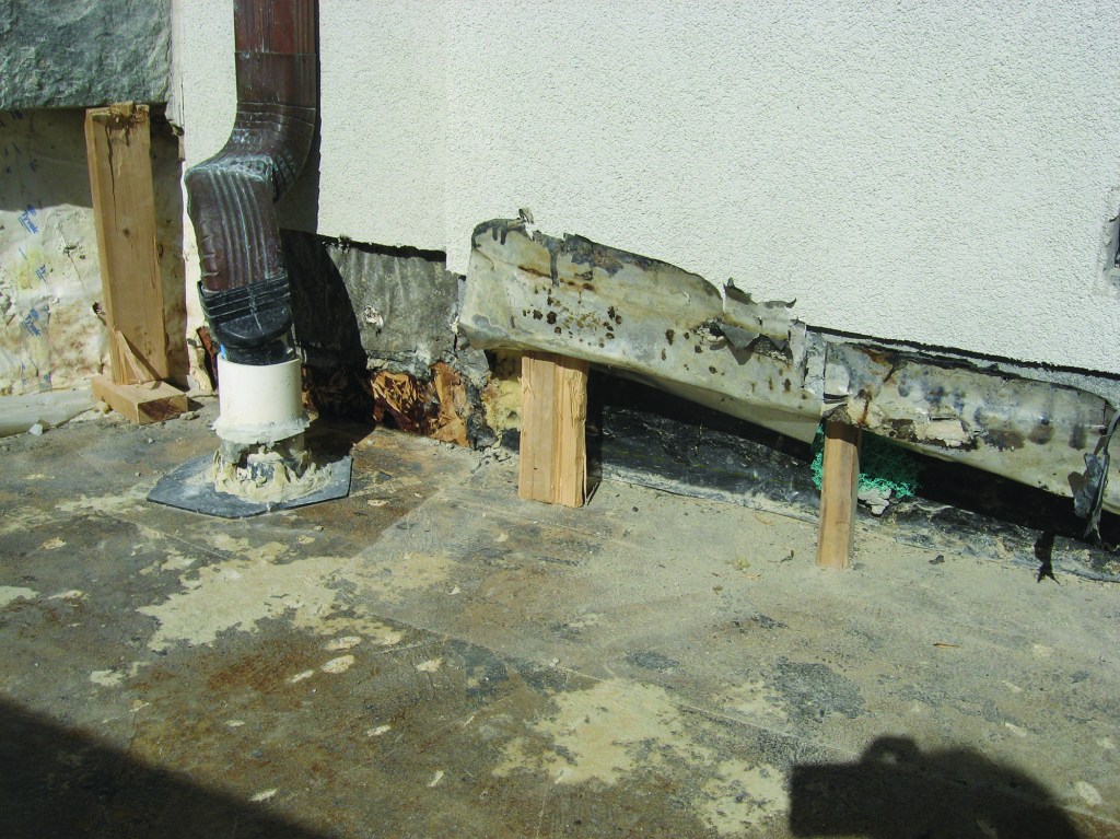

Doug Horgan's photo from “Repairing a Stone Patio Over a Living Space” (Jul/16) shows aluminum flashing that has deteriorated after being in contact with a concrete surface.
Q: Seeing Doug Horgan’s photos of corroded aluminum flashing in “Repairing a Stone Patio Over a Living Space” (Jul/16) left me concerned about using metal flashing with concrete. What is the best type of flashing to use with concrete?
A: Bill Palmer, an engineer and the editor-in-chief of Concrete Construction, a sister publication of JLC, responds: The aluminum flashing shown in Horgan’s article had been in contact with a concrete sub-deck, which caused it to corrode. This corrosion will occur under certain conditions.
First, there has to be some chloride in the concrete. Most concrete does not have chloride in it when placed, unless the chloride is added as an accelerator in cold weather (which is a fairly common practice). As the name implies, an accelerator speeds up the curing process and reduces the risk of frost damage. Calcium chloride is an excellent accelerator, and when used in most residential concrete applications, it does not pose a problem—unless there is aluminum present, either embedded (as in aluminum conduit) or in contact with the concrete surface, as with flashing.
There also has to be some steel (or other dissimilar metal) in the concrete. Most placed concrete in residential construction contains steel in the form of rebar—either for structural reinforcement or for crack prevention. And there has to be some moisture present, as well, to allow the galvanic reaction to proceed between the aluminum and the steel. This reaction causes the aluminum to deteriorate.
As for the basic question of what types of flashing can be used with concrete and masonry, Heckmann Building Products, which makes flashing for masonry construction, recommends against using aluminum as flashing with brick or concrete. If metal is to be used as flashing, stainless and galvanized steel are better choices. Stainless steel is one of the least reactive metals, but it can be difficult to cut and bend, and some of the lower grades of stainless might be more reactive than you would think. Copper is a good option too—but it is expensive.
The truth is that any metal flashing will eventually corrode if left in contact with concrete. Some metals, such as aluminum, corrode much more quickly, especially in an area that will see salt for de-icing in the winter­time. If using heavily galvanized steel, spray any cut surfaces with zinc paint and isolate the flashing with peel-and-stick membrane at joints and corners.
Another metal flashing that is used with concrete and masonry in many parts of the country is lead. Lead flashing is non-reactive for the most part, but it comes with its own intrinsic challenges because of its toxicity. Yet another option is to avoid metal flashing altogether and to use a PVC or rubberized-asphalt product.
Finally, be as careful with products that will be used with masonry, such as brick or block, as you are with concrete. Although mortars are made of different materials, the issues of corrosion are still present, and highly reactive metals such as aluminum should be avoided.
