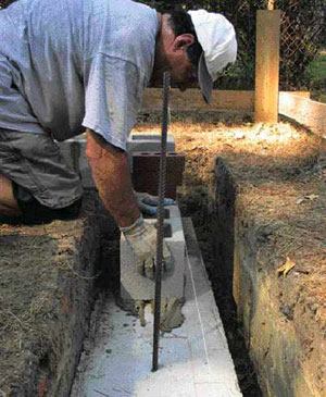

Masonry units can be cut to length when necessary to fit around windows and doors or to build a foundation to precise dimensions (see “Cutting Masonry Units,” left). But cutting them along their length — what carpenters would call ripping — is another matter altogether. To avoid this aggravating job, masons usually begin course layout from the top, establishing a finish elevation and then measuring and marking down, in full courses, from that point.
In the small shop building shown here, for example, the reference point for the foundation was the projected top of the slab, which my client wanted a few inches above grade. Using batter boards, I set a string at this elevation for reference, then dug and poured the reinforced footing so that the top surface of the concrete would end up two full block courses and two full brick courses down from the string.
