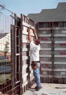

Next we stand and tie 8×10-foot sheets of 6-inch-square welded wire mesh against the up-rods. We start the panels at the building corners and work toward the middle, overlapping sheets by 1 foot. To avoid conflict with the 1-foot-on-center form ties, the worker sets the mesh by propping the sheet on the toe of his boot, lifting it about 2 inches off the slab. This offsets the wire sufficiently from the ties. Because the mesh is square and stiff, it forces the corner up-rods to stand plumb. The plumb corners prevent problems with centering the mesh between the forms. No leveling is needed as long as the same worker positions the mesh (and doesn’t change his boots). Rebar spacers — 5-inch-diameter spoked plastic disks — clip onto the wire mesh in a 4-foot-square pattern to keep it evenly spaced between forms (Figure 3).
Figure 3.Six-inch-square welded wire mesh is centered between forms with the aid of plastic spacers placed on 4-foot centers. Mesh sheets are started at the building corners, and runs overlap 12 inches.
