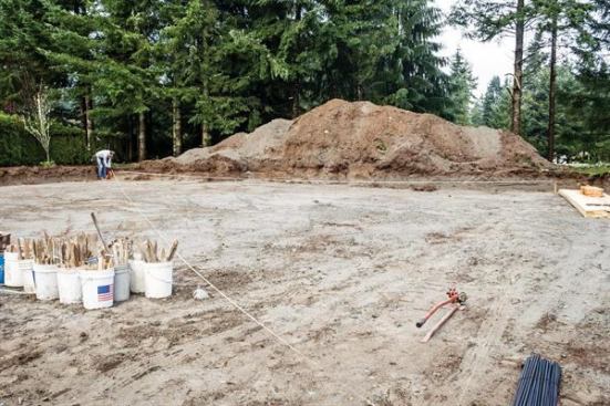

The excavator and I begin each new construction project by meeting on site and staking out the hole. I depend a lot on my excavator’s experience to keep me out of trouble, especially under tricky site and soil conditions. We seldom have to dig very far, since the ground rarely freezes here and our minimum footing depth is only 12 inches.

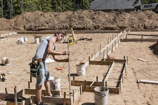

Usually we just follow the terrain using common sense when determining the depth of the excavation. If we are trying to match the elevations of any nearby houses, we’ll take a number off a siding course or some other fixed point with our laser level and use that to establish a benchmark elevation. In most cases, though, we don’t work from a fixed benchmark; instead, we determine wall heights and other elevations from the top of the footing — the vertical rise method.
When the excavator cuts the hole, we make sure it’s large enough to fine-tune the location of the house’s footprint as we’re laying out forms. We stake the property corners and mark the property boundaries with strings, which we leave in place so that the inspector can double-check our setbacks.
