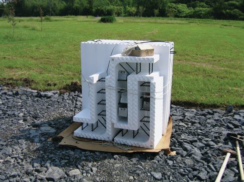

ICFs are made of expanded polystyrene—the same material as foam coffee cups—by several manufacturers that seem to have settled on a standard height of 16 inches and a standard length of 48 inches. Once poured, the ICF forms typically create concrete cores of 6, 8, or 10 inches and have foam wall thicknesses of 2 or 2 1/2 inches, yielding R-22. In addition to straight blocks, corner blocks (45° and 90°), brick ledges, and taper tops are available. Some manufacturers offer knocked-down components that are assembled on site; some offer both knock-down and fixed-dimension varieties. Most manufacturers’ blocks are reversible top and bottom. For example, a corner block can be flipped over to create a left or right corner. Self-aligning nubs keep the blocks in place.

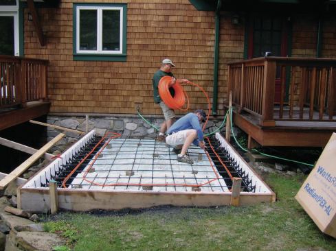

We recently used ICF forms on a challenging job: The homeowners wanted a heated outdoor exercise pool that could be used all year. The twist: It was located in Northern Vermont.

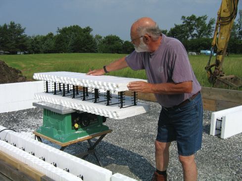

Because parts of the foundation would have to conform to irregular ledge exposed in the excavation, we chose a snap-together ICF form. This allowed us to cut the outer and inner panels separately to fit the contour before we snapped the two panels together with plastic ties.
We cut the inner panels lower to create a turned-down curb around the perimeter. A 1-foot-by-1-foot rebar grid supported the heavy weight of the pool; vertical rebar couldn’t be used because of the ledge below. We installed radiant-heat tubing that was connected to a separate zone on the boiler just before the pour.
The result: Despite the pool’s northern location on the shore of Lake Champlain and the fact that the pool is used during all but the month of February, the homeowners have experienced no recordable year-over-year increase in propane costs for heating—a testament to the high insulation value of the foam forms and the sub-slab insulation.

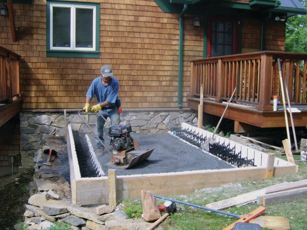

Sloping Site

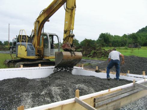

A less challenging job than the pool permitted a straightforward solution, but it required extra work in building the forms to brace the ICFs. The site sloped 15 inches in 24 feet, so we did minimal excavation and laid down 6 inches of mixed stone with some fines before forming up with two courses of 2x12s.

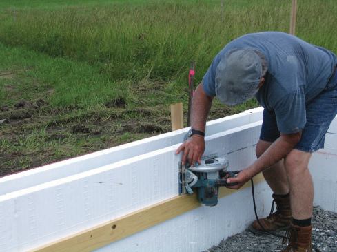

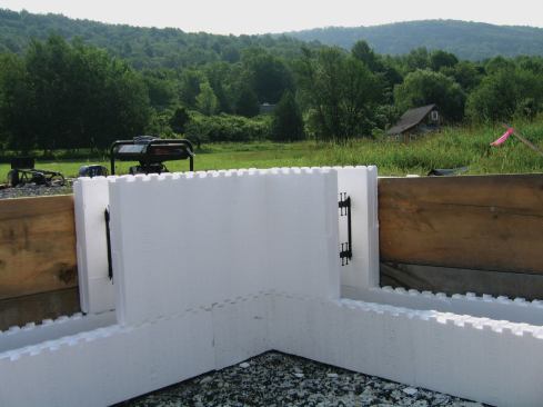

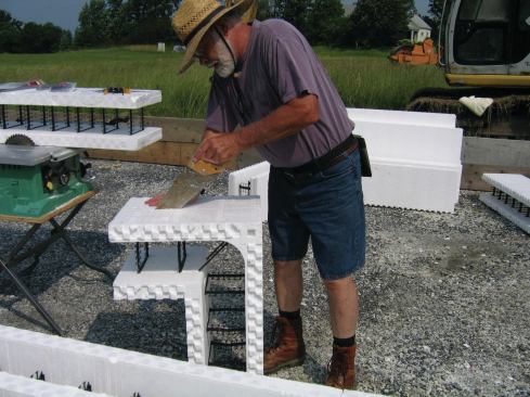

The blocks we used (rewardwalls.com) were 16 inches high and the bottom course was ripped to 8 inches high, yielding—with a full block on top—an overall height of 24 inches. We cut off the nubs on the outside edge of the top course before capping it with 2 1/2-inch lightweight channel to make screeding easier.

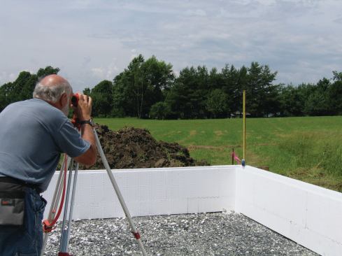

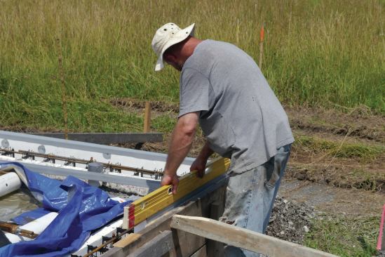

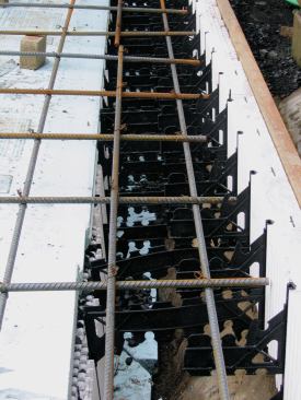

Unlike the forms for the pool slab, these came completely assembled, so I stacked both courses before shooting elevations and cutting away the inside of the form to create a thickened curb. We spaced 36-inch vertical #4 rebar at 4 feet on-center and drove it into the ground; we placed horizontal rebar in the bottom and top courses and snapped it into the plastic walers. Zip ties secured the vertical rebar to the horizontal rebar.

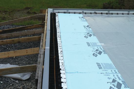

Because the outbuilding that would top the slab would be heated, we placed 2 inches of rigid insulation over compacted mixed stone with fines before pouring the concrete. We laid 10-mil Viper VaporCheck) on top of the foam and taped the seams to control moisture migration into the building.
Before backfilling, we ran a 4-inch perimeter drain around the slab. To meet the minimum 12-inch below-grade cover required for an FPSF in our area, we backfilled against the forms on three sides to within 10 inches of the bottom of the siding, which was enough to provide splash protection from rain. The fourth side would be used for storing garden tractors, so we backfilled against it with crushed rock.
While we were forming up and placing the blocks, heavy rains washed away some of the base material, which made for a challenging situation. Next time we’ll follow our standard procedure of speccing 3/4-inch crushed stone under the forms. Under the slab, the mixed stone with fines worked well, as it created a smoother surface before the rigid insulation was placed. For a house, I might consider pouring a thin footer before laying up the blocks, just thick enough to provide a level base—particularly if the house has a complex footprint. I would insist on a footer if I was uncertain of the excavator’s skill at providing a level, compacted surface.
Be careful with mechanical tamping of the sub-slab fill. If you get too close to the forms, the tamping can force the forms outward, causing unwanted deflection. I recommend using a hand tamper when working within 12 inches of the forms.
On both projects described here, I applied FlexCoat to the forms after the pour and before backfilling. This is a flexible brush-grade acrylic coating that protects the foam from UV degradation. It comes premixed and pre-colored.

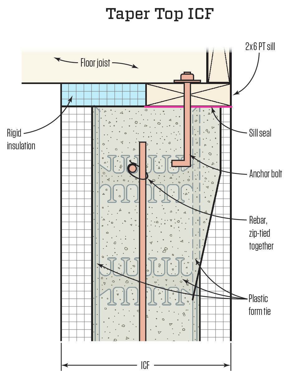

The FPSF and ICF combo can be adapted to crawlspaces. Follow the design parameters for an FPSF and stack the ICFs to a comfortable crawling or working height below the floor system. You’ll need a footer, too.
Tim Healey

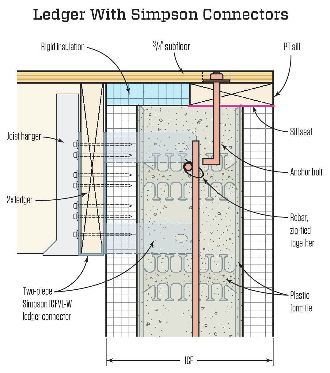

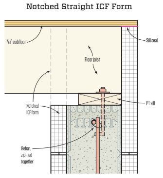

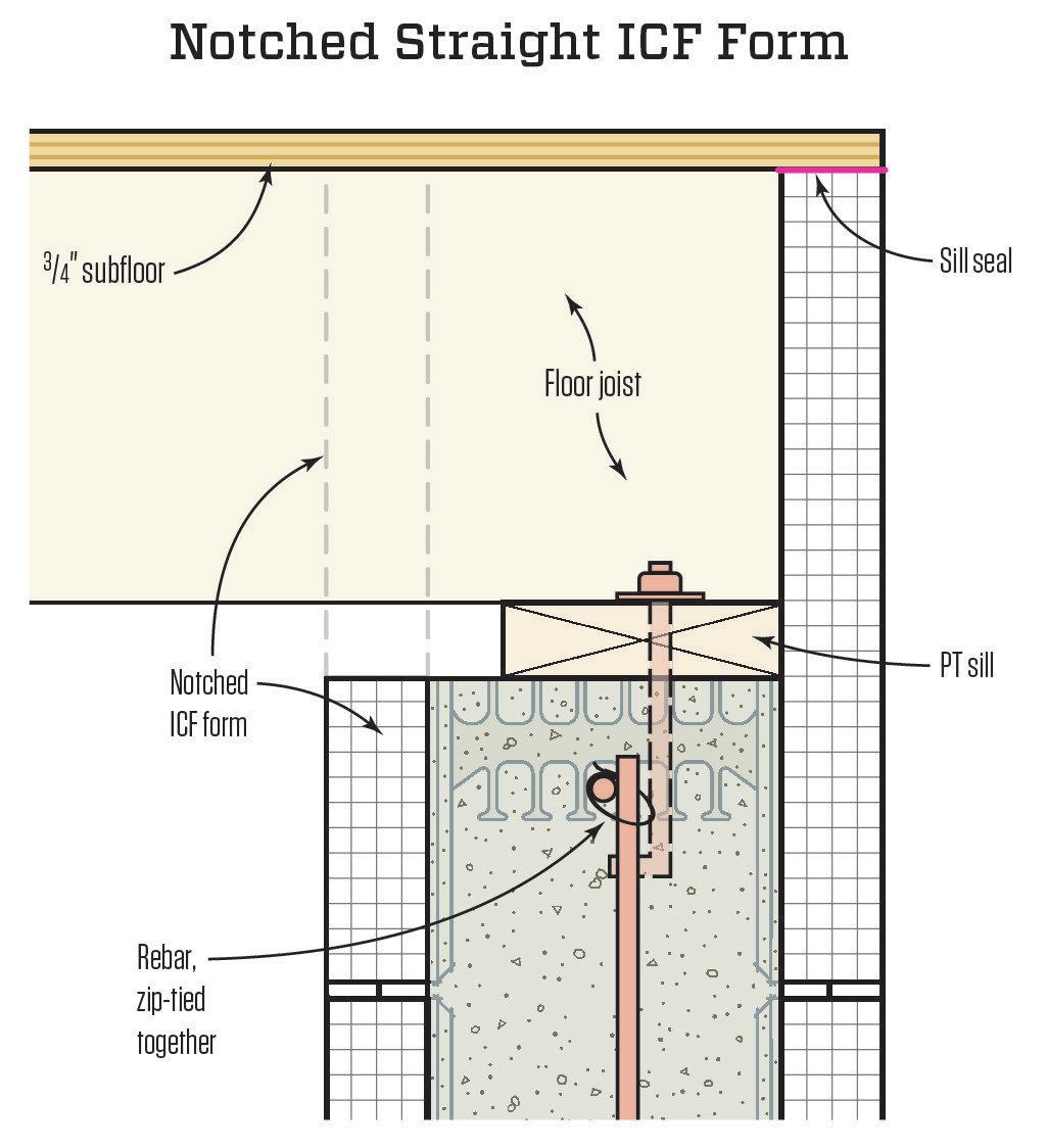

The first-floor deck can be built atop the forms (see Taper Top ICF illustration top left; click here for a larger version), or you can fasten a ledger to the ICFs using Simpson Strong-Tie’s ledger connection system (see illustration below left; click here for a larger version). Or, I typically notch the forms (see illustration, further below at left; click here for a larger version ) and drop the floor system to be partially inside them, running the joists out to cover the concrete core and leaving just the outer wall of foam. This eliminates the difficult-to-seal seam at the concrete-wall-to-wood-framing transition and allows me to visually lower the house on the site. It also results in one less step to get into the house.
