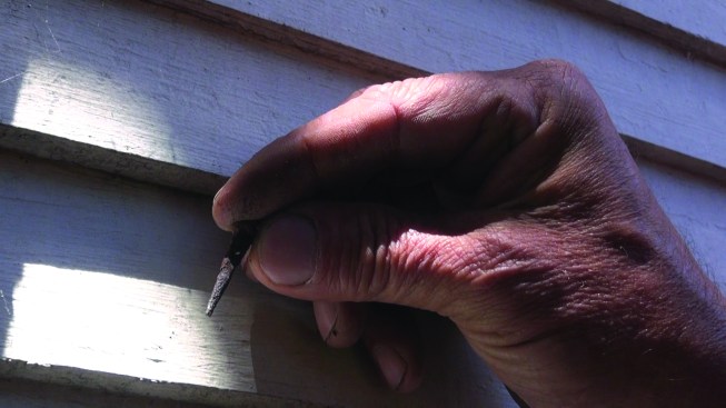

“V Rustic” lap siding is rotted.

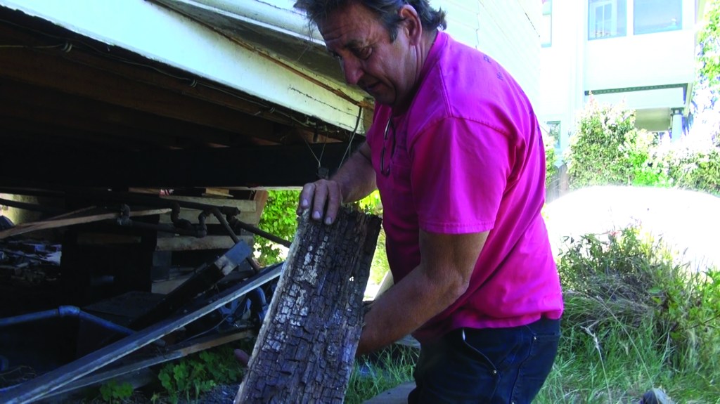

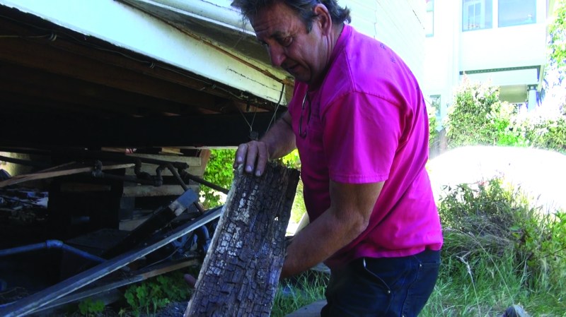

But it doesn’t take an earthquake for some cripple walls to fail. Recently, Joy has been called to lift two houses for which cripple walls had collapsed, seemingly without provocation. In one case, in Oakland, the house was vacant after the owners had passed away; while the family was deciding how to handle the building, it simple toppled off its cripple wall in the middle of the night.
In another case, in Berkeley, the homeowner was at home watching television when he felt the house slip and heard the wrenching noise of gutters and underfloor plumbing giving way. Suddenly, he found himself taking an unplanned elevator ride: In a few seconds, the house shifted over
Nails are corroded.
Nails are corroded.

“Right now it seems like we’re having an epidemic of hundred-year-old buildings falling down,” Joy told JLC in an email. “This is due to flawed underfloor framing. The buildings typically have redwood V-rustic siding on the lower 3 feet. They don’t have plywood sheathing. The V-rustic siding below the floor line doesn’t have much shear capacity to begin with, and the redwood rusts the nails. So when the nails rust, the houses have a tendency to lean over and slowly fall down.”

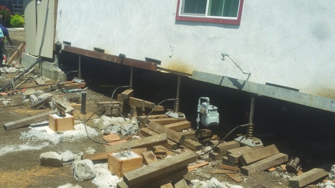

To lift a house after its cripple walls fail, Joy has to lever the building up one side at a time.

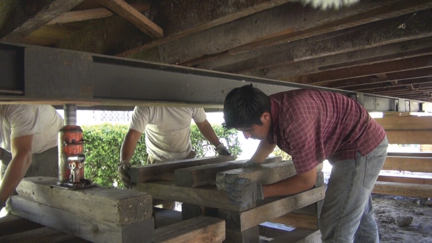

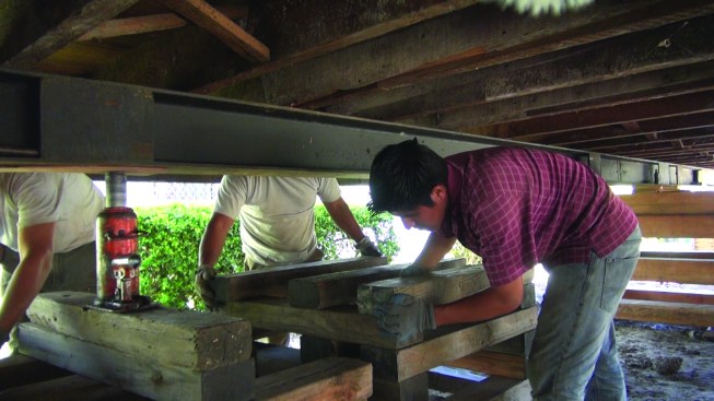

Lifting a house that has fallen off its cripple wall is challenging, Joy told JLC. “There’s no way to get beams under the house, since it’s on the ground. But we developed a process where we put 8-inch angle irons on the side of the building under the floor joist, and rock up one side with our hydraulic step jacks. After we rock up one side, we install a steel beam about 4 feet in from the side of the building.”
Beam location is determined by the floor-joist size and the weight of the building, Joy said (after decades in the industry, he has a feel for how a building will balance). “If the beams are too far in under the building, it will sag on the outside; if the beams are too far out, it will sag in the middle; if the beams are in the right position, everything is perfectly straight.”
When the building is raised and oriented over its footing, he suspends the house on cribbing to allow reconstruction of the foundation and cripple wall.
Once he has one side of the building levered up off the ground, said Joy, “we start the process on the other side: rock the building up, and put in another steel beam. Now that we have two steel beams underneath the building, we hook up to the unified jacking machine and raise it straight up, and then roll it back over the foundation on rollers.”
No two houses fall in the same direction, Joy said, so re-aligning each house with its foundation is an art. Homes often have to be pivoted, which requires the rollers to be placed in a radial fan configuration that lets the house spin as well as move laterally.
