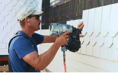

Because fiber cement has such a long life expectancy, I use only stainless-steel ring-shank nails; they offer superior corrosion protection and withdrawal resistance. Collated stainless-steel siding nails — which are typically .090 or .099 inch in diameter — tend to crumple as they're driven into cement board, so I use Hitachi's 2-inch-long-by-.113-inch-diameter nails for siding, and 23/8-inch-by-.131-inch nails for trim. My suppliers special-order these thicker nails; lead times run a week at most.
When a ring-shank nail crumples, I don't even try to pull it out. The holding power of the ring shank combined with the friability of fiber cement almost always results in damaged siding or trim. Instead, with a chisel I nick the shaft of the nail where it enters the siding and bend the nail back and forth until it snaps. Then I hammer in any part of it that's left. If I need to remove a piece of siding that's been nailed, I drive the nails thru the siding with a punch.
