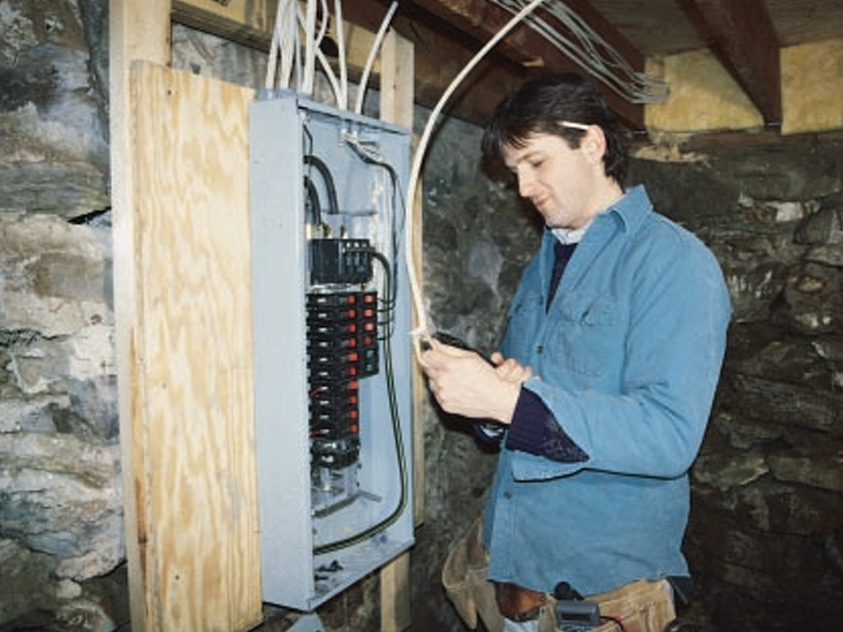

To snake wires from one part of the house to another, I use 1/8-inch-wide metal fish tape. It’s stiff enough that I can shove it through some obstructions (like plaster buildup) and flexible enough to detour around others (such as blocking and cleats). It’s usually easiest to pull the wires through the wall cavity in the same direction that you fed the snake in. Since snakes come in 50- or 100-foot lengths, I often cut them shorter to avoid having to pull all of it up on a shorter pull. I recommend getting the longest snaking jobs done first in case you have to cut the snake shorter for another pull. I store my snakes coiled up, so I have to straighten them before I start work. If the snake is still coiled, it will coil up inside the wall cavity. On each end of the snake I bend a hook approximately 1 inch long and about 1/4 inch across. To attach three-wire Romex to a snake, cut through two of the wires at a 45-degree angle about 5 inches from the end (see Figure 1).
When attaching Romex to a snake for a long pull, the author makes a strong, twisted loop, as shown, and wraps the whole connection in electrical tape.
Bend the third wire through the hook on the end of the snake. Tape everything shut to avoid snagging inside the wall. If a pull is long or there is likely to be a lot of friction to fight, twist the wire around itself a few times before you tape it.
