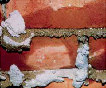

It’s also important to keep mortar droppings to a minimum. Dropped mortar can block weepholes, and can also cause bridging that allows water to travel to the backup wall. Because some bridging across mortar droppings is inevitable (particularly with a small air space), it’s also a good idea to install housewrap or #15 asphalt felt over the sheathing on wood-framed houses to help prevent moisture migration. If housewrap or felt is installed, the BIA recommends that it be lapped at least 8 inches over the through-wall flashing.

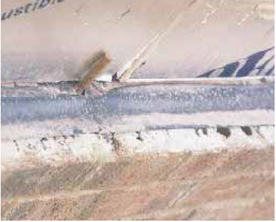

This through-wall flashing is properly tucked under the building paper, so that any water on the backup wall is directed onto the flashing. However, an overlap of at least 8 inches is recommended.

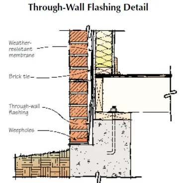

Through-wall flashing needs to be designed and installed to collect the water within the air space, and to allow it to drain to the exterior. Through-wall flashing is not optional; it is required by most codes, and a brick coating is not a viable alternative. The IRC code requires through-wall flashing at the base of a wall, as well as at window and door lintels. It also requires flashing when brick veneer is installed above a roof – for example, where a two-story brick veneer house rises above the roof of an attached one-story garage.

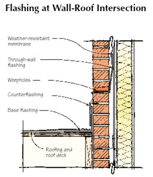

Where a brick veneer wall extends above a roof, through-wall flashing is required above the roof flashing. While the roof flashing prevents water from traveling between the roofing and the brick, the through-wall flashing stops any water that has entered the brickwork from above.

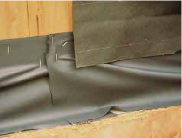

Attach the flashing to the backup wall and install it carefully, so water can’t find a route around it. For instance, if the backup wall behind the air space is concrete block, the flashing should be tucked into a mortar joint in the block wall to prevent water from getting behind the flashing. Where this is not possible, a reglet, pressure bar, continuous nailer, or self-adhesive type of flashing (such as rubberized asphalt) may be attached to the block wall.
When self-adhesive flashing is used in wood-frame construction, it must be attached directly to the sheathing. Don’t make the mistake of installing the flashing on top of the housewrap or building paper. If the housewrap is installed before the brick masonry, it should be detached along the bottom or slit horizontally with a knife, and the flashing tucked under it.
If the flashing is not one of the self-adhering types, and there is no housewrap or felt, then either the flashing must be installed before the sheathing, or the flashing must be attached to the sheathing with a continuous nailer. Both of these alternatives are awkward, however, and they are more likely to create discontinuities, holes, or tears in the flashing.
If the flexible flashing is not one of the self-adhering types, use mastic to seal any overlaps.

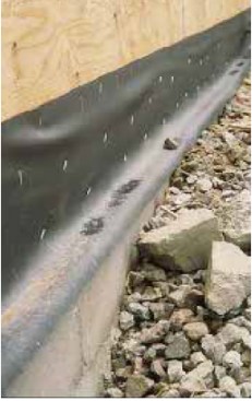

Lapping and sealing. At the base of the wall, through-wall flashing must be uninterrupted. At the joints and corners of a house, the flashing should be lapped at least 6 inches and sealed. This is easily done if you’re using self-adhesive rubberized asphalt flashing. Otherwise, consult the flashing manufacturer for recommendations regarding the proper mastic or lap cement. Note that some flashings react with certain mastics, drastically affecting the performance of the flashings.

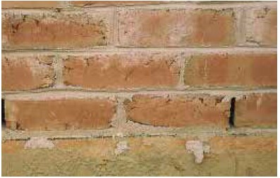

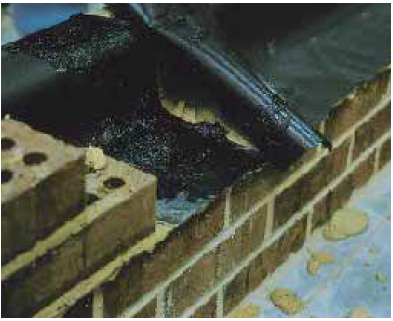

This flashing has been installed incorrectly, since it does not extend all the way to the front face of the brick. Any water is directed into the core holes of the brick instead of to the exterior.
Extend the flashing at least to the front face of the brick. Although the BIA recommends that the flashing should extend 1/4 inch beyond the brick face and turn down to form a drip, some of the flexible flashing materials can deteriorate when exposed to the weather. One solution with self-adhesive flashing is to install a metal drip in conjunction with the flexible flashing. If the flashing is installed sloppily – short of the face of the brick – then the collected water won’t be delivered to the exterior. Remember, the core holes are typically only 3/4 inch back from the face. Even if care is taken to ensure that the flashing projects no less than 1/2 inch from the face of the wall, the flashing can scoot back when mortar and brick are laid over it, allowing water to enter the cores of the brick.
Because of these problems, many installers extend the flashing well past the face of the brick until the wall is complete, then cut the flashing flush with the face of the masonry. According to the BIA, this practice is acceptable, although it is not recommended.

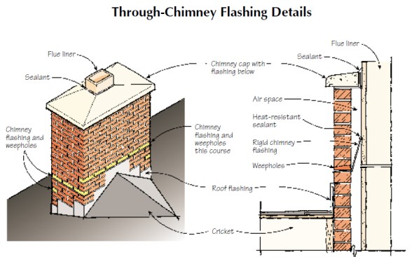

Through-Chimney Flashing
Most people are familiar with the visible base flashings and counterflashings that are installed where the roofing meets a chimney. These visible roof flashings prevent water from traveling between the roofing and the brick – but they don’t stop any water that is already in the chimney, such as water that may enter through the brickwork or the chimney cap. Through-chimney flashing is designed to prevent moisture that has penetrated the chimney from traveling below the roof.
Through-chimney flashing operates on the same principles as through-wall flashing. Through-chimney flashing has to be installed above the roof flashing, even if that means putting it a few courses up, so that the collected water is led to the exterior.
In addition to common roof flashing, a brick chimney requires flashing under the chimney cap and through-chimney flashing. The through-chimney flashing stops any water that has entered through the brickwork or cap. Through-chimney flashing is designed to collect any water that finds its way to the back side of the bricks.
Flashing should also be installed under a concrete chimney cap. This prevents moisture from entering the top of the masonry, and also prevents staining or contamination of the brick. The flashing can be laid in place above the top course of bricks, before the concrete cap is poured.
A mortar wash does not form an adequate chimney cap. A mortar wash will shrink and crack as it cures, especially when the mortar is brought to a feather edge (see “Troubleshooting Common Chimney Problems,” 7/98). Mortar is very similar to concrete, only with smaller aggregate. Remember, concrete usually needs something to give it some tensile strength and to prevent cracking – for example, 6×6 mesh or other reinforcement.
For chimney applications, choose a flashing material that can hold up to the potentially high temperatures expected when the flue is in use. Use metal flashing at the chimney cap.

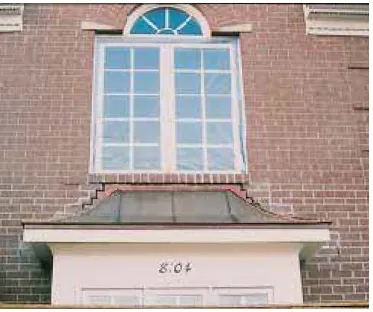

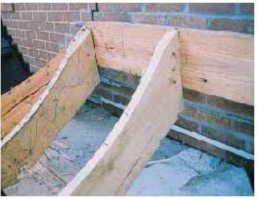

If the flashing at the head of a bay window is placed directly above the lintel, it serves no purpose, since it directs water to the interior of the house.
Bay Windows
A fairly common mistake when flashing brickwork above a bay window is to install the through-wall flashing too low. Although the IRC requires flashing to be placed directly on steel lintels, this is of little use above a bay window, since the lintel is under the roof — which is to say, the lintel flashing is inside the building. The flashing and weeps can’t direct the collected water to the exterior if the flashing is already indoors.
The correct location for through-wall flashing above a bay window is above the roof.
Above a bay window, install the flashing above the highest point of the roof flashing. This is similar to flashing a chimney. The flashing must continue over the entire length of the window area.

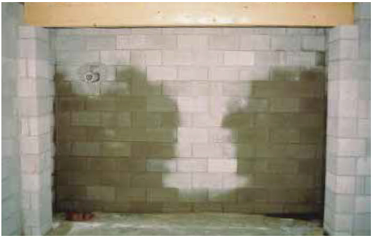

Some masons have built many brick veneer walls without flashing and weepholes, and claim that they haven’t had any water penetration problems. This is risky. The amount of moisture penetration through brickwork depends on the degree of exposure to wind-driven rain. We learned from El Niño that when more moisture is available, there is a greater likelihood of moisture penetration in any wall system. But the cost of correcting a moisture penetration problem will far exceed the cost of installing the flashing properly in the first place.
Omitting flashing and weepholes is risky. Water that penetrates brick veneer can saturate wood framing or enter the basement.
