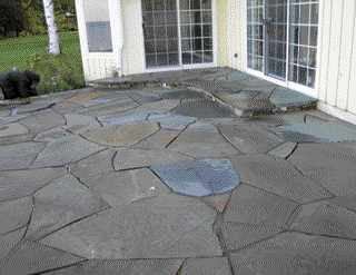

There’s nothing wrong with brick or concrete pavers; my landscaping company uses them for walkways and patios every year. But most of our clients prefer natural stone. Several types are available in our area of upstate New York; my own favorite — by far — is bluestone.
A type of sandstone, bluestone is a sedimentary rock that naturally splits into sheets when quarried. Its color comes from the sand from which it was formed, so it exists in a range of colors besides “blue blue” (which is as uniform in hue as a natural material can possibly be), including greens, browns, burgundies, and rusts.

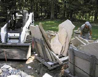

We generally use stone quarried in eastern Pennsylvania and southern New York, which gives our projects a regionally appropriate look and keeps shipping costs down. The patio in this article was built using irregular cleft flagstones, which are commonly referred to as “standup” because the large stones are shipped standing on edge on the pallet. Costs for flagstones start at about $3 per square foot.

In many parts of the country, stones can be mortared to a well-drained concrete slab. But here in the Northeast, where we have cold winters with significant frost action, we prefer to dry-lay the stones on a bedding course of concrete sand (an inexpensive washed sand that in coarseness falls between fine-grained mason sand and coarse-grained block sand) over a solid base of stone. In addition to being less expensive than mortaring, this technique results in paving that’s easier to maintain: Dry-laid stones can be removed and reset with minimal problems and will look as good as new afterward.

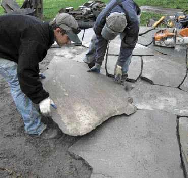

There are two methods of fitting flagstones together. The first, which gives the installation a more informal feel, is to find stones that have similar sides and match them up like a large jigsaw puzzle. We use this approach more often with pathways than with patios. Since all the stones are laid out and fit together before the final setting, there’s virtually no waste. Sometimes we use a brick hammer to break stones into smaller, more fit-friendly pieces, or to dress up edges that don’t quite fit.
We use the second method — which leaves very small seams, making the paved area safer to walk on — when we’re installing flagstone as a patio or more formal walkway. It entails setting one stone down and then either cutting another to fit next to it or overlapping the first stone with the second and making a cut through both. For cutting we use a Stihl gas cutoff saw equipped with a 12-inch diamond blade. Then, to keep the Old World look of hand-cut stones, we lightly chip the edges of all stones with a brick hammer; when we’re done, they appear to have been cut by hand.
This more painstaking method adds significant time (and therefore cost) to the project; also, we have to figure about 15 percent waste when estimating stone coverage.
Floating stone. The next step after fitting the stones is setting them. Over the years, I’ve seen people set large paving stones by banging them with dead-blow hammers and rubber mallets (bad for the stone), or by jumping up and down on them and stomping them into place (bad for the knees). But we’ve found that the best way to install large flagstones and pavers is to flood them into place.
Once the stones are in position, we literally flood the sand underneath with water, which accomplishes two things: First, it settles the sand completely, leaving no voids; since the sand takes the shape of the bottom of the stones, there are no hollow spots despite the irregular surfaces. Second, it creates a quicksand-like mixture that the stones hydroplane on, so one person can easily float even large heavy ones into place. As we float the stones, we wiggle them down to the proper height and pitch.
