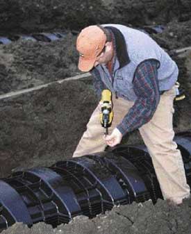

Installing the chambers. The high-capacity Sidewinder chambers I used on this job (Infiltrator, Old Saybrook, Conn., 800/718-2754, www.infiltratorsystems.com) can hold about 110 gallons of effluent, about 25% more than most chambers. The increased capacity results from making the sides taller. The design is great for soils that perc slowly. The Sidewinders also have louvered sides for additional drainage. The 6-foot chambers are placed in the trench end to end. They’re only about 40 pounds each, so they’re easy to carry and place.
They go in fast; installing the 21 chambers on this job took only about an hour. Matching end caps are installed before the first and last chambers go into the trench.
