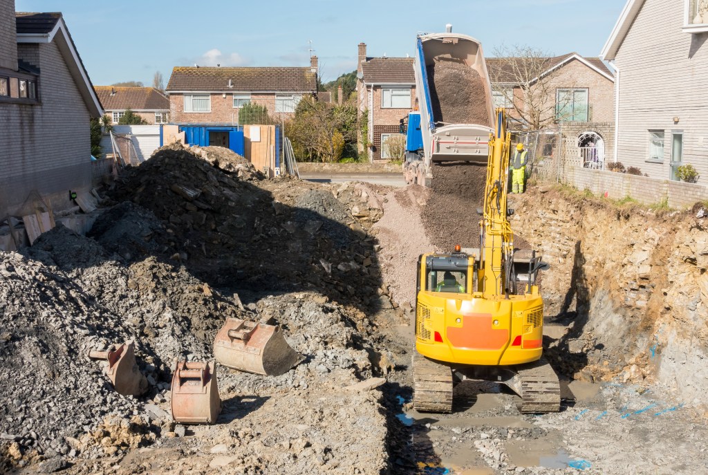

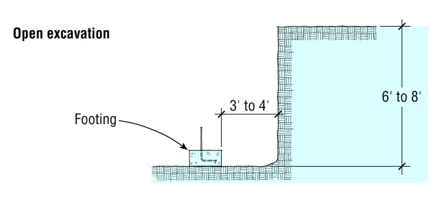

Excavating Foundation Holes
Plan foundation drainage before excavating to identify the locations of cleanouts and daylight drains (see Perimeter Foundation Drains).
Overdig foundation holes to give plenty of room for a well-draining backfill (see Soil Drainage), and to provide room to work.
  • If the depth of the excavation is 6 ft. or less, overdig by 3- to 4-ft.
  • If the excavation is deeper than 7 ft., the sides must be sloped outwards at a 45-degree angle above 4 ft. (Figure A), or install shoring (Figure B).
If the sides of an open excavation are higher than 7 ft., slope the sides back at an angle, or install shoring to protect workers who will be setting and stripping forms, applying dampproofing to the foundation, or laying foundation drainage

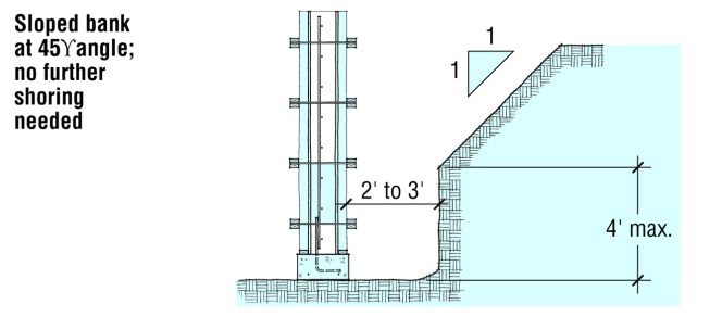

Vertical Cuts vs. Shoring
An unshored vertical cut should not exceed 5 ft. on a sloped site (Figure C). Be sure to reduce the danger of collapse by removing mounded dirt and rubble that can add a surcharge to the area above the cut. Install a series of steps or terraces — as required — to meet minimum height restrictions and reduce erosion (Figure D).

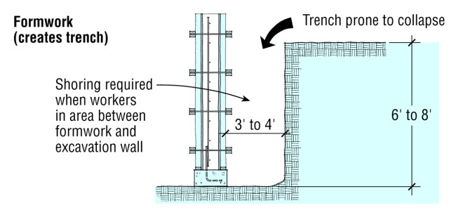

Shoring
In areas where vibrations or unstable conditions are likely, such as near a highway, railroad, or a backfilled trench, plan for very complete shoring.
Provide shoring in an open excavation (foundation hole) deeper than 7 ft. and in trenches deeper than 6 ft., unless the sides have been cut at a slope. On hillside sites, restrict unshored, vertical cuts to 5 ft. (see Excavating Hillsides.)

Shoring Alternative
If shoring is not used, slope the walls of the excavations at a grade of 1:1 (45 degrees) or shallower (Figure A). Foundation excavations should be sloped back anyway to provide room enough for a well-draining backfill.

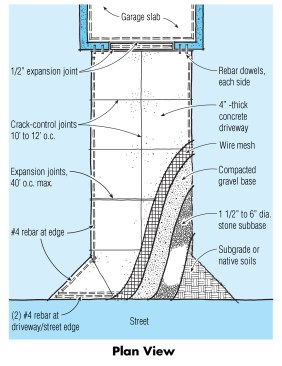

Drives should be installed before construction begins. If the schedule does not allow for this, use 2- to 3-in. of coarse gravel for a temporary roadbed, and use silt fences or straw-bales to trap silt and prevent erosion.

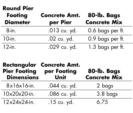

Estimating Concrete for Piers
Figure the amount of concrete needed to fill a sonotube by multiplying the height of the tube in feet by the concrete amount per pier, as shown in Figure K.

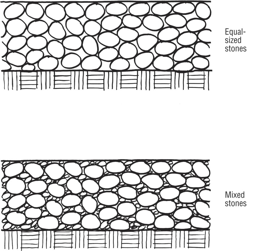

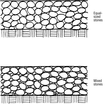

Compacting Soil
Any fill that is placed during or after construction, and any soil that is disturbed during excavation, must be compacted to prevent future settlement.

Good road base requires a mix of aggregate sizes (Figure U). Avoid using pea gravel and other natural gravels from river deposits. These aggregates are too round and smooth, and will not compact well, so they are likely to shift under traffic.
A roadbed made from stones of equal size (at top) will shift under the weight of vehicles. A dense mix of stones of different-sized aggregate (at bottom) will compact under load.

Like other durable roadbeds, a concrete drive is built up in layers: A subgrade of native soil (if suitable) or compacted fill, a subbase of compacted stone, a base of compacted gravel, then a 4-in. concrete slab (Figure W).
To prevent settling and cracking, a concrete driveway must be built on a well-compacted base and subbase. Use rebar to reinforce slab edges and control joints to limit surface cracking.

Where the driveway joins the street, thicken the concrete to 12 in. and reinforce with double rebar (Figure X).

Isolation Joints
Concrete expands and contracts with temperature. To prevent damage to the driveway or other structures, place expansion joints where the driveway meets the street and the house, and within the driveway every 40 ft. or less (see Control Joints for Concrete Walls).
Garage Transition
Where the driveway meets the garage, the driveway slab should be free to move up but not down. Even a piece of garage door trim that restrains the slab from heaving upward may crack the concrete. Expansion joints must also be placed on each side of a garage transition to isolate the driveway from the garage (Figure W).
To support the slab edge and to keep it from sinking near the garage transition, drive rebar dowels into drilled holes in the foundation wall (#4 bar, 12-in.-long, driven minimum 2 in. into wall, 4 ft. o.c.).
Expansion joints in exterior slabs should be sealed with caulk to prevent water from infiltrating the joint (see figure, Finished Expansion Joint in Structural Slabs).
Crack Control Joints
All concrete will crack from shrinkage as elements cool after placement and water evaporates. Control joints are provided to induce cracking to occur at the intended location. In driveways, place control joints in a roughly square grid with squares 10- to 12-ft. on a side. When cracks occur, seal the cracks with caulk. Advise homeowners that caulk must be renewed every few years to prevent water intrusion below the slab.
Crack Control Reinforcement
Support from the base, not from steel in the slab, gives the slab the strength to carry vehicle loads. Steel should be included to limit the size of shrinkage cracks. Use #3 or #4 rebar around the slab perimeter, 3 in. from the edge and 2 in. down from the top surface. In the field, use 6×6-in. welded wire mesh, 2 in. down from the top surface (Figure X).
