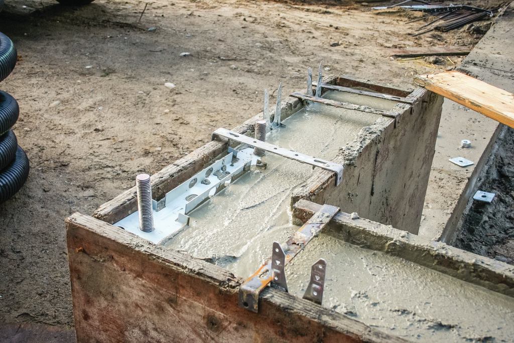

The March article “Building Stem Wall Foundations, Part II” addresses the use of Simpson Strong-Tie MASA mudsill anchors to attach the mudsill to the foundation. The author describes the installation of the TJ Shear Brace anchor-bolt spacer (Simpson Strong-Tie recently acquired the TJ Shear Brace product line from Weyerhaeuser). The caption for Figure 7 (see photo, left) states, “In the rush of the pour, the template was installed upside-down, so the author will just pop it out after the concrete has set up.”
The TJ Shear Brace anchor-bolt spacer is intended to be embedded and remain in the concrete. Not only does it help to accurately locate the anchor bolts, but it also plays an integral role in the design and performance of the anchorage as a part of the lateral force-resisting system.

Editor’s note: We followed up with Mr. Knudson by phone to find out what role the anchor-bolt spacer plays in the shear-wall bracing system, and also to ask what remedies might be available to a contractor who discovers, as our author did, that the TJ Shear Brace anchor-bolt spacer had been installed upside-down.
While the engineering is by no means simple, the simplest answer to the first question, according to Mr. Knudson, is that the anchor-bolt spacer, by virtue of its size, thickness, and shape, both reinforces the concrete and transfers the shear forces from the anchorage into the concrete.
As for available remedies, the good news is that there may well be a nondestructive solution. According to Mr. Knudson, Simpson Strong-Tie typically would work with the engineer of record to calculate the actual demand load on the shear brace system, taking into account the capacity of the anchor bolts and any additional ties that may be embedded in the concrete. In a best-case scenario, this re-evaluation of the load might conclude that the system will function properly without modification. If some additional anchoring is required, it might be possible to use the flat anchor-bolt spacer made for CMU installations in conjunction with epoxy-based anchor bolts to re-establish a connection sufficient to transfer the shear forces. As a last resort, a section of the concrete wall would need to be removed and recast, with the anchor-bolt spacer properly embedded and the new concrete properly tied into the existing wall.
