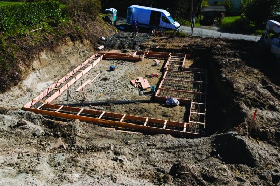

The footings on this project were much more complicated to form than those we typically see. In order to support the lower level’s full-height concrete walls, which were designed to support the two-story walls above the two-car garage, all the footings were considerably wider and deeper than usual. In fact, each run was a custom width and depth, and one area of the footings was poured as a structural slab. There was nothing regular about this job, which is why it worked out financially to form the footings in-house, rather than to sub the job out.
Each run was a custom width and depth, and one area of the footings was poured as a structural slab.
It took us about seven hours to form the footings. My process for laying out the footings was similar to that in an article I wrote a couple of years ago (“Building Stem Wall Foundations,” Feb/13). But this time I used 2×12, rather than #2 1×6 pine, to form the 12-inch-deep footings. We still staked the forms every 4 feet; even though the 2×12 doesn’t bow as easily as 1×6, we wanted to make sure the forms stayed in place during the pour. And we continued to work to the same dimensional tolerances—within 1/4 inch—for concrete work.
To ensure exact placement of footings, the author tacked a nail and strung a line to mark the outside of the foundation wall.

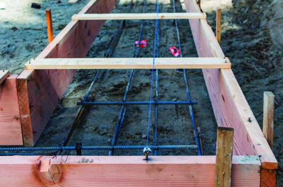

To build the footing forms, we started on a corner at the longest run. After building the corner, we marked the offset (the distance from the outside of the foundation wall to the outside of the footing) on the corner form board and tacked a 6d nail to this mark. We also marked the width of the foundation wall and labeled it. We then built the two runs out from this corner, squared those, and staked them straight.
When the opposite corner was built, we again measured for the offset and snapped a line between the marks at each corner across the top of the stretchers. This line (repeated for each run of footings) represented the outside of the foundation wall in all locations. Having this line minimized the math and need for constant measurement. Since all the runs had different offsets, we depended on having an easy visual reference. It also made it easy to know exactly where to run the vertical rebar when it came time to tie that in, before pouring the footings.
It took us the day to run all the footing forms. The next day, we finished staking the footing and then raised it to exact level all the way around using our Stabila LAR250 laser level.

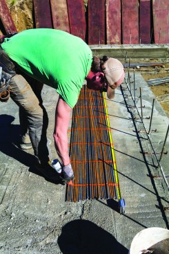

We had a lot of steel to tie in the footings; some runs had three #4, some had four #4 bar with shorter pieces perpendicular to the longer runs (the engineer called longer runs “longitudinal” and the shorter bar “transverse”). The following are a couple of rebar details in the footing that required special care:

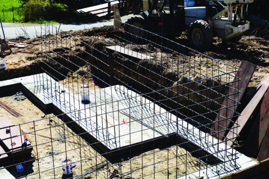

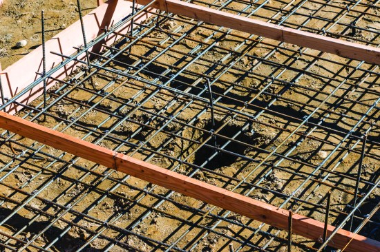

Structural mat. We needed to tie two mats of steel in a structural footing that was 9 feet 3 inches wide by about 16 feet long. We had ordered our rebar precut so all we needed to do was assemble the mats, which we did using our Max rebar tying gun.
Of these two steel mats, the lower one had to be 3 inches off the ground. We first laid the longitudinal and transverse rebar within the lower mat, tied it together, and then supported the mat on chairs.
Next, we tied together the second mat and held it down 2 inches from the top of the form on 2x4s that we laid across the top of the form to span the width.

We had one hold-down bolt to locate in the structural mat. Again, having nails tacked showing the location of the stem wall made this easy. We tied in the hold-down bolt and also dug out underneath it to make sure it had proper embedment.
The structural mat required two grids of steel, one sitting on rebar chairs and the other hung from 2x4s laid across the forms.

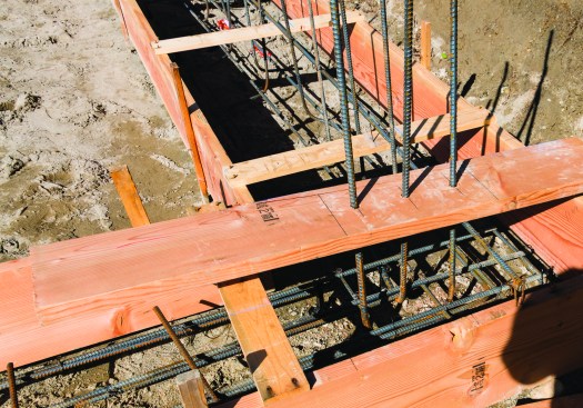

“Verts.” We needed to tie the shorter vertical steel—“stubs” or “verts”—into the footing at a specific spacing. Per the engineer’s notes, these needed to be placed with the hooks alternating direction. Since we had snapped lines across the top of the 1×4 spreaders, we knew exactly where to place our verts in the wall. We then placed a long stick of rebar on top of the cleats, tying the verts to this, as well as into the footing steel. The Max rebar gun made this easy work.
The garage openings required a steel frame formed out of rebar within the concrete walls.
To tie this into the footing, the rebar verts had to be positioned precisely.

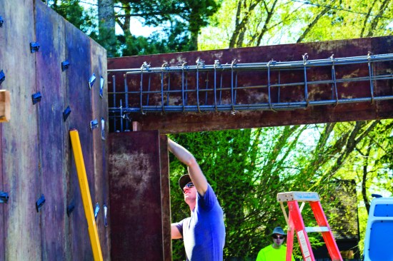

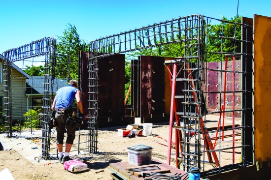

Garage portal walls. The garage openings required a massive amount of steel to create a moment frame within the concrete. In the narrow portal walls, the vertical steel on this frame had to tie into the footing steel. I used a 2×12 cut-off to lay out the position of the steel for these verticals and drilled it out to hold the steel precisely where we needed it in the portal walls.

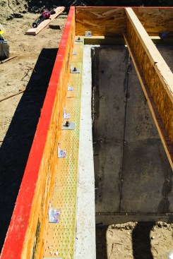

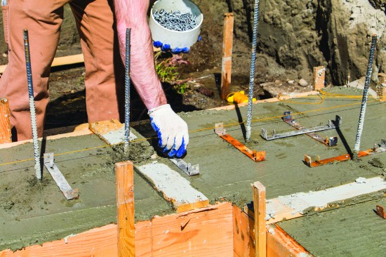

After we finished placing the footing concrete, we ran a dry line—using the same 6d nails that we’d placed in the form boards to mark out the position of our foundation walls—and set spreader cleats for the foundation wall forms. We used 1-1/2-inch x .131 Teco nails to keep the cleats in place on top of the green concrete.
After footings were poured, cleats were installed on the green concrete with “Teco” nails.

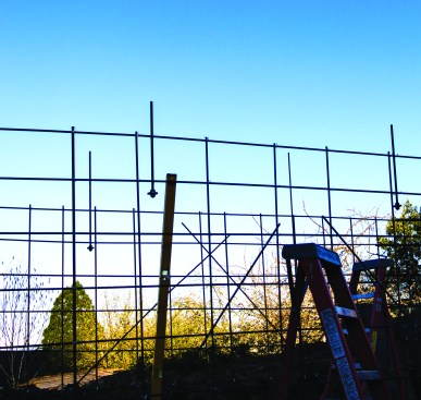

Before placing the forms, we had to tie full-height vertical steel onto the verts that were tied into the footings. We first took our precut bar and spray-painted the horizontal layout. This made it easy to get the exact spacing, and it made it easier for the engineer of record (EOR), who served as the special inspector for the town, to inspect the steel placements.
The position of the horizontal runs was spray-painted on the rebar that would be used for the verticals ...
The position of the horizontal runs was spray-painted on the rebar that would be used for the verticals …
... in the rebar gridwork for the walls.
… in the rebar gridwork for the walls.
Using our rebar tying gun, we very quickly tied the vertical steel, one man scattering and holding the bar while the other man tied it off; it took only about 15 minutes to tie off the verticals for the entire foundation. After lunch, we spent a little over an hour tying the horizontals in place. We were able to speed up the process of tying in the horizontals by ordering full-height 30-inch-by-30-inch corners. This way, we didn’t need to bend them on site—which the engineer also wanted to avoid because that can cause small cracks on the rebar. It also allowed us to plumb the corners before tying two runs together and helped us keep the rebar centered within the wall section, which was also critical from an engineering standpoint.

Around the portal frame, the forms were left off to allow inspection.

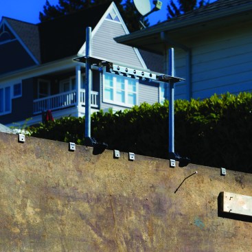

For a Simpson Strong-Wall to be installed in the front wall, a template first needed to tie into the foundation.
At the garage opening, we also had to lay out the template and tie in the large bolts for the Strong-Wall wood shear walls. These Simpson Strong-Tie panels were specced by the engineer and were needed in the wall frame above the garage door opening to provide shear resistance next to the cantilevered nook that would be framed in.
The Simpson shear walls are pretty cool. They were originally a Weyerhaeuser (I-Level) product and we used them in 2009, before Simpson acquired them. They give you more flexibility for drilling holes in them to run electrical than you would have in site-assembled shear-wall sections. They call be ordered in heights up to 141-1/4 inches and cut to length in the field.

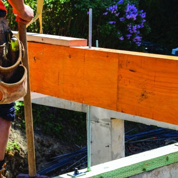

A23 corner brackets secured the mudsill to the rim joist.

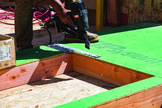

After the rim was on, we had to install A23 framing angles—the ubiquitous framing angle required in seismic country to maintain load paths every 16 inches from rim to mudsill.

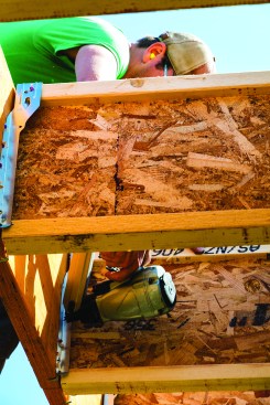

Working off ladders can be very time consuming, so whenever the crew could, they attached joist hangers to the floor structure before it was lifted into place.
It is possible to be efficient, though. For example, we think ahead as much as possible, so we left room for a positive placement gun to speed up the process of installing the hardware. On the upper floors, we installed all the hangers on beams before lifting them into place, which saved time. But that’s not always possible. On the rear 2-foot cantilever, we had to install hangers to the rim joist upside down, and we had to do it after installing the rim.

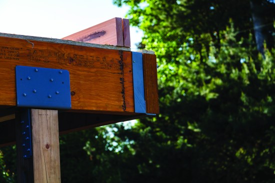

Some of the hangers had to be installed in place. One example was the inverted hangers used to secure the rim on the 2-foot cantilever on the back of the house.

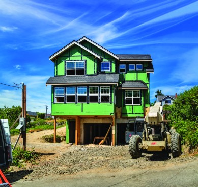

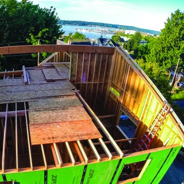

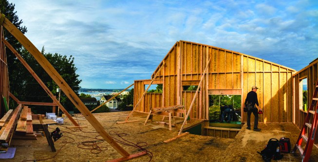

On the upper floor, we framed rake walls first, then the rest of our exterior walls, again adding all our strapping before lifting. With the rake walls in place, we set the ridge, then balloon-framed a two-story shear wall below part of the ridge. This balloon-framed wall locked everything together and was helpful, as we could use fewer wall braces when we framed interior walls.
Then a two-story balloon-framed wall was installed below the ridge.
