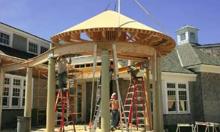

I envisioned the overall framing as four independent truss-framed modules joined together in the finished assembly: a half-cone, two sloping side modules, and a flat-topped center section. My trusses are nothing more than 2-by members connected with plywood gussets.
I designed the conical module around a series of identical triangular trusses fixed in a radial pattern around a central “hub.” The roof sections connecting the cone to the main house use a similar system of trusses arrayed along their respective framing lines.
The trusses’ tails bear on a curving architrave, a custom-made structural beam supported on six 4×6 posts concealed within hollow architectural columns. One of these columns was pre-existing and provided a point of departure for the new layout.

Conical framing. I began framing the semicircular conical section by building a hub, a 2-foot-diameter half-cylinder made of staves cut from an LVL beam. It’s glued together with West System epoxy (866/937-8797, westsystem.com); for added mechanical strength, I bound the staves with four perforated steel straps. The staves — which are 1 3/4 inches wide on their outer face — provide faceted surfaces for attaching the 2-by trusses.
We set the trusses on the semicircular architrave and screwed them to the hub from the back, using 4-inch Timberlok screws (800/518-3569, fastenmaster.com), one each into the top and bottom chords.
The truss tails landed at about 20 inches on-center. To create more solid backing for the curved fascia, we glued and screwed lookout blocks on 6-inch centers to a length of 1-by cedar, then nailed this assembly to the truss tails, effectively tying them together.
We then sheathed the back of the half-cone with a single layer of 3/8-inch plywood, cutting holes between the webs for access and air circulation. We added cleats on top of the plywood to catch the lower-pitched abutting roof sections. (It would have eliminated compound valleys and simplified construction if the cone and the connecting roof were the same pitch, but I lost that argument.) I left the top of the cone flat, about a foot short of the peak, to be filled in after the adjoining sections were framed and sheathed.
