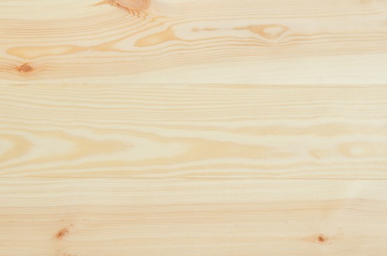

Select 1-by and 5/4. Among the finish-grade “white woods” typically found in lumberyards (mostly pines of which there are several used for finish lumber, but occasionally may include aspen and balsam fir), most select lumber grades are generally described by letters.
A Select
A Select
A Select (or Clear) is not common. True “clear” material has no visible defects on either side of the board. It’s preferred for naturally finished or high-end painted trim and cabinet stock.
B Select (sometimes called Prime) may have small defects such as pin knots or a few pitch pockets. It is also used for trimwork and cabinets, but if a natural finish is called for, carpenters will need to select the best side and strive to cut out the infrequent defects.
B&B (or B&BTR). Frequently, you may find yards carrying “B and Better,” which is a mix of A and B Select materials.
C Select may have tight pin knots that are more frequent on one side than in B Select, but it should have one side that is nearly clear. Here, too, carpenters will need to select the best face, but they will likely to have to live with some pin knots.

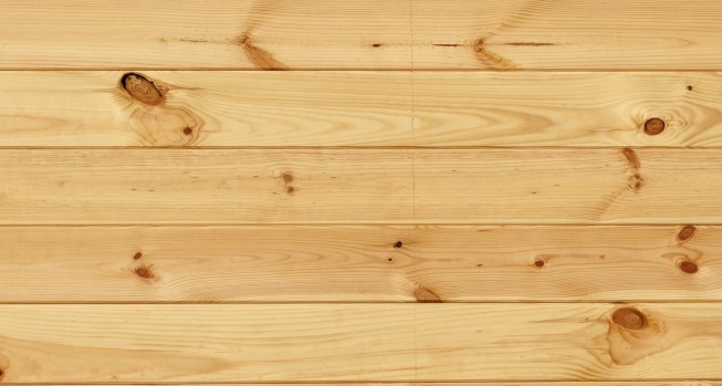

Common 1-by and 5/4, sometimes referred to as the “knotty grades,” is normally a non-stress-graded product used for construction and utility purposes. Common finish lumber is generally separated into three different grades, No. 1, No. 2, and No. 3.
No. 1 Common is high-quality pine with a knotty look. Knots are tight and small. It is used mostly for shelving in closets and inside cabinets. It paints out OK if you seal the knots before priming.
No. 2 Common has slightly larger, but still tight, knots. It doesn’t paint as well as No. 1 Common. It’s one of the most available woods and is better for sheathing or fencing than for any finish application. You have to sand around knots, fill checks in the larger knots, and seal before painting. It’s very hard to pull off for interior uses unless you’re purposefully going for a “rustic” look.

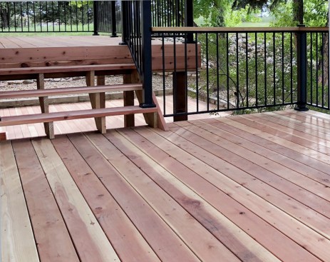

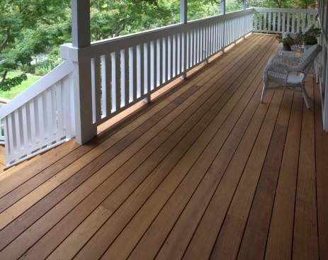

Redwood and cedar. While classified as softwood like the other woods dealt with here, redwood and cedar are in a class of their own. In both species, there is a pronounced difference in color between heartwood and sapwood. Heartwood also has high natural resistance to decay, so some grades are denoted as “heart.” As a species, redwood tends to be harder and wears a lot better than cedar as a deck surface. Both species are relatively decay resistant, but must be maintained. They are not rot-proof.
Because Select grades emphasize the quality of one face, the reverse side may be lower in quality. Select lumber grades are not uniform across species and products, so certified grade rules for the species must be used for detailed reference. Cedar architectural grades include Clear Heart, A, and B. Redwood architectural grades include Heart Clear (or Clear All Heart), Clear, Heart B, and B Grade.
Clear Heart redwood
Clear Heart redwood
Common Grade redwood
More economical common grade redwood and cedar is also available, most of which is a mix of heartwood and sapwood.
Cedar and redwood are normally kiln-dried. It’s critical that you unwrap these if they are wrapped in plastic and let them acclimate to jobsite conditions before installing them.
