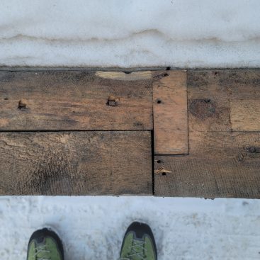

The original rim beam was fairly massive, albeit cobbled together. If it had been smaller, it would have slid off the foundation long ago.

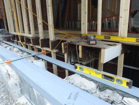

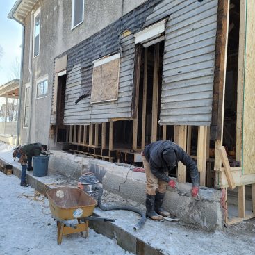

As we began our demo work, however, we started to uncover layers of crazy: The most glaring discovery was that in one section of the wall the floor joists had become completely disconnected from the rim for no apparent reason. Elsewhere, floor joists had been drilled out and sliced up for mechanicals with no regard for the joists being part of a structural system – we dubbed these “decorative joists.” In one corner, five floor joists had been cut during a past staircase modification, so the corner of the house had effectively been cut loose. The rim joist, now free-floating, was all that was left to support the balloon-framed exterior wall, which had begun to slowly slide off the crumbling foundation. Thankfully, the existing rim joist was an 8×8 beam. If it had been anything less, it would have completely slipped off the foundation and the second floor would have crashed in long ago.

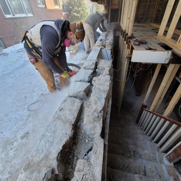

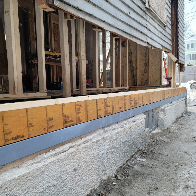

We got lucky! The engineer largely agreed with our solution. This was not a foundation failure; only the first two courses of stone had become unstable. The rest, which extended another 8 feet down looked stable. The engineer agreed that if we could grab hold, so to speak, of those top courses of stone, clamp them together and effectively bind them in steel, grout and pin them to the foundation below, we would have a solid structure to which we could reattach the floor framing. On this, we could rebuild the rim and provide solid bearing for the wall.

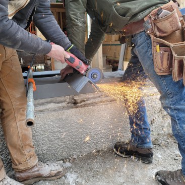

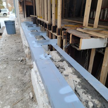

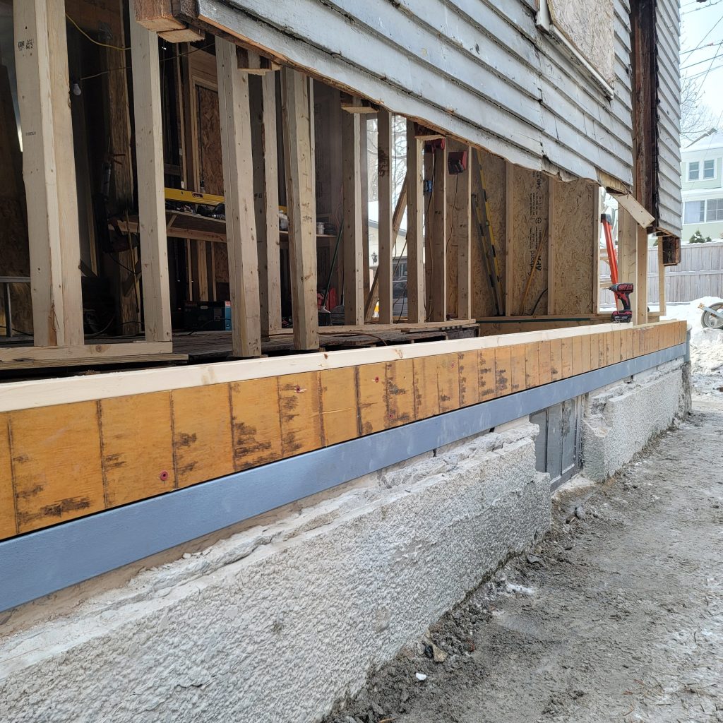

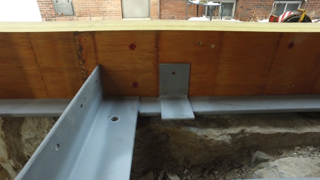

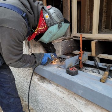

Once we agreed on the proposed cost-effective approach, the engineer specified the exact details for an angle-iron ladder, welded up with angled cross-braces that also functioned as brackets for securing the new rim and joist connections. The ladder spanned the top of the foundation and included L-brackets to which we attached a new rim beam.
Before installing the steel, we had to first clean up the loose foundation courses—very much like drilling out tooth cavities and removing the loose debris—and then pour reinforced fillings—rebar embedded in non-shrink grout. We were relieved that the engineer agreed that grouted rod would suffice to pin the steel to the rock. Drilling into an old foundation to set epoxy anchors can be very disruptive and we didn’t want our work to cause even more damage.
As our engineer described it, the aim of the proposed fix was two-fold: to provide a more stable vertical load path, and to provide a connection for the joists. For this scenario, he specified a triple LVL rim joist. This much beam is needed to support several different loads: It has to tolerate the force of balloon framing, which has floor and roof load coming down in points. That load must be distributed or the rim would twist. We’ve also got the lateral force of the first floor system, pulling inwards on it. It has to distribute force in one direction and be stiff in the other. Not your typical rim joist, but it did the trick at a price the owner could afford.
