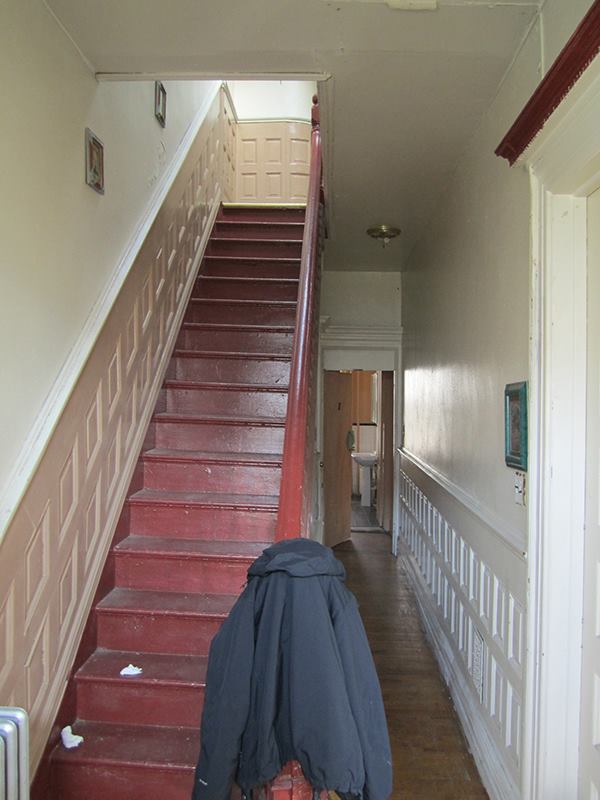

As is typical in townhomes of its vintage, the Brooklyn project house has a staircase that hugs one of the long party walls between units, and a "relieving wall" that helps support the floor joists, which run across the whole width of the unit. This wall was removed during renovations, requiring the floor system to be reinforced.

Stairs often present another structural issue, says Dunne. "Stairs, more than anything, tend to sag," she says. Frequently, she says, stair headers and trimmers are joined with mortise and tenon joinery that has slipped or broken, so connections need to be reinforced. "In this house," she says, "we moved the staircases around. So we used engineered lumber to create new stair openings."
