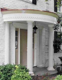

Long ago, I was asked to build a curved portico by adding a roof structure and columns to an existing semicircular front porch on my client's Greek Revival-style home. The critical dimension for the new roof structure was the outside arc of the existing masonry porch below, which the new roof would have to match. And since the curved crown molding had to be special-ordered to size, accurate layout of the structure's outside arc was vital for a good fit.
Working on a circular rather than a rectangular shape requires a different mode of thinking. All of our layout would need to start at the outside of the crown and work inward toward the center. So instead of a lot of complex math and "air framing," I decided to take the same simple approach I use to build gable end walls: Lay out and cut everything on the ground.

Cellular PVC Trim
With the trammel already set up to cut the plywood plate, we cut the matching base cap from 1/2-inch-thick Azek PVC material (Azek Trimboards, 877/275-2935, www.azek.com). The base cap would be attached later to the underside of the plate to create a finished soffit. Because Azek is available in 4-foot-by-8-foot (and longer) sheets, we were able to make the base cap from only two pieces of material.
PVC trim has limited compressive strength, but on this small porch the loads wouldn't exceed 1,000 pounds per column; to minimize point-loading, we cut and fit the columns carefully and belt-sanded the tops smooth for full bearing where they would support the soffit. On a larger, heavier structure, we'd have cut the Azek to fit around the bearing points.
In addition to being durable, Azek is easy to work with, and I felt we'd be able to bend this thin 1/2-inch stock to fit the curves around the inside and outside fascia. However, wrapping the fascia with Azek proved to be a challenge in chilly weather. While PVC trim is fairly flexible, we found that Azek's cellular structure does not react well to impacts when the temperature approaches freezing and the material is under pressure. When we flexed a piece and shot a nail into the center of the flex, the piece snapped.
So we started in the middle of the lower fascia board and worked toward the ends, screwing with stainless trim screws along the top edge where it would be covered by the overlapping fascia above. Then we carefully clamped and nailed the bottom edge as we slowly wrapped the boards around the outside radius.
After wrapping the fascia, we made and applied matching Azek dentil blocks. First, we glued the back of each block with Azek's proprietary glue, which is similar to plumber's PVC cement but with a lot more working time; then, to temporarily hold the blocks in place while the glue dried, we pinned them with a Senco micropinner. This tool leaves such a small hole you can't see it, even up close.
Next, we installed two columns to support our structure, with split columns against the wall just for show. Besides having to reinforce the masonry stoop with piers below frost level and fudging the stoop's slightly irregular shape, the only hitch we ran into here was meeting the new wind-load regulations. Since we chose to use hollow composite columns, I had to figure out a way to securely tie the roof to the masonry stoop below. So we bolted brackets to the concrete, attached aircraft cable to them, fished the cable up through each column, and bolted the cable to the rafters above after setting each column.
As we finished the interior vertical surface of the fascia, we wedged the top edge of the trim boards against the framing, slowly bent each board into position, then held it there with bar clamps instead of screws or nails. When we cut the last piece and snapped it in place, friction held everything tightly so that we didn't need to use fasteners — which would have snapped the Azek in two at such a tight radius.
To finish off the ceiling, we used Azek beadboard, centering the middle board on the centerline and then working toward each corner. We used a cutoff (from the cap trim) as a template to scribe the cut line where each board met the inner curve, positioning the template with two measurements — the long point and short point — which we determined by measuring off the previously installed ceiling board. Since the joint along the fascia would be covered by trim, we didn't need to finesse the scribing.

To provide nailing for the crown, we cut triangular chocks out of 2x4s, set them into construction adhesive, and pinned them to the bottom of the roof sheathing. Then we wrapped a full 12-foot length of crown around the middle section of the fascia so there would be two offset joints at the sides instead of one more visible joint along the center. At first we tried scarf joints to join the two shorter side sections, but we weren't happy with the results. So we simply cut butt joints, backed the joints with small wood shims, and used Marine-Tex FlexSet (ITW Philadelphia Resins, 215/855-8450, www.marinetex.com) flexible epoxy adhesive as both an adhesive and a filler. Like Bondo, this two-part epoxy can be sanded to a fine finish, but it has a longer working time and is white when it dries, so we used it with the Azek, too.
The portico's EPDM rubber roof was glued down over insulation board. First, though, the roofer dressed up the edge of the roof with a curved copper cap, then flashed the wall with a matching copper flashing tucked into the brickwork. The electrician installed the client's light fixture, and later we returned to put in a new fiberglass entry door.
Our client loved the look of the porch trim so much that we ended up replacing all of the home's exterior millwork with cellular PVC. And while I've recommended that 100 percent acrylic paint be applied over the new trim, it seems that they like it just the way it is.
