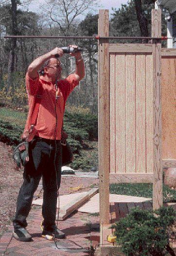

The design I like has evolved over the years. I use pressure-treated 2x4s to outline the structure, and western red cedar 1-bys for the walls. Instead of nailing or screwing the boards to the 2x4s, I float them in a groove dadoed in the edge of the framing, frame-and-panel style. To eliminate “peepholes” between boards, I cut a shiplap on the edges.
To assemble the individual panel frames, I use 6-inch, hex-head TimberLok fasteners (Olympic Manufacturing Group, 800/633-3800, www.fastenmaster.com). Although TimberLoks generally don’t require predrilling, a pilot hole keeps the screws from going astray in narrow stock. I clamp the 2×4 frame components between temporary cauls for alignment and use a 12-inch-long, 3/16-inch-diameter electrician’s twist bit to make the pilot holes (see Figure 1).
Figure 1.The author’s frame-and-panel method simplifies enclosure assembly. Edge-dadoed frame members are butt-joined on the flat, held in alignment with cauls and clamps (top), and lag-bolted together (bottom).
