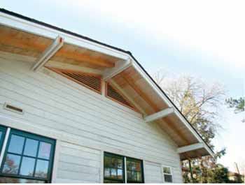

To begin with, the architect's plan showed several small decorative gables perpendicular to the main roof, which we stick-framed using California valleys. There's nothing unusual about that, but the plan also showed 4-foot overhangs at every gable, with barge rafters supported on purlins that appear to extend from inside the roof structure. In addition, there was to be a pair of oversized triangular gable vents under each roof peak.
Normally on a straight truss roof, we would simply use gable-end trusses. But the combination of the large louvered vents and the large overhang forced us to stick-frame the gable walls.

If we'd used gable trusses, we probably would have had to cut through chords or web members to fit the louvered vents and the purlins. Rather than try to special-order a gable truss that would work, we decided it was simpler just to stick-frame the gable walls.
To support the 4-foot gable overhang, we ran the purlin members back to the first truss and attached their ends to solid blocking. For extra strength we added an upside-down beam hanger to resist the upward rotation.
Triple 2-by members passing through the stick-framed gable walls form the 4-foot support purlins for the deep overhangs.
An upside-down beam hanger secured to solid framing on the inside helps resist rotation forces, and a cap flashing protects the exposed horizontal surface at the top end of each purlin.
Where each purlin passed through the gable wall, we nailed it to a stud positioned for that purpose. The purlins were built up from three 2-by members — a 2x6 sandwiched between two 2x8s — which permitted us to lap the stud where the purlin pierced the wall and to nail from both sides. We also put cripples beneath each side, for additional support.
On the outside of each gable, we installed a frieze board against the wall, as well as a 3x6 rafter — supported by the purlins — in the middle of the overhang and a 2x8 fly rafter at the outer edge.

At this point we were ready to finish sheathing the main part of the roof with OSB and install the 2x6 beveled-edge T&G at the eaves and gable overhangs. Like the rafter tails, the fly rafters had been positioned an inch below the tops of the trusses so that the exposed soffit would be flush with the main roof sheathing.
Two-by-six beveled-edge T&G pine completes the stick-framed look.
