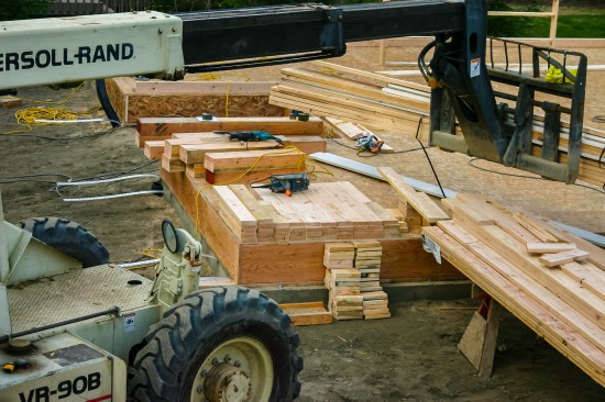

An all-terrain forklift has revolutionized the framing process for the author. With it, he can keep the area relatively free of lumber, and just serve it up when and where he needs it.
Distributing materials. We have the lumberyard do a materials takeoff, except for the roof. (We typically stick frame roofs and have found we have a better understanding of the specific requirements than anyone at the lumberyard.) Those takeoffs are key to establishing a schedule of deliveries so material gets dropped on time. We no longer have the lumber load for the entire house dropped at the same time. Instead, we order by task—for example, first-floor framing, then first-floor walls, then second-floor framing, then second-floor walls, then the roof—and have these delivered separately. This keeps the lumber organized, and leaves us with more room to move around the site.

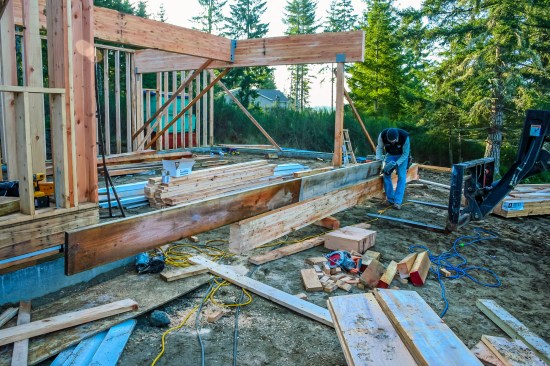

For most houses, we have the first-floor framing delivered before we get to the jobsite, and we rely on a forklift—that we own—to move the packages where we need them. When we didn’t have a forklift, we made sure that the lumber was dropped as close to the foundation as possible, but that sometimes created an obstacle we had to work around.
Typically, we schedule the first-floor wall framing package for delivery later on our first day. This way if we finish framing the floor and the inspector hasn’t arrived yet, we can start to cut window and door packages for the wall framing.

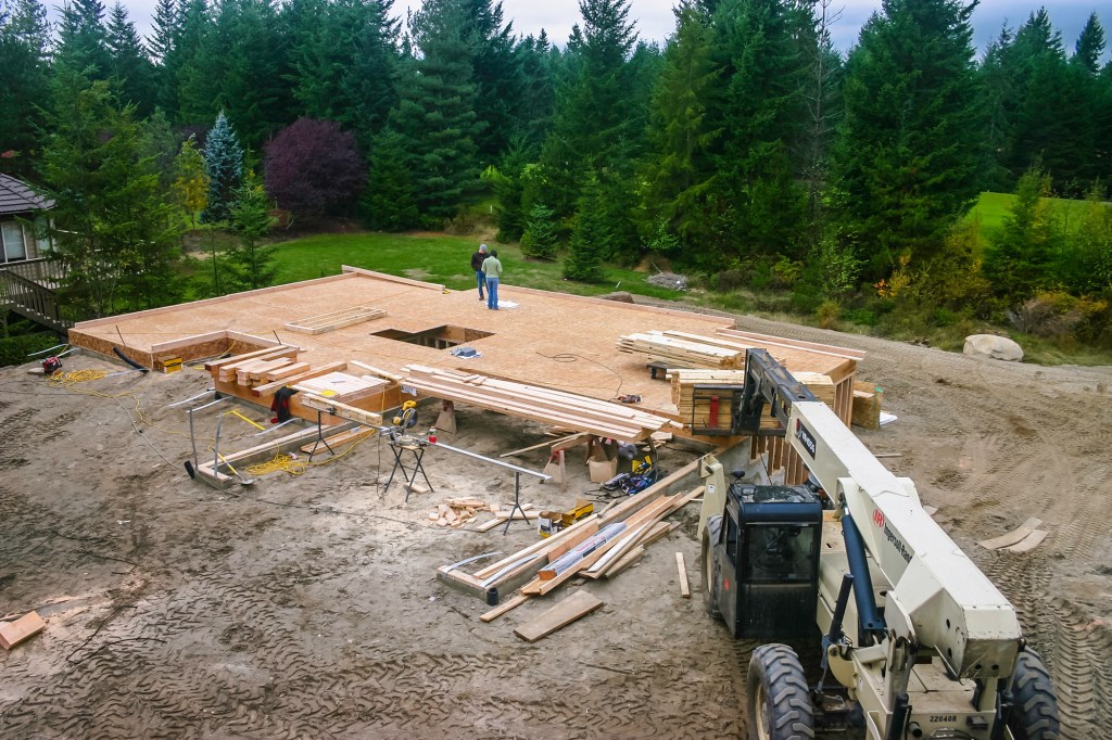

Buying a forklift totally changed the way I look at a framing job. Now it really is just a giant spread-out assembly line that we can set up and maintain as materials are delivered. To make the assembly line as efficient as possible, I break the framing process down into basic tasks, and then group materials, tools, and framers into units for each task.
Tim Uhler

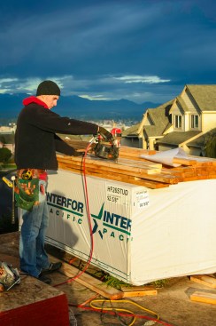

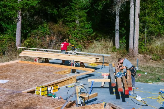

The crew typically sets up a cut station in the garage, placing all the plate stock and window and door material on sawhorses at the same height. That way, the framer doesn’t have to bend over when cutting stock.
We typically put stud material in the middle of the floor deck so it is easy to get to it from all sides.

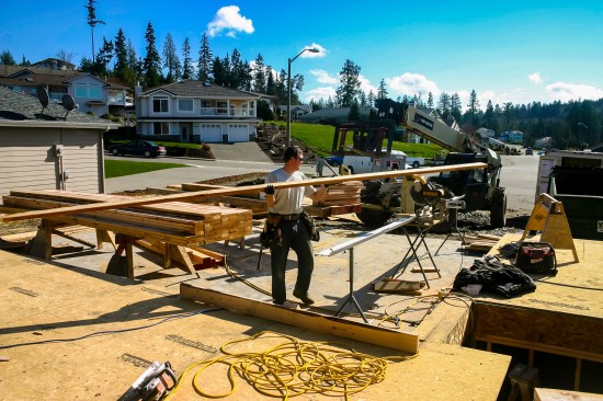

With a four-man crew, we typically set up a cut station in the garage area with a sliding compound miter saw (SCMS) and table. We place the framing stock that is both our plate material and window and door package on sawhorses behind the cut station. That way, the material is at the same height as the saw, and all the framer has to do is turn around to grab materials. It wastes time if a framer has to leave the cut station to get material, so setting this up in advance is time well spent.
Tim Uhler
While one framer works at the saw station cutting cripples and plates, another framer uses a 10-inch Big Foot saw to cut the header list. The person cutting header stock will finish first. After he’s done, it’s his responsibility to jump in where he can. Most likely, he will move to tacking plates to the line, and to scattering materials in preparation for nailing walls together.

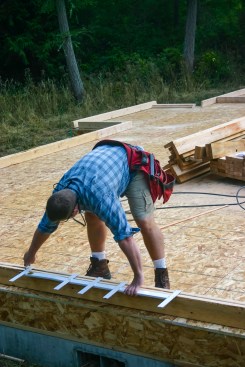

One framer starts plating and detailing. I prefer that the most experienced guy on the crew do the layout—because he is most accurate and the fastest. However, I want every guy I work with to be able to progress as fast as he is able, so I am not always the guy doing the layout.
Plating goes quickly because we use a Big Foot 10-inch saw to cut two plates at a time, and a layout stick to speed up layout.
Tim Uhler

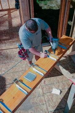

The author uses a layout stick to mark out plates. He splits all plates longer than 16 feet on a stud, pulling the layout from a corner, cutting the plates right at 16 feet, then pulling 16 feet to the next stud.

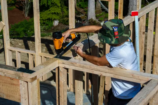

We don’t overlap all our top plates at corners or overlap intersecting walls. Instead, we use Simpson TP-37 plates to connect walls to eliminate errors relating to overlaps.
Tim Uhler
To avoid problems with top plate overlaps, the author simplifies this for the crew and relies on Simpson TP-37 plates at intersections.

Every gable wall is built as a rake wall and is lifted into place. Each end will be built and placed before the side walls, but it is helpful to frame up a short section of the side wall early, to brace the gable.

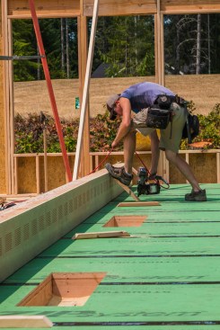

Shown above are two preassembly tricks that save time: A framer preattaches a rim joist to a girder before it is lifted into place with the forklift.
Whenever possible, we build walls on the floor deck. This is better (and faster) than working in the dirt or mud.
Tim Uhler
On ledgers and rim joists, it also saves time to preinstall joist hangers. It’s much easier and faster to do this on sawhorses than while balancing at the top of a ladder.
To further save time, we typically preattach hardware like joist hangers before we install a ledger or rim board.
