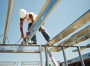

Advantages of Steel Floor Framing
As you can see from the table at right, at 24 inches on-center, a 10-inch-deep 54-mil steel C-joist can span 15 feet 11 inches at 40 psf live load (see Figure 1). To get the same span from wood joists of the same depth, you’d have to go to a 12-inch spacing. If you go to a 12-inch spacing with the same steel joist, you can span up to 20 feet. That’s a nice option if you want to build a bonus room over a garage without having to add a beam. You can span even farther with heavier-gauge joists, but I’ve found that if you go beyond 16 gauge, it gets difficult to drive screws into the material. Although steel is usually referred to by gauge on the job site, current tables reference it by mils of thickness. Sixteen-gauge steel is 54 mils thick, 18 gauge is 43 mils, and 20 gauge is 33 mils. For easy reference, steel framing is also color coded, with 16 gauge being green, 18 yellow, and 20 white. Unlike wood I-joists, steel joists also allow you to vary the gauge of the material to suit the span, without increasing the depth of the joist. That’s useful when you have two spans of different lengths that lap over a beam. With I-joists you’d have to frame the shorter span with an unnecessarily deep joist, or go to a shallower joist and face the problem of getting the floor surfaces to line up at the beam. With steel, you can use a 16-gauge joist on the longer span and go to 18 gauge for the shorter one — maintaining a constant depth without throwing away material.

To avoid these kinds of problems, we plan the floor layout with a central I-beam where we can lap the joists (Figure 3). That lets us adjust the joist length as needed without any cutting. The joists are still ordered to length, with an additional 6 inches to allow for the lap. This also saves time, because screwing the joists together back-to-back at the lap eliminates the need for web stiffeners over the beam.
