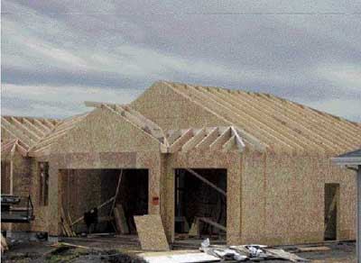

A Dutch gable (also called a Dutch hip) is a combination hip and gable roof. The pitches can be equal, but they were different on the roof shown here, so part of this story is about how to frame an irregular pitch hip. I'll focus specifically on the front right corner of the garage roof (see illustration, above). Note that on this job, we did not make the front and side soffits equal width, which is a more complicated framing process.

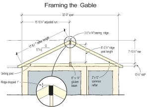

The gable sits back about 3 feet from the front wall. The 32-foot garage ceiling span is broken by a glulam beam that carries both joists and the posts supporting the structural ridge. The gable has a 5 15/16-inch pitch — arrived at in order to maximize the building height within the zoning restrictions.
Framing a Dutch hip starts with the gable, which in this case sits 3 feet back from the end wall. The author uses 10 3/4 inches as the heel stand, or height-above-plate (HAP), because it provides adequate bearing at the rafter seat cuts of all three pitches that will form the corner. Given the HAP, the span, and the pitch, a Construction Master calculator makes it easy to find the rafter dimensions and the height of the center post. Note that the ridge beam is dropped 1 inch to allow for ventilation
I use a Construction Master Pro (Trig Plus III) for roof calculations. First I calculate the adjusted run of the gable common rafters:
(span - ridge thickness) ÷ 2 = adjusted run of the common rafter
(32 feet - 3 1/2 inches) ÷ 2 = 15 feet 10 1/4 inches
With that number still on the screen, I punch the Run button, then enter the pitch by keying in 51 5/16 inches and hitting the Pitch key. At this point the calculator contains all the information needed to calculate the rafter length and rise. To get the length of the common rafter, I hit the Diag key, which returns the value 17 feet 81/4 inches. This gives me the rafter length to the wall plate, for the birdsmouth plumb cut. To cut the rafter to proper length, I have to add the 12-inch overhang to the run and redo the calculations.
With the rafter length still on the screen, I calculate the length of the ridge posts by hitting Rise. The calculator displays 7 feet 101/8 inches, the height of the ridge above the plates for a theoretical rafter with a 0-inch heel stand, or height-above-plate (HAP). This roof happens to be framed with 2x12s, so I made the HAP 103/4 inches, which provides plenty of bearing for the seat cuts on both roof pitches. I determine the length of the ridge posts by performing the following calculation:
Rise + HAP - ridge depth - depth beam in garage = adjusted ridge post length
7 feet 10 1/8 inches + 10 3/4 inches - 14 inches - 14 inches = 6 feet 4 7/8 inches
Dropping the ridge. To make sure air can reach the ridge vent, I drop the ridge by subtracting another inch from the ridge post, making it 6 feet 3 7/8 inches high. At this point, we can frame the gable portion of the roof and sheathe the gable wall. We leave off the fly rafters for now; they would only be in the way when we frame the hip.
Figuring the Hip
I start the calculations for the hip by calculating the short 8-pitch rafters that end at the gable wall. The sheathed face of the gable wall is 35 1/2 inches back from the front of the building. Because we're nailing the 8/12 commons to a 2-by ledger, I subtract another 1 1/2 inches to get an adjusted run of 34 inches.
Subtracting the thickness of the ledger from the 8/12 common run yields the "adjusted" run of 34 inches — the basis for the layout of the hip corner in plan. Adding the 10 3/4-inch HAP to the rise of the hip and commons gives the top height of the ledger.
