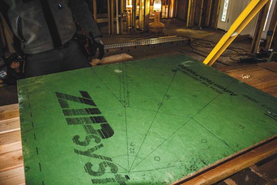

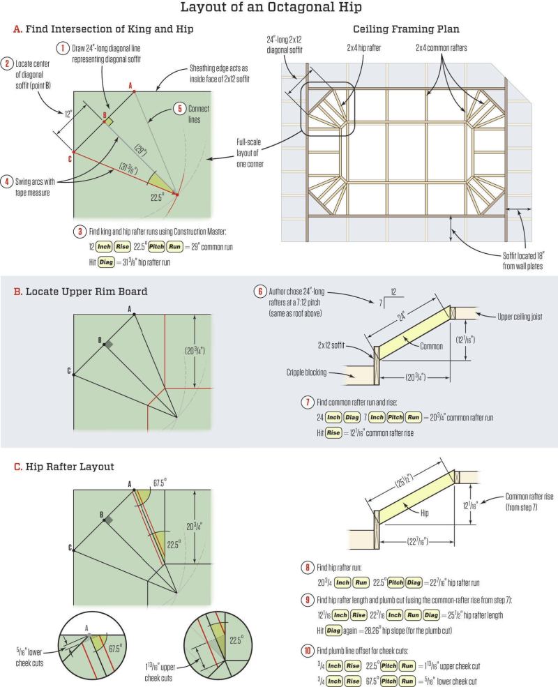

Full-scale drawing. I like to grab a piece of sheathing and lay out one corner of the ceiling at full scale, so I can write down the numbers I need for all my calculations.
The author likes to use a piece of sheathing to lay out one corner of the ceiling at full scale, then write down the numbers needed for all of his subsequent calculations.
I do all the layout on this piece of sheathing, using its edges as the inside face of the 2x12 soffit, and drawing a diagonal across the corner to define the 67.5° corners where the hips will be nailed. A regular hip splits a 90° corner (making 45° angles); an octagonal hip then splits the 45° angle, making 22.5° angles between the hip and the commons on either side of it.
I start the layout by finding dead center of the diagonal corners of the soffit (12 inches on this particular ceiling). Drawing "A" shows the calculations that I make using my Construction Master calculator to lay out a full-scale section of one corner.
Upper ceiling plane. Once this section is drawn, I draw where my upper ceiling line will be. I like to work in round numbers, so for this size room I chose a 24-inch-long rafter at the same 7:12 pitch as the roof above. (To draw attention to the ceiling in a larger room, I might use a 36-inch-long rafter and steepen the pitch, but in this small room, that wasn't necessary.) Drawing "B" shows the layout and calculations needed to draw the upper ceiling line on the full-scale drawing.
Hip-rafter layout. Next, I lay out the hip rafter, as shown in drawing "C" . This allows me to draw the actual thickness of the hip (2-by) and the common, so I can just measure off my adjustments to get my cheek cuts laid out, as shown in the illustration above.

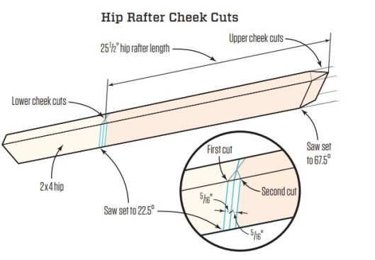

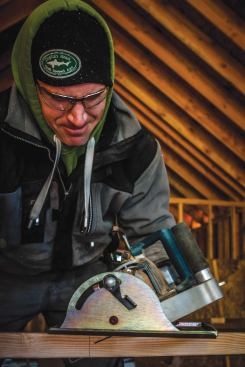

Cutting rafters. I can now cut eight hips (two per corner) and all the commons. To cut the hips, I use the Big Foot 10-inch saw with a swing table. This base plate will bevel to 75°, so it can handle the 67.5° bevels needed for the upper hip cheek cuts.

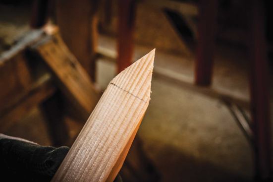

The author cuts the steep cheek cuts first (left photo). Then he pulls the length and layout, and makes the lower cheek cuts (above).
28.26° hip slope (for the plumb cut).
Tim Healey 28.26° hip slope (for the plumb cut).
I like to cut the steep cheek cuts first, then pull the length and layout, and cut the lower cheek cuts. For the lower cuts, I square the length to the side of the rafter and draw a plumb line. Then I measure the setbacks (5/16 inch) on both sides of this first plumb line, giving me three parallel plumb lines. I cut on the "long" line first, with the blade angled back toward the rafter; then I cut the "short" line from the other direction, giving me the double cheek cut.

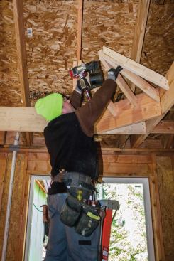

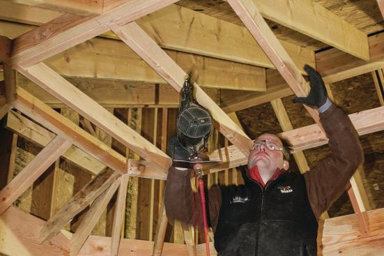

After making the cuts, the author begins the framing in the corners, installing the two commons and one hip (left photo). Then he fills in the common rafter framing (above).
I like to frame all my corners (two commons and one hip), then fill in the common rafter framing. Once that is finished, I measure in the upper ceiling framing and nail it off, making sure it's strong enough to hang from and that there will be no ceiling joists in the way of the light placement.
