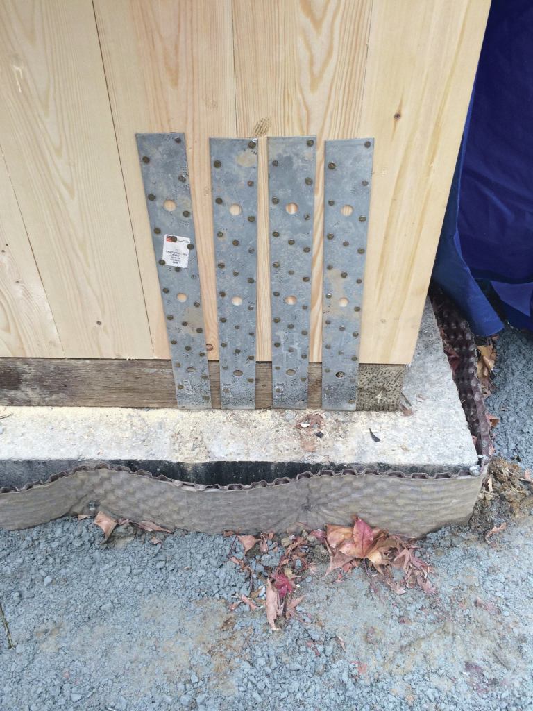

The sill plate dimensions needed to be spot on, as panels can’t be altered much. Metal hold-down straps anchored the panel to the plate.

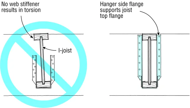

I-Joist Hanger Height
Hangers for wood I-joists should be tall enough to catch the I-joist’s top flange unless a web stiffener is used; otherwise, the joist may roll in the hanger (I-Joist Hanger Height, below). If a web stiffener is used, the hanger side flange should be at least 60% of the joist depth.
Joist hangers must be the full height of the I-joist (right), unless web stiffeners are used. Otherwise the joist may twist (left).

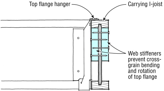

Web Stiffeners
For I-joist to I-joist connections, install web stiffeners against the bottom of the top flange of the carrying joist (Hangers on I-Joists, above).

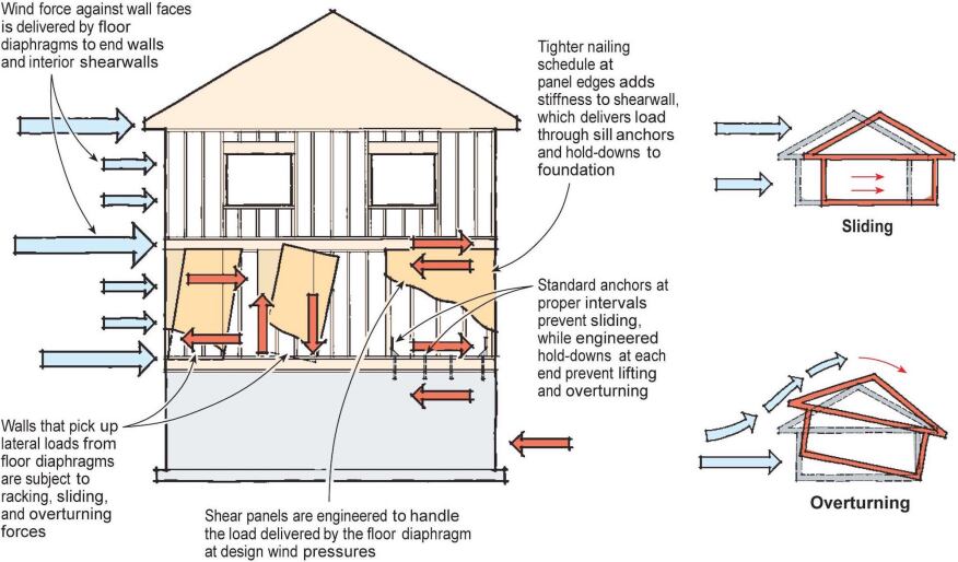

When wind pushes a house or an earthquake shakes it, the force is delivered to the top of the shear wall. At the bottom, where the wall is attached, there is an equal resisting force in the opposite direction. The “overturning moment” (a moment is a force times a distance) equals the force at the top of the wall times the height of the wall.
In a shear-wall assembly, the resisting force is provided by the hold-downs that achor a “tension post” on one side of the shear assembly, and a “compression post” on the other side. For the shear wall to work, hold-downs must be correctly sized to handle the tension force generated. They must also be installed correctly so they can adequately transfer the forces to other parts of the building.

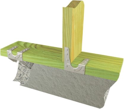

Misplaced Anchor Bolts
In seismic regions, codes typically require that foundation bolts have 3-inch-square bearing plates instead of washers. An incorrectly placed bolt can cause the bearing plate to extend beyond the edge of the sill or to conflict with the framing, as shown to the left.
Do not notch the stud. Instead, use a slotted plate, such as the one shown in the photo to the left, which can be offset to accommodate an anchor bolt near a stud.
Another way to reduce framing conflicts is to use strap anchors instead of bolts.
