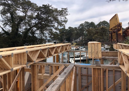

The rigidity that gives that “solid” feel to a floor is certainly the top reason we like to use open-web floor trusses, but there are two other key advantages: namely, the ease of installing ducts through the open webs and the overall ease of rough-ins for other trades.

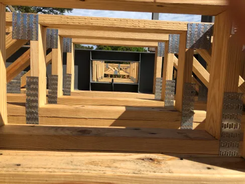

Being able to run ducts through the webbing is especially welcome. Working on projects where the space allowed for mechanical systems is small to nonexistent can be frustrating, and building out chases and other workarounds to integrate the ductwork into such a floor system becomes very time consuming.
Running HVAC ducts in the open webs of floor trusses offers a distinct advantage. On this job, the truss layout was coordinated with prefabbed openings in the steel girders.
Openings for ductwork were designed into the trusses to align with openings in the steel girders.

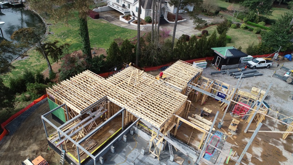

When defining the duct pathways through the trusses, we can send an initial truss design to our mechanical contractor (or mechanical engineer, if the project allows) for consideration when designing the duct layout, or we can get the duct layout first and include it when we submit our plans to the truss designer. We find the latter usually works best because the truss maker can then accommodate the duct layout into the truss design. Inevitably, we end up with compromises or field changes to trusses when the mechanical design follows the truss design.

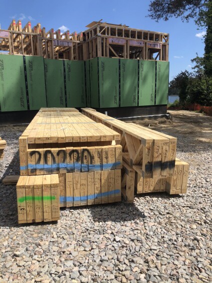

The joists will arrive on a flat bed and be set down on the site like a typical lumber package. We’ve found it’s important to stage the package with the joists accessible to the framers in the order they will be installed. Another critical detail is to make sure the joists are lifted up onto the walls oriented in the right direction. With large projects, we will sometimes paint the joist ends that face out. We have found that joists can be banded together for different areas, and painting the ends with different colors makes it easy to see at a glance which joists will go in the same location.
Floor-joist bundles are color-coded after the lumber drop.
This ensures the correct bundles are lifted to the right locations on the frame.

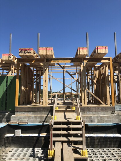

We will also mark the tops of walls where ducts will pass to make sure joists are not placed there. If we don’t do this, joists may start to be set before we discover that the duct paths that were so carefully designed don’t line up from joist to joist.

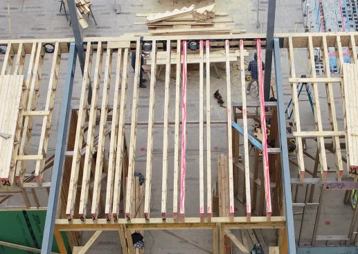

A couple of other cool features that have been designed into some of our open-web truss packages are zero-entry shower floors and “shade pockets” for roll-down window treatments. With zero-entry showers, the trusses are designed to step down, typically about 2 inches—more than enough to create the necessary slope. In some cases, the step-down can even be in the middle of a joist span. With details like this, of course, it’s paramount that they be defined prior to making the trusses.
To ensure that the framers stay aware of the duct layout, the author painted the top of wall plates blue to define duct pathways.
At an area where trusses drop for a curbless shower, the author painted the top chords hot pink so framers stayed aware of the small change in elevation.

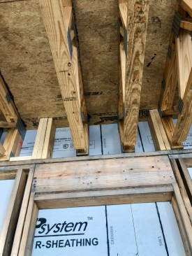

To avoid making changes in the field, I highly recommend planning for all the “immovable,” or must-have, objects that may land in the floor or ceiling. The truss designers are good about designing the layouts around toilet locations, for example. Along these lines, another big item we like to plan for early are can lights. This might not make sense for every builder but, for us, it’s critical to be thinking through at least some of the general lighting locations. We’d hate to have to tell a client something like, “Sorry, but you can’t have a can light there for your artwork; there’s a joist in the way that we can’t move.” In hallways, especially with the 3 1/2-inch width of the trusses, you need to work off the centerlines.
When defining the joist layout, the author’s team works off the centerlines of headers and hallways to ensure there’s room for can lights.
Where the gussets of overlapping joists touch, the crew inserts sill-seal foam to prevent squeaks.

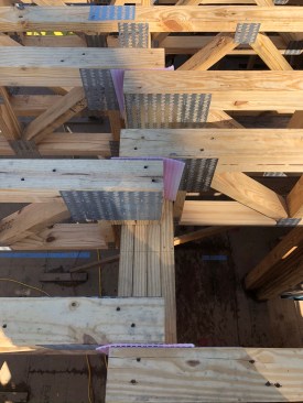

One other fine detail concerns joists that lap each other on a wall or girder. We add a piece of foam sill-seal between the overlapping joists to make sure there is no chance of a squeak from metal gussets touching each other. This may be an unlikely scenario but, if it should ever happen, it would prove extremely difficult to remedy after the framing has been closed in.
