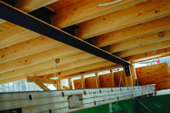

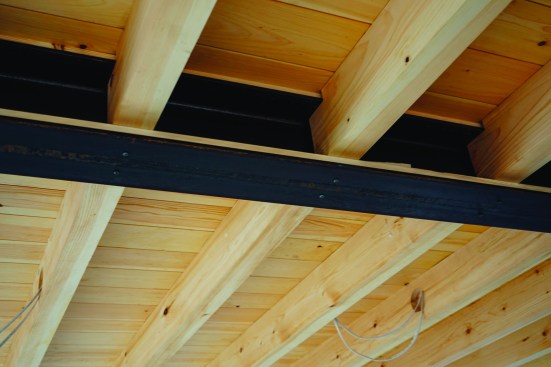

The basement room will get a polished concrete floor. Overhead, its ceiling is exposed wood: tongue-and-groove 1x6 pine boards laid over sawn 3x8 pine joists, supported by a flush steel beam. It’s Sokol’s trademark style, and Kruse has built it before.
Sokol likes the rugged look of the exposed steel beam and sawn rafters. Beyond that, building height restrictions constrained the head height in the lower-floor room, and the exposed beams add a feeling of greater height to the ceiling.
Regardless of the aesthetic considerations, said engineer Putnam, the stiffness of steel made the I-beam the only practical choice to support the ends of the sawn joists and allow a clear span across the room. Engineered lumber could have carried the load but would have required too deep a member. “The stiffness of steel (its modulus of elasticity) is 29,” said Putnam. “The stiffness of LVL is 2. An LVL that would carry the load would have had to be 16 inches deep or more, not 8. You couldn’t make it flush to the ceiling.”

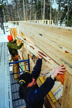

After nailing down tongue-and-groove ceiling boards topped by AdvanTech subflooring, the crew locked the joists in from below with pan-head screws.
“Rusty routed out the wiring chases in the tops of the beams and the holes for the electrical boxes to sit inside the beams,” said Kruse. Sokol had also specified exact locations for screw holes in the lower flange of the steel member for fastening the sawn joists, said Kruse. “So they drilled those holes at the steel shop, and then Rusty went down to the shop and cleaned up the steel beams and coated them with beeswax. And he brought them up to the site, and he brought his Bobcat with a boom to set the steel beams.”
The sawn joists rest on a ledger of 3/4-inch pine set on the lower flange of the I-beam. Kruse’s crew pinned that ledger in place with short temporary screws, then set the sawn beams in place by hand based on Sokol’s layout. Then, after the pine ceiling and upper-story subfloor were in place, the crew backed out the small screws and replaced them with long pan-head screws extending into the sawn timbers. “We wanted the screws to look good with the steel beam, so we took a torch and burned the coating off the heads to expose the metal,” said Kruse.

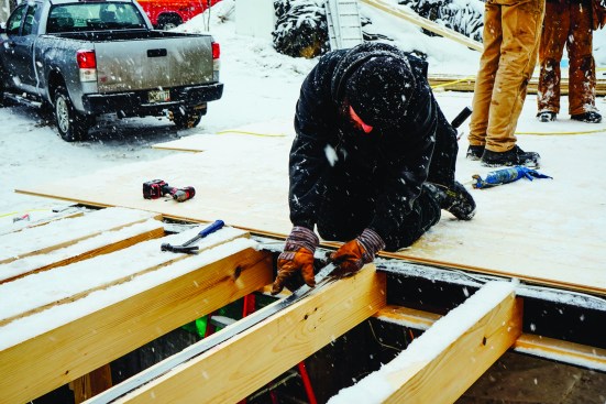

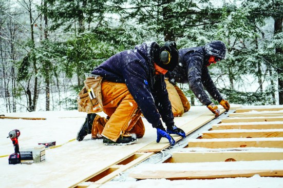

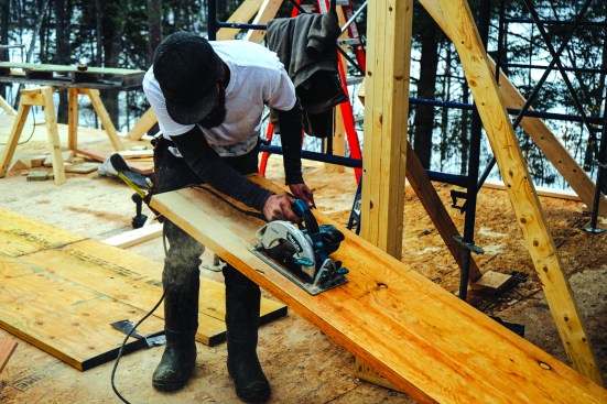

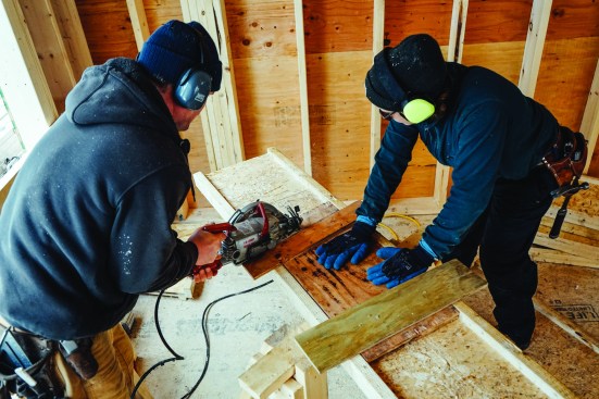

The design called for building the lower story’s ceiling into the upper story’s subfloor. This required Kruse’s crew to glue and nail the pine boards to the wood timbers. At the same time, the crew had to install and protect the rough wiring for the lower room’s ceiling lighting fixtures. Working from both sides of the steel beam, the carpenters laid out their starting courses for the tongue-and-groove pine so that the edges of the final courses would fall short of the center of the steel beam, leaving access to wiring runs on top of the steel. To protect runs of wiring set into the channels along the tops of the sawn joists, the crew laid strips of steel into the grooves before nailing down the pine boards.
Working in a light snowstorm, the crew glued and nailed tongue-and-groove pine boards to the sawn beam framing.

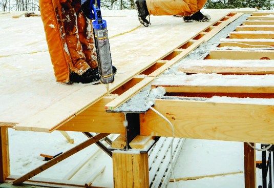

They took care to leave space for wiring that serves light fixtures in the room below.
The wiring chases were capped with steel to protect the wires.

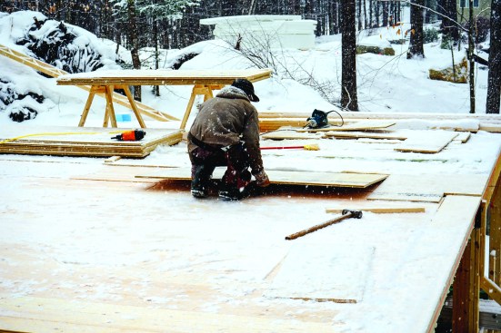

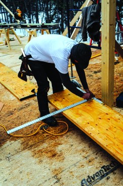

Then the crew covered the whole layer of boards with a top course of AdvanTech subflooring.
After all the boards were in place, the crew glued and nailed 7/8-inch AdvanTech subflooring panels over the pine, taking care to nail only into the beams. They snapped chalk lines on the subflooring to mark the edges of all the beams that housed wiring runs, and used screws to fasten down the AdvanTech at those locations, to remove the risk of a nail near the edge going astray and either hitting a wire or shining out on the ceiling below.

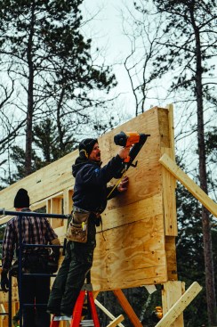

Then they nailed plywood sheathing onto the face of the wall to stiffen the structure.

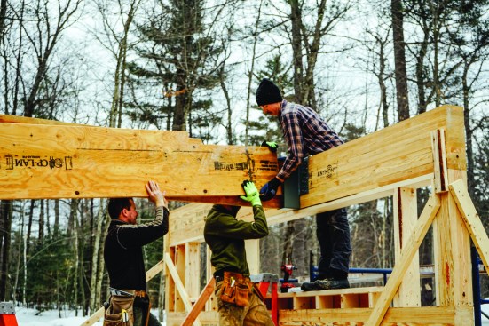

“So we said, ‘Let’s go with the solid piece,’” said Kruse. “If it had been up high like the other beam, we might have had to use LVLs and bolt it together. But with that lower one, it wasn’t too hard to lift the glulam up. We lifted one end up onto the scaffolding, and then the other end, very carefully. We were seven guys doing it, and it was manageable.”
The front wall actually has two glulams: one above the window to support the flat roof of the center of the house, and one below the window to support an entryway and garage roof. Before attaching the huge Simpson hanger to the face of the top glulam, the crew framed in the window opening between the two glulams and sheathed the wall to stiffen it (see photos, facing page).
Engineered LVL material lets carpenters assemble high-capacity beams on site, using manageable pieces with uniform strength characteristics. Carpenter Matt Friel helped carry 28-foot pieces onto the home’s floor deck.

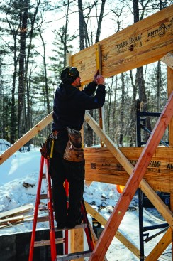

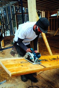

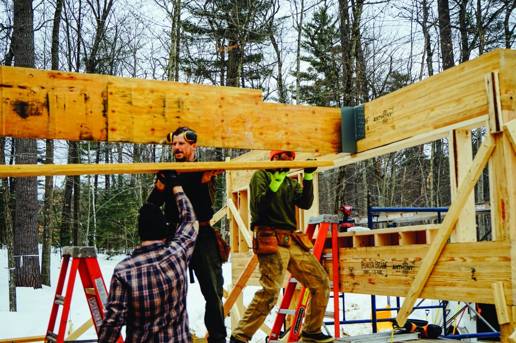

With the glulam header wall in place, the crew set about cutting and assembling the big LVL beam that would tie into it. Although the LVL plies were 28 feet long and 20 inches wide, two carpenters could wrestle the pieces off the lumber pile and move them around to the deck for cutting to length.

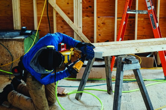

At just 1 3/4 inches thick, the LVL plies were a convenient size for cutting and fastening with ordinary framing tools. To cut the beams to length, lead carpenter Matt Friel took his measurements from Sokol’s plans and checked them against the actual measurement from the post he had just set at the back of the house that would hold up the far end of the beam. Then he measured and marked each ply, using a 4-foot drywall square to mark his lines.
Making things even more interesting, Sokol’s design oriented the home’s two wings at a 10-degree angle to each other (part of fitting the building to the property’s tightly constrained buildable area). So the site-built LVL beam, which would help carry roof loads for one shed-roofed wing and the flat-roofed center section, would need to join its supporting glulam at the same 10-degree angle.

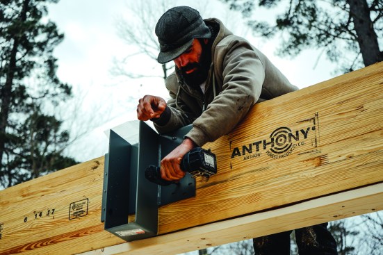

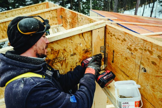

For $450, Simpson Strong-Tie supplied an EGQ high-capacity beam hanger fabricated at the required angle (the EGQ can be sloped and skewed as much as 45 degrees, according to Simpson). It was up to the carpenters, though, to make the correct angle on the beam end. Friel had to start with the longest angle cut, then subtract a fraction for each cut on the next two pieces of LVL.
Cut lines were marked with a 4-foot square.
Then the pieces were cut to length at the architect-specified 10-degree angle.

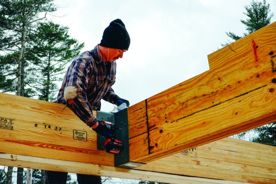

Matt Friel attached the Simpson beam hanger in position with Simpson SDS screws.
He laid out and cut a notch on the end of the beam to match the framing of the flat-roofed section at the front of the house.
Friel set the big Simpson hanger in position using the supplied Strong-Drive SDS structural screws, taking care to put a screw in each hole. Next, he cut down the end of each LVL beam ply to 16 inches deep. Then it was time to assemble the beam; the crew lifted the long pieces into place one by one, screwing them together along their length with structural screws, and finally screwing the completed beam into its hanger with the Simpson-supplied fasteners.

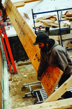

Then the crew muscled the LVL pieces into place one by one.
Once in place, the beam is secured to the hanger with screws.

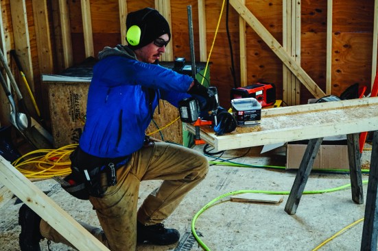

The upper-story living-dining-kitchen area is designed as a single open-plan space with a high ceiling. Eventually, this room will get the same ceiling treatment as downstairs, with sawn wood rafters and a center-span steel beam. The sawn rafters won’t be structural (they’re for looks only), but the steel beam at mid-span will be real; it will help support the wood I-joist shed roof.

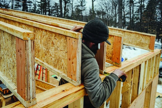

Without the mid-span steel beam, engineer Putnam told JLC, the 16-inch-deep wood I-joists might struggle to make the room’s 28-foot span. “The snow load at that location is about 70 pounds per square foot,” Putnam remarked. “You can expect 3 feet of snow in winter.” With the steel beam cutting the span in half, however, the wood I-joists are comfortably oversized. “The rafter depth is just there for insulation thickness,” said Putnam.
Jesper Kruse and carpenter Anna Heath made rafter plumb cuts using a site-built jig.

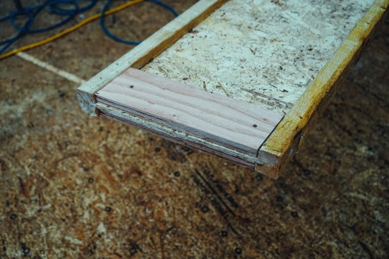

Carpenter Ryan Bielenda packed out each rafter web with plywood stiffeners.

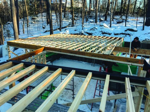

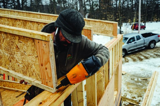

Kruse planned to insert the steel beam later. For now, the crew just needed to set the long wood I-joist rafters. They started by cutting the pieces to length, using a site-built jig that guides the circular saw at the correct angle and allows the saw to ride across the rafter’s web without falling in. “It makes it easy,” said Kruse. “You just line the jig up in the right place, and it’s one nice cut across.”
Then he pre-applied Simpson adjustable wood I-joist hangers, which can be adjusted in the field to the necessary angle for a sloped or skewed connection.
Then the crew packed each rafter out with plywood web stiffeners. These help transfer loads from the top flange of the member down through the web, and they also provide nailing for metal connectors. Before passing the rafters up to carpenters at the wall plates, the crew on the deck attached metal connectors to the rafter ends.

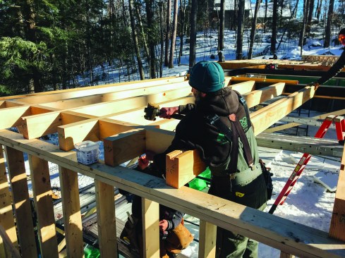

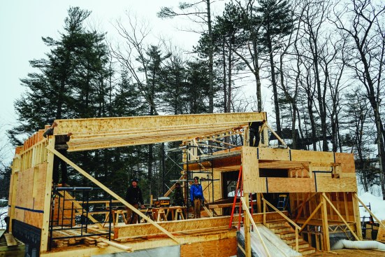

The crew had angled the top cuts on the studs for the wall that supports the lower end of this long roof span, creating a beveled top plate for the wall, so that the wood I-joists could sit flat on the plate. At the top, where the rafters dead-end into the LVL rim joist (which is also the window header), the wood I-joists were fastened using angled Simpson LSSUI joist hangers.
The roof assembly includes load-bearing LVL rim joists that span over windows in the end walls. Matt Friel measured from the edge of the beveled bottom plate to allow room for the LVL.
The rafters were nailed into place.
“I like the way Eric used the LVL band joists to do the work of the window header in a bunch of places,” said Kruse. The crew did have to take care that rafter ends falling above window openings were attached with load-bearing metal connectors. But the method saved labor and reduced the amount of thermal bridging in the wall. “When we use engineered wood band joists at the floor perimeter in a two-story wall,” Kruse said, “we like to hold the wood back from the edge of the plate and put some rigid foam in there for a thermal break. You just have to make sure your sheathing spans across the foam from the lower wall to the upper wall. But at the top of the roof like this, we would rather have solid lumber behind the plywood for attaching eave overhangs and trim.”
Alex Strugatskiy fastened the skewed connectors to the LVL at the top.
The building began to take shape.
