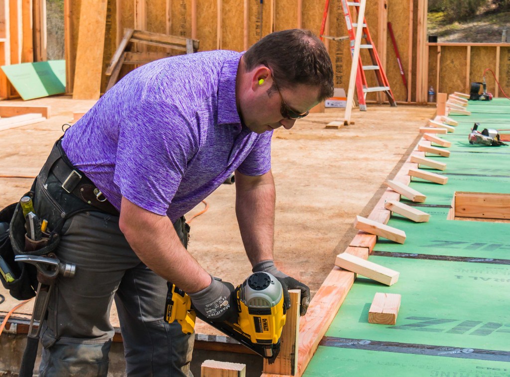

For toenails loaded in withdrawal, multiply the values in the Withdrawal Strength Design Values table, above, by .67. For toenails loaded laterally, multiply the values in the Lateral Strength table, above, by .83. Toenails should be driven at an angle of about 30 degrees from the face of the stud or other member being attached (below).
Place toenails away from the end of the board a distance that’s equal to one-third the length of the nail. Angle the nail so it comes through at the center of the board’s thickness. This angle is less than 45 degrees.
Tim Healey
Pneumatic Nails
Pneumatic nails are typically sold by a specified shank diameter in inches (.120, .131, and .148 are common for framing nails). These are typically skinnier than common nails of equal length and, therefore, have lower lateral strength and withdrawal values (below). Consult manufacturers for lateral strength of specific nail types.
