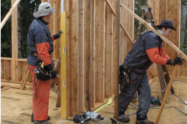

It does no good to carefully lay out and snap lines for plates if you don’t pay equal attention to plumbing and aligning the walls. Like many carpenters, I learned this the hard way. In the past, we’ve been forced to adjust the lengths of rafters, taper the drywall at ceiling corners, and even struggle to hang doors straight and trim them evenly — all because of poorly plumbed and aligned walls. Now we take the time to plumb and align the walls properly to ensure that the top plates end up directly above the bottom plates. It takes our three-man crew about 30 minutes to plumb, straighten, and brace all the walls on an average 1,200-square-foot floor of a house. On the following pages, I’ll describe our method.
Simple Tools, Basic Materials
It takes only a few basic tools to plumb and straighten walls — mainly a good level and some nylon dry lines. We like Stabila’s Plate Level (800/869-7460, www.stabila.com) because it can be extended the height of the wall and its offset design doesn’t get thrown off by bumps and bows in the studs. And we recently started using a PLS5 point-to-point laser (800/601-4500, www.plslaser.com), which lets the operator know the wall is plumb when both the down beam and the up beam hit the edges of the plates. I also use a 3-foot stepladder; although two of the guys on my crew are tall enough to reach 8 or 9 feet up with a nail gun, I’m not so fortunate.
Finally, we order 2×4 material for bracing. The braces should run at a 45-degree angle, so for 8- and 9-foot walls we use 12-footers.

Next we stretch our dry lines to gauge the straightness of the wall. Many framers I know stretch the string between 2×4 blocks nailed to the inside edge of the plates, which allows them to use a 2-by block to gauge the space between the plate and the line. We prefer to put the string 1/2 inch above the plates and in line with the inside edge. Then we stand under the wall and sight up the inside edge of the plates to see where they are in relation to the line, which is faster than using a gauge block.
Because we always cull the best plate stock, straightening the walls is fairly easy. The plate is either good where it is or has to come in or go out. It’s unusual for our plates to be more than 1/2 inch out of parallel with the dry line.
If we like the plate where it is, we’ll go ahead and nail diagonal braces between the deck and plate to hold it in place. Generally we start bracing at one end of the wall and work our way toward the other end. But if there’s a really big bow somewhere, that’s where we’ll start. It goes without saying that it’s next to impossible to straighten a bowed header, so we’re also careful to reserve the straightest stock for long headers.
Spring braces. We typically use spring braces to push the plates out or pull them in. If the top has to go out, we nail the 2×4 brace on the flat against the plates, sit against the middle to “shorten” it by springing it down, and then nail the bottom to the floor. We try to hit a joist; if we can’t, we nail the bottom of the brace to a cleat that does.
When we get up off the brace, it springs back and pushes the wall out — usually too far, which is exactly what we want. We then take a 4-foot 2×4 scrap and wedge it between the bottom of the flat brace and the deck. This shortens the brace and pulls in the top of the wall. We wedge the 2×4 scrap in as tightly as needed to bring the top plate in line with the string, then nail it off.
We also use spring braces to pull walls in. The only difference is we don’t sit on the spring brace when we first nail it in. If the wall proves really hard to move in, we’ll pull it slightly farther than necessary, knowing it will probably creep back out a bit.
