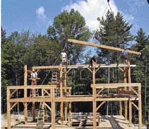

Raising a Frame
We start by assembling the bent (a vertical section of the frame) farthest away from the truck. A bent commonly includes the first-floor posts, a tie beam that carries the second-floor joists, the second-floor posts, and the rafters.
A bent commonly includes every member from the first-floor posts to the rafters. Connecting girts run perpendicular between bents.
We rarely assemble the whole thing at once, as it would be too big and unwieldy. More often, we start with the first-floor posts and the second-floor beams.

We lift and guide the bent into position with the crane, and then we brace it with dimensional lumber.
Once we have craned the second bent into position, we use come-alongs to spread the bents so we can drop the connecting beams — called girts — between them.
A pair of bents has been raised and braced.
The crew uses come-alongs and the crane to cautiously spread the bents, coax the tenoned girts into their mortises.
Then pull the bents back together.
