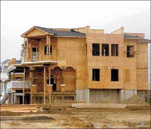

Wall bracing is one of the critical elements of a wood-framed structure, providing resistance to forces that act along the wall plane. In storm-prone coastal areas especially, braced walls help the whole house resist lateral wind forces.
The higher those lateral wind loads are, the stronger the structure must be. That’s why in the zones closest to the coast, where design wind speeds exceed 100 or 110 mph, building codes require new homes to have an engineered design. The design process involves calculating the anticipated wind loads based on the given building’s location, exposure, and dimensions, and then specifying appropriate assemblies to resist those loads. For wood-framed houses, the resulting design ordinarily includes shear walls built using closely nailed structural panel sheathing and rugged hold-downs.
