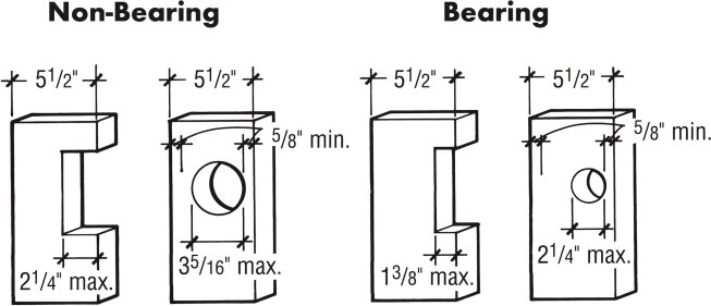

Notching and Boring Studs and Plates
Studs
When notching or drilling through studs under 10 ft. tall, follow the guidelines shown below.
Notches in loadbearing studs under 10-ft.-tall should not exceed 25% of the stud depth. Bored holes should not exceed 40% of the stud width and should be at least 5/8 in. from the edge.
Never make notches and holes across from one another in the same section of a stud. For studs over 10 ft. in height, follow guidelines shown below.
Certain restrictions may apply to drilling holes and cutting notches in tall engineered studs. Whenever using engineered lumber, consult the manufacturer’s specs for design values, load tables, and nailing requirements.
Plates
If more than 50% of the width of a top plate is notched or drilled away, then the edge of the plate must be reinforced with a 16-gauge plate at least 1.5″ high and extending at least 6″ beyond the notch on both sides.
